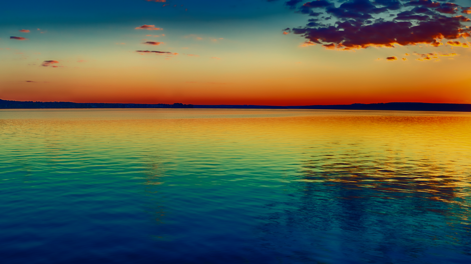

Classic Sabattier — simulated result across source images.

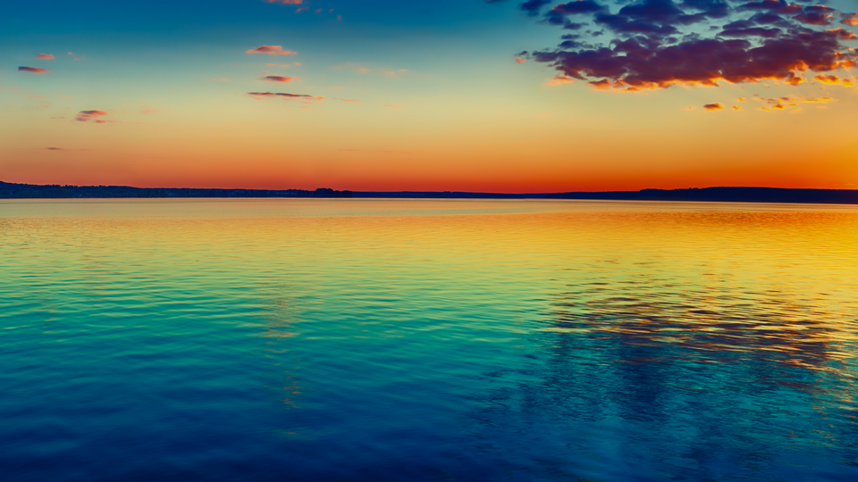

Mackie Line Portraits — simulated result across source images.

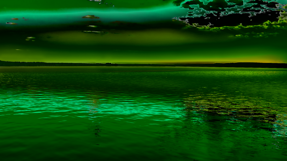

Equidensity Contour Map — simulated result across source images.
