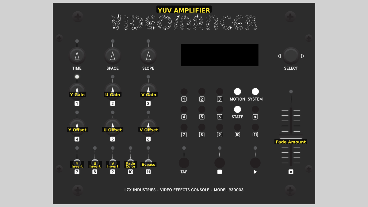

Parameters
Videomancer's front panel with YUV Amplifier active. Knobs 1–6 (top two rows of left cluster), Toggle switches 7–11 (bottom row of left cluster), Fader 12 (right side).
Knob 1 — Y Gain
| Property | Value |
| Range | 0.0% – 200.0% |
| Default | 100.1% |
Y Gain controls the contrast of the luminance channel. It maps to the contrast input of the Y proc amp. At 0%, fully counterclockwise, all luminance detail is crushed to the offset value: the image becomes a flat field. At the default position of 100%, the signal passes with unity gain. Turning clockwise toward 200% doubles the contrast, pushing midtones apart and driving highlights and shadows toward their extremes. High gain values can clip the signal, producing hard white and black regions.
Gain is applied as multiplication around the midpoint (512). Values above midpoint are pushed higher; values below are pushed lower. The formula is: `(input − 512) × gain / 512 + offset`.Knob 2 — U Gain
| Property | Value |
| Default | 100.1% |
U Gain controls the contrast of the blue-difference chrominance channel. At 0%, the U channel collapses to its offset value, removing all blue-yellow color variation. At the default of 100%, the original color balance is preserved. Increasing toward 200% boosts blue-yellow saturation, making blues more vivid and yellows more intense. Because U and V are independent, you can boost blue saturation without affecting red-green tones.
Knob 3 — V Gain
| Property | Value |
| Default | 100.1% |
V Gain controls the contrast of the red-difference chrominance channel. It behaves identically to U Gain but operates on the red-green axis. At 0%, red-green color differences vanish. At 100%, the image is unchanged. At 200%, reds and cyans become intensely saturated. Reducing V Gain while keeping U Gain high shifts the palette toward blue and yellow, suppressing reds and greens.
Setting both **U Gain** and **V Gain** to 0% while keeping **Y Gain** at 100% produces a clean monochrome image (all color is removed, leaving only luminance.)Knob 4 — Y Offset
| Property | Value |
| Range | -100.0% – 100.0% |
| Default | 0.1% |
Y Offset shifts the overall brightness of the luminance channel. It maps to the brightness input of the Y proc amp. At the default of 0%, no offset is applied. Turning counterclockwise toward −100% darkens the entire image. Turning clockwise toward +100% brightens the entire image. Unlike gain, offset shifts all values uniformly: darks and lights move together. Combined with high Y Gain, offset can reposition the tonal range to expose shadow detail or recover highlights.
Knob 5 — U Offset
| Property | Value |
| Default | 0.1% |
U Offset shifts the blue-difference chrominance channel. At the default of 0%, the color balance is neutral. Positive values push the image toward blue; negative values push it toward yellow. This is a global color temperature adjustment on the blue-yellow axis. Small offsets produce subtle warming or cooling effects; large offsets create strong color casts.
Knob 6 — V Offset
| Property | Value |
| Default | 0.1% |
V Offset shifts the red-difference chrominance channel. At the default of 0%, the color balance is neutral. Positive values push the image toward red and magenta; negative values push it toward green and cyan. Combined with U Offset, you can target any hue: positive U and positive V yields magenta, negative U and positive V yields red, and so on.
Adjusting **U Offset** and **V Offset** together is equivalent to a ***white balance*** correction. Small shifts can compensate for the color temperature of a light source, matching the look between different cameras or scenes.Switch 7 — Y Invert
| Property | Value |
| Off | Off |
| On | On |
| Default | Off |
Y Invert flips the luminance channel by applying a bitwise complement. When set to On, every pixel's brightness is reversed: black becomes white and white becomes black, producing a photographic negative effect on the luminance. Inversion is the first processing step: it happens before gain and offset are applied, so all downstream processing operates on the inverted signal. This means Y Gain and Y Offset will amplify and shift the inverted values.
Switch 8 — U Invert
| Property | Value |
| Off | Off |
| On | On |
| Default | Off |
U Invert flips the blue-difference chrominance channel. When set to On, blue tones become yellow and yellow tones become blue. Like Y Invert, this occurs before the U proc amp, so U Gain and U Offset operate on the inverted signal. Combining U Invert with V Invert produces a full chroma inversion (all hues rotate by 180 degrees on the color wheel.)
Switch 9 — V Invert
| Property | Value |
| Off | Off |
| On | On |
| Default | Off |
V Invert flips the red-difference chrominance channel. When set to On, red tones become cyan and cyan tones become red. This is the complement operation on the red-green axis. Enabling V Invert alone creates a color-shifted palette where warm tones become cool and cool tones become warm, while blue-yellow relationships remain unchanged.
Switch 10 — Fade Color
| Property | Value |
| Off | Black |
| On | White |
| Default | Black |
Fade Color selects whether the fade target is black or white. When set to Black, reducing Fade Amount blends the Y channel toward zero (black) and the U and V channels toward neutral. When set to White, reducing Fade Amount blends the Y channel toward maximum (white) while U and V still fade toward neutral. In both cases, chrominance fades to gray (only the luminance target changes.)
Because U and V always fade toward 512 (neutral gray), a full fade to black produces a true black frame, while a full fade to white produces a clean white frame. Neither introduces a color cast at full fade.Switch 11 — Bypass
| Property | Value |
| Off | Off |
| On | On |
| Default | Off |
Bypass routes the unprocessed input signal directly to the output, skipping all gain, offset, inversion, and fade processing. Sync timing is still aligned through the delay pipeline, so switching Bypass on and off does not cause a glitch or sync disruption. Use Bypass for instant A/B comparison between the raw input and your processed result.
Fader 12 — Fade Amount
| Property | Value |
| Range | 0.0% – 100.0% |
| Default | 100.0% |
Fade Amount controls the blend between the processed signal and the fade target color. At the default of 100%, fully up, the processed signal passes through with no fading. As you pull the fader toward 0%, the image progressively dissolves into the color selected by Fade Color. At 0%, the processed signal is completely replaced by the fade target (a solid black or white frame.)
**Fade Amount** is a ***wet/dry mix*** for the entire program. Use it as a performance control to smoothly blend between your processed look and a solid color, or to dial back the intensity of extreme gain and offset settings without changing them individually.Background
