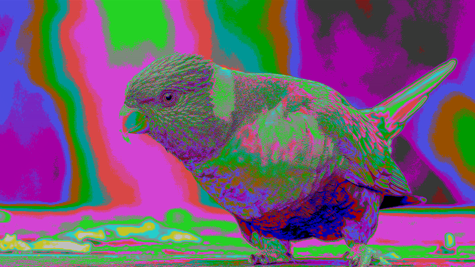

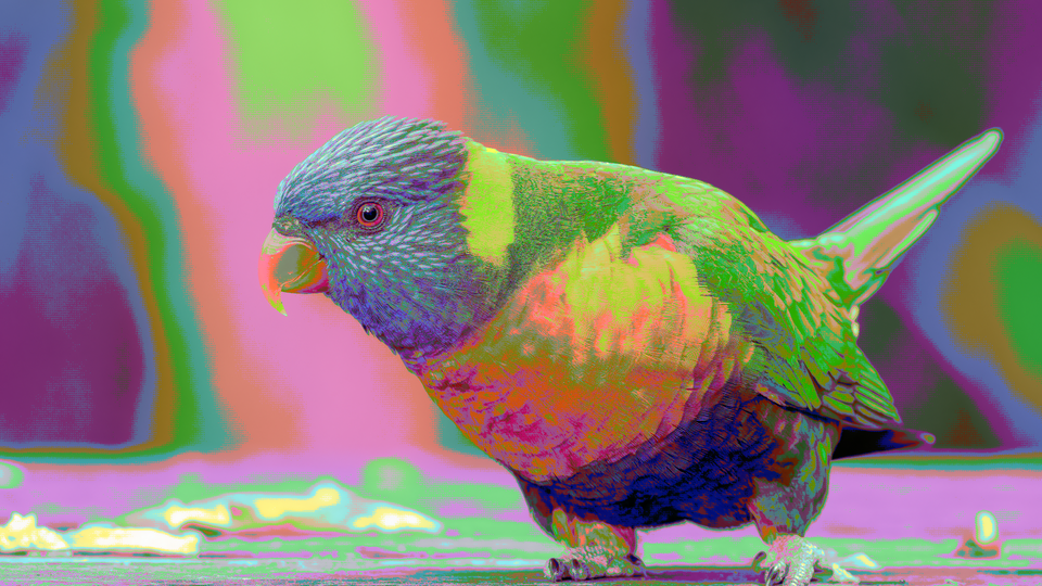

Exercise 3: CRT Television Emulation
CRT Television Emulation — simulated result across source images.
Exercise Illustration
Learning Outcomes
Combine palette quantization with display emulation for a full retro broadcast look.
Key Concepts
- Pixel doubling and scanlines together simulate low-resolution CRT output
- Saturation control adjusts the vividness of palette colors beyond their historical values
- Mix allows blending the retro effect for subtlety
Video Source
Footage with bold colors and motion: cartoons, music performances, or colorful abstract video work well.
Steps
- Select palette: Set Palette (Knob 1) to position 6 (Amiga OCS) for a rich 16-color palette.
- Enable dithering: Set Dither Size to 4×4 and Dither Amt to about 50%.
- Boost color: Turn Saturation (Knob 6) fully clockwise for oversaturated, vivid palette colors.
- Display emulation: Enable both Pixel Dbl (Switch 7) and Scanlines (Switch 8).
- Fine tune: Adjust Contrast (Knob 5) to about 65% for punchy, saturated blocks. Adjust Brightness (Knob 4) to taste.
- Blend: Pull the Mix fader (Fader 12) to about 70% to let some of the original image bleed through the palette restriction. The result is a subtle retro color cast rather than hard quantization.
- Invert: Toggle Invert (Switch 10) to produce a negative-image version through the Amiga palette (an effect that has no historical equivalent.)
Settings
| Control | Value |
| Palette | 6 (Amiga OCS) |
| Dither Size | 2 (4×4) |
| Dither Amt | ~50% |
| Brightness | 50% |
| Contrast | ~65% |
| Saturation | 100% |
| Pixel Dbl | On |
| Scanlines | On |
| Dither Mode | Bayer |
| Invert | Off |
| Dith Phase | Off |
| Mix | ~70% |
