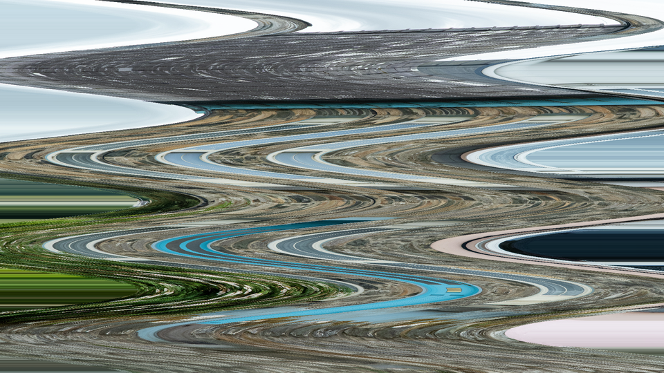

Elastica
Elastica applying sine-wave horizontal displacement to create rippling, Scanimate-style warp animation across the video frame.
Elastica is a per-scanline horizontal displacement engine inspired by the Scanimate, the legendary analog computer animation system of the 1970s. Its core trick is simple: each line of the image is shifted left or right by an amount determined by a programmable waveshape. The result is a fluid bowing, rippling, shearing, or stacking of the picture that feels organic and alive: the visual equivalent of dragging your fingers across wet ink.
Elastica generates its displacement pattern using a direct digital synthesis (DDS) phase accumulator that advances once per scanline. Four waveshapes: sine, triangle, sawtooth, and square: create different flavors of distortion. A second DDS handles vertical squeeze and stretch, and the two generators can be cross-modulated for complex two-dimensional warping. When animation is enabled, the phase scrolls continuously, recreating the signature Scanimate "ripple crawl" that made the original hardware so mesmerizing.
Start with a sine wave and low amplitude. Even subtle displacement transforms static video into something that seems to breathe.What's In a Name?
The name Elastica evokes the mathematical concept of the elastica curve: the shape a flexible rod takes when bent. It also carries a direct, tactile meaning: the image becomes elastic, stretching and compressing as if printed on a rubber sheet. The Scanimate connection adds a layer of history: Elastica brings the spirit of analog computer animation into a modern FPGA pipeline.

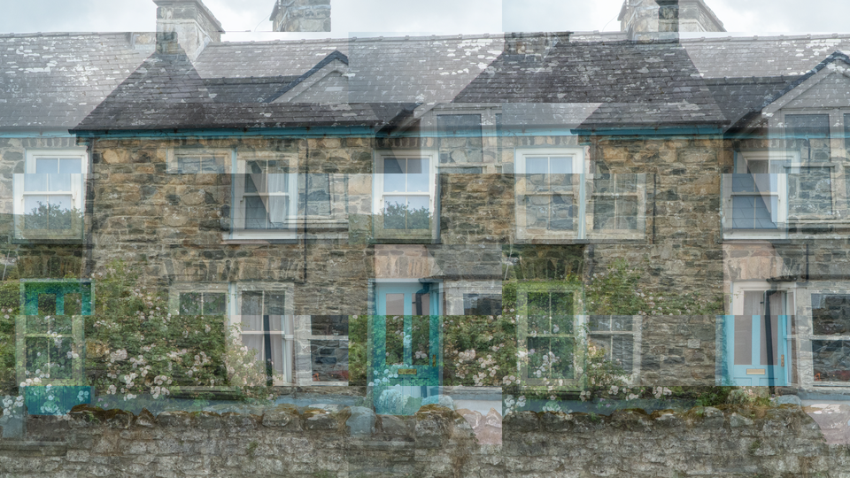

Switch 10 — Edge Mode
| Property | Value |
| Off | Clamp |
| On | Wrap |
| Default | Clamp |
Edge Mode selects how out-of-range displaced pixels are handled. In Clamp mode, pixels pushed beyond the active line boundaries are replaced with black, creating dark margins at the edges of the warp. In Wrap mode, the read address wraps around modularly, so pixels pushed off one edge reappear at the other. Wrap mode produces a seamless, tiling distortion with no black borders.

Exercise 1: Classic Scanimate Ripple
Classic Scanimate Ripple — simulated result across source images.
Exercise Illustration
Learning Outcomes
Recreate the signature horizontal ripple effect of the Scanimate analog animation system.
Key Concepts
- DDS phase accumulator generates periodic displacement
- Sine waveshape produces smooth, organic bowing
- Animation scrolls the displacement pattern over time
Video Source
A live camera feed or recorded footage with strong vertical lines or text.
Steps
- Initial displacement: Set H Amplitude (Knob 2) to about 40%. The image bows gently into a sine wave.
- Tune the ripple: Adjust H Frequency (Knob 1) until you see 3–4 complete wave cycles across the frame height.
- Start animation: Toggle Animate (Switch 11) to On. Set Anim Speed (Knob 6) to about 25%. The wave pattern crawls upward through the image.
- Deepen the warp: Slowly increase H Amplitude to see the distortion deepen. Notice how vertical lines in the source bend and flow.
- Compare waveshapes: Change waveshapes: set Wave Sel A (Switch 7) to On for triangle. Compare the sharper peaks with the smooth sine.
Settings
| Control | Value |
| H Frequency | ~40% |
| H Amplitude | ~40% |
| Cross-Mod | 0% |
| V Frequency | ~25% |
| V Amplitude | 0% |
| Anim Speed | ~25% |
| Wave Sel A | Off |
| Wave Sel B | Off |
| V-Warp | Off |
| Edge Mode | Clamp |
| Animate | On |
| Mix | 100% |

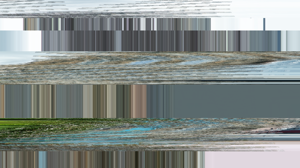

Exercise 2: Cross-Modulated 2D Warp
Cross-Modulated 2D Warp — simulated result across source images.
Learning Outcomes
Combine horizontal and vertical generators for complex two-dimensional warping.
Key Concepts
- Cross-modulation multiplies vertical wave into horizontal amplitude
- V-Warp adds line skipping for vertical squeeze/stretch
- Wrap edge mode eliminates black borders
Video Source
Footage with large geometric shapes or a test pattern with both vertical and horizontal lines.
Steps
- Sine baseline: Start from Exercise 1's sine ripple (H Amplitude ~40%, moderate frequency).
- Engage cross-mod: Increase Cross-Mod (Knob 3) to about 60%. The horizontal displacement becomes stronger in some vertical regions and weaker in others.
- Shape the zones: Adjust V Frequency (Knob 4) to change where the strong/weak zones fall. Low V Frequency creates broad zones; high V Frequency creates rapid alternation.
- Vertical compression: Enable V-Warp (Switch 9) and increase V Amplitude (Knob 5) to about 30%. Lines begin to skip, creating vertical compression banding.
- Seamless tiling: Switch Edge Mode (Switch 10) to Wrap. The black borders vanish, replaced by a seamlessly tiling distortion.
Settings
| Control | Value |
| H Frequency | ~35% |
| Cross-Mod | ~60% |
| V Frequency | ~30% |
| V Amplitude | ~30% |
| Anim Speed | ~20% |
| Wave Sel A | Off |
| Wave Sel B | Off |
| V-Warp | On |
| Edge Mode | Wrap |
| Animate | On |
| Mix | 100% |
Exercise 3: Waveshape Exploration
Waveshape Exploration — simulated result across source images.
Learning Outcomes
Compare all four waveshapes and discover how each transforms the image differently.
Key Concepts
- Four waveshapes: sine, triangle, sawtooth, square
- Waveshape selection is a 2-bit binary code (Wave Sel A + B)
- Each shape creates a fundamentally different distortion character
Video Source
A bold graphic or title card with strong horizontal text.
Steps
- Set the canvas: Set H Amplitude (Knob 2) to ~50% and H Frequency (Knob 1) to ~30%. Disable animation (Animate Switch 11 to Off).
- Sine wave: Both wave switches Off (Sine): observe the smooth, organic bowing. Text curves gracefully.
- Triangle peaks: Set Wave Sel A (Switch 7) to On (Triangle): the peaks sharpen. Bowing becomes angular, like zigzag folds.
- Sawtooth shear: Set Wave Sel A to Off, Wave Sel B (Switch 8) to On (Sawtooth): the distortion becomes asymmetric. One side of each bend is gradual, the other is abrupt.
- Square stacking: Set both switches On (Square): scanlines jump between two fixed offsets. The image splits into hard-edged horizontal bands that slide sideways like a shuffled deck of cards.
- Animate each shape: Enable Animate and sweep through Anim Speed with each waveshape to see how animation character changes.
Settings
| Control | Value |
| H Frequency | ~30% |
| H Amplitude | ~50% |
| Cross-Mod | 0% |
| V Amplitude | 0% |
| Anim Speed | ~25% |
| Wave Sel A | varies |
| Wave Sel B | varies |
| V-Warp | Off |
| Edge Mode | Clamp |
| Animate | Off |
| Mix | 100% |
