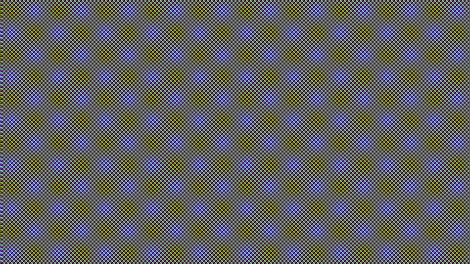

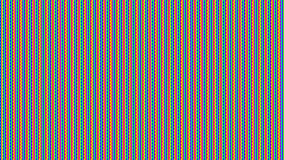

Exercise 1: Accumulator Grid
Accumulator Grid — simulated result across source images.
Exercise Illustration
Learning Outcomes
Learn how the H and V phase accumulators create spatial decimation patterns, and how locking affects stability.
Key Concepts
- Phase accumulators produce periodic pulses that clock sample-and-hold
- Locked accumulators create stable, raster-aligned grids
- Free-running accumulators drift across frames
Video Source
A live camera feed or recorded footage with recognizable subjects and moderate contrast.
Steps
- Engage decimation: Set Depth (Knob 6) fully clockwise to engage full decimation. Set Feedback (Knob 5) to 0% and Delay (Knob 4) to 0 so the delay line is inactive.
- Horizontal sweep: Slowly sweep H Rate (Knob 1) from minimum to maximum. The image breaks into vertical bands that shift and alias as the accumulator wraps. Notice the "sweet spots" where the grid becomes regular.
- Add vertical bands: Now sweep V Rate (Knob 2). Horizontal stripes appear and shift. With both knobs at moderate values, a blocky mosaic forms.
- Lock vs. free: Toggle H Lock (Switch 7) between Lock and Free. In Lock mode, the horizontal pattern is stable. In Free mode, it drifts and shimmers.
- Drifting grid: Toggle V Lock (Switch 8) similarly. With both locks off, the entire grid migrates slowly (a meditative, organic effect.)
Settings
| Control | Value |
| H Rate | ~400 |
| V Rate | ~400 |
| Anim Rate | 0 |
| Delay | 0 |
| Feedback | 0% |
| Depth | 1023 |
| H Lock | Lock |
| V Lock | Lock |
| Luma Src | Osc |
| Phase Wrap | Off |
| Invert | Off |
| Mix | 100% |
