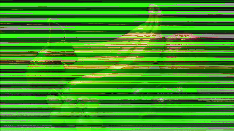

Exercise 1: Classic Scrambled Channel
Classic Scrambled Channel — simulated result across source images.
Exercise Illustration
Learning Outcomes
Reproduce the look of a scrambled pay-per-view channel using cut-and-rotate line shuffling.
Key Concepts
- Line-buffer cut-and-rotate is a circular shift per scanline
- The LFSR produces pseudo-random cut points
- Cut Depth scales the displacement amplitude
Video Source
A live camera feed or recorded footage with clear horizontal features (text, faces, architectural lines).
Steps
- Break the image: Set Cut Depth (Knob 1) to about 70%. The image breaks into horizontally displaced strips.
- Full scramble: Leave Decode (Knob 2) at 0%. This is the fully scrambled state.
- Chase the lock: Slowly sweep Decode from 0% to 100%. Strips begin to realign (some lines lock into place briefly before sliding away.)
- Change the pattern: Set Seed (Knob 3) to different values. Notice how the scramble pattern changes entirely with each seed.
- Smooth shear: Toggle Scramble Mode (Switch 7) to Sawtooth. The random displacement becomes a smooth diagonal shear.

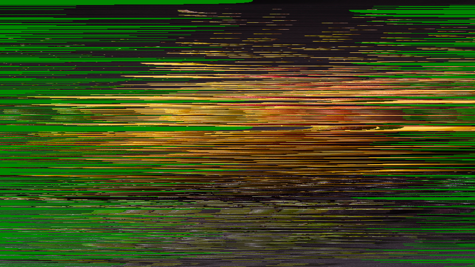

Exercise 2: Descrambler Lock and Drift
Descrambler Lock and Drift — simulated result across source images.
Learning Outcomes
Simulate the experience of a descrambler box drifting in and out of sync with the encrypted signal.
Key Concepts
- The Drift accumulator cycles the seed offset over time
- Different Drift Rate values produce different lock/unlock rhythms
- Decode and Drift interact to create a tuning window
Video Source
Footage with strong contrast and recognizable subjects: the effect is most dramatic when you can tell whether the image is "locked" or not.
Steps
- Partial decode: Set Cut Depth (Knob 1) to 50% and Decode (Knob 2) to about 40%.
- Enable drift: Enable Drift (Switch 9) and set Drift Rate (Knob 6) to about 20%. The image slowly cycles between scrambled and partially decoded states.
- Add inversion bands: Add Invert Period (Knob 4) at step 3. Bands of inverted video appear and disappear as the drift cycles.
- Wobble the lines: Increase Jitter (Knob 5) to about 15%. The horizontal wobble adds urgency to the decoding struggle.
- Chase the sync: Slowly adjust Decode while Drift is running. Notice how you can "chase" the lock point: the image stabilizes briefly when Decode aligns with the current drift state.

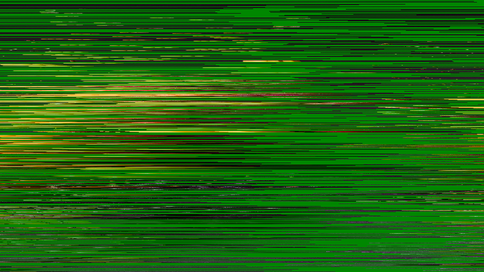

Exercise 3: Full Signal Chaos
Full Signal Chaos — simulated result across source images.
Learning Outcomes
Push all disruption layers simultaneously for maximum analog interference texture.
Key Concepts
- Double scramble adds a second displacement layer
- Luma Mod makes the scrambling content-dependent
- Full YUV inversion creates complementary color banding
Video Source
High-contrast footage or graphic patterns: bold shapes survive the extreme processing and remain partially recognizable.
Steps
- Maximum displacement: Set Cut Depth (Knob 1) to 80% and Decode (Knob 2) to 0%.
- Double scramble: Enable Double (Switch 11). The scrambling becomes more aggressive and harder to decode.
- Content-aware chaos: Enable Luma Mod (Switch 10). Bright areas now displace further, making the scramble pattern follow the content.
- Color inversion bands: Set Invert Period (Knob 4) to step 2 and switch Invert Mode (Switch 8) to Full YUV. Alternating bands of complementary colors appear.
- Wild jitter: Increase Jitter (Knob 5) to 50%. Each scanline now wobbles wildly.
- Animated texture: Enable Drift (Switch 9) with Drift Rate (Knob 6) at 40%. The entire texture animates continuously.
- Blend with original: Sweep Mix (Fader 12) to blend the chaotic output with the clean original.
