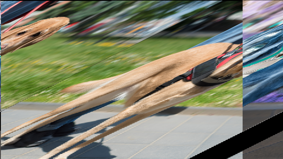

These exercises progress from basic displacement to complex fractured compositions. Each exercise builds on the previous one, engaging more of the signal chain.
Exercise 1: Simple Fault Lines
Simple Fault Lines — simulated result across source images.
Exercise Illustration
Learning Outcomes
Learn how the vertical accumulator creates horizontal displacement bands.
Key Concepts
- The vertical timing accumulator divides the image into horizontal bands
- Top Delay and Bot Delay control the static offset in each band
- The two displacement zones alternate, creating the fault-line effect
Video Source
A live camera feed or recorded footage with recognizable horizontal and vertical features (architecture, landscapes, or text).
Steps
- Create bands: Turn Vert Freq (Knob 3) to about 30%. Faint horizontal banding may appear depending on input content.
- Displace one zone: Increase Top Delay (Knob 1) to about 50%. One set of horizontal bands slides sideways. The alternating bands remain unshifted.
- Displace the other: Increase Bot Delay (Knob 4) to about 50% in the opposite direction. The two sets of bands now slide in independent directions, creating clearly visible fault lines.
- Adjust band width: Sweep Vert Freq (Knob 3) slowly. The fault lines compress and expand. Low values produce wide bands; high values produce narrow stripes.
- Mirror one zone: Toggle Top Flip (Switch 7) to On. The Top bands now show a horizontally reflected image, creating a striking contrast with the normal Bot bands.
Settings
| Control | Value |
| Top Delay | 50% |
| Top Displace | 0% |
| Vert Freq | 30% |
| Bot Delay | 50% |
| Bot Displace | 0% |
| Horiz Freq | 0% |
| Top Flip | On |
| Bot Flip | Off |
| Top Invert | Off |
| Bottom Invert | Off |
| Blank Invert | Off |
| Line Blank | 0% |

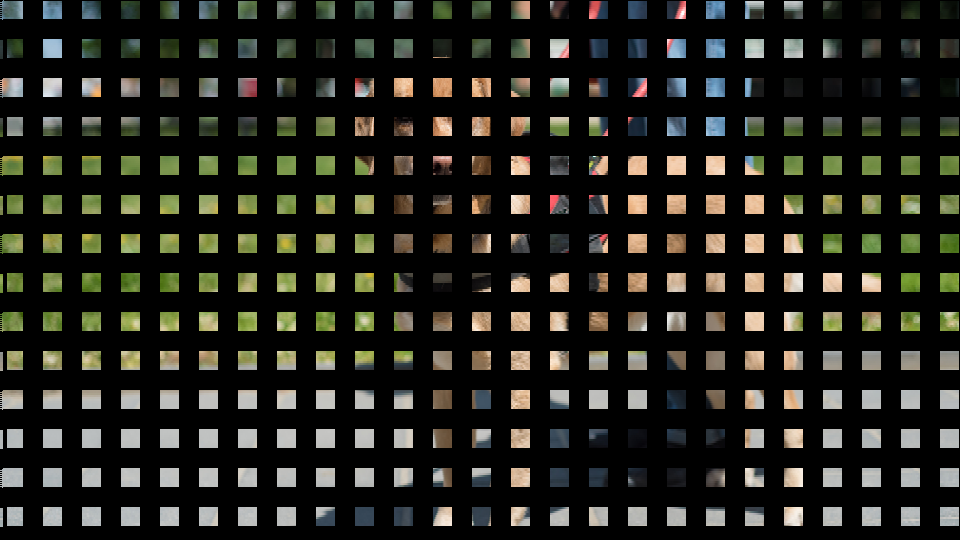

Exercise 3: Fractured Kaleidoscope
Fractured Kaleidoscope — simulated result across source images.
Learning Outcomes
Combine mirroring, inversion, displacement, and blanking for an abstract fractured composition.
Key Concepts
- Mirroring, inversion, and displacement layer together for kaleidoscopic effects
- Blanking extracts geometric shapes from the displacement pattern
- Blank Invert toggles between positive and negative mask shapes
Video Source
High-contrast footage, especially close-up textures, faces, or colorful abstract material.
Steps
- Full grid: Set Vert Freq to ~50% and Horiz Freq to ~40% to create a fine grid of displacement zones.
- Symmetric mirrors: Enable both Top Flip (Switch 7) and Bot Flip (Switch 8). The grid cells alternate between normal and mirrored images.
- Moderate displacement: Set Top Displace to ~60% and Bot Displace to ~40%. Each zone now has its own displacement wave.
- Invert one zone: Enable Top Invert (Switch 9). Alternating zones display inverted video, creating a dramatic tonal contrast across the grid.
- Carve with blanking: Increase Line Blank (Fader 12) to about 40%. Portions of the grid are replaced with black, isolating floating fragments of the pattern.
- Invert the mask: Toggle Blank Invert (Switch 11) to On. The blanking mask flips, revealing the previously hidden areas and hiding what was visible.
- Animate: Slowly sweep Top Delay (Knob 1) to shift the pattern across the blanking mask.
Settings
| Control | Value |
| Top Delay | 30% |
| Top Displace | 60% |
| Vert Freq | 50% |
| Bot Delay | 20% |
| Bot Displace | 40% |
| Horiz Freq | 40% |
| Top Flip | On |
| Bot Flip | On |
| Top Invert | On |
| Blank Invert | On |
| Line Blank | 40% |
