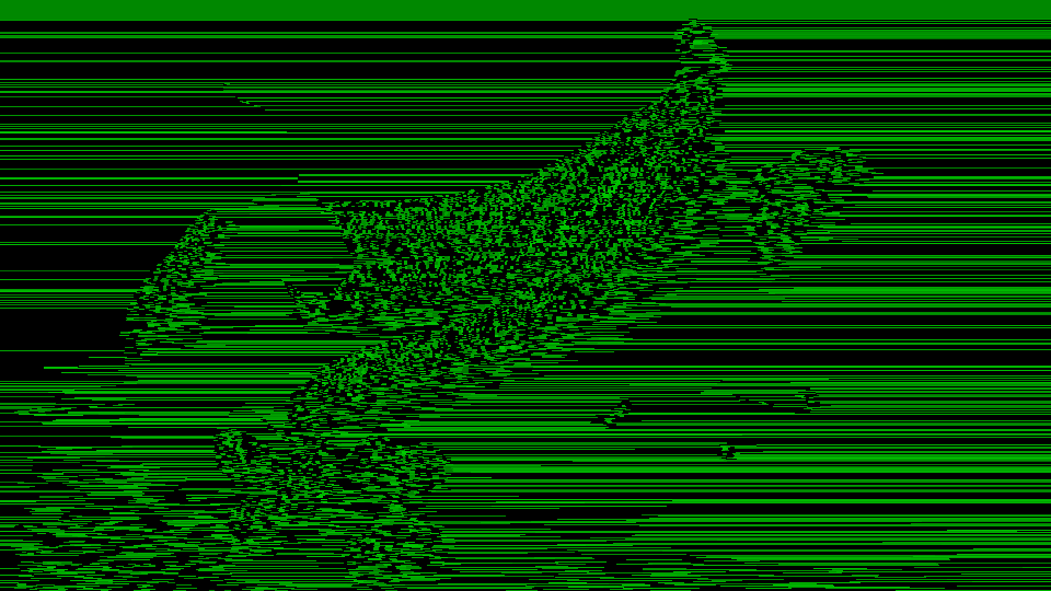

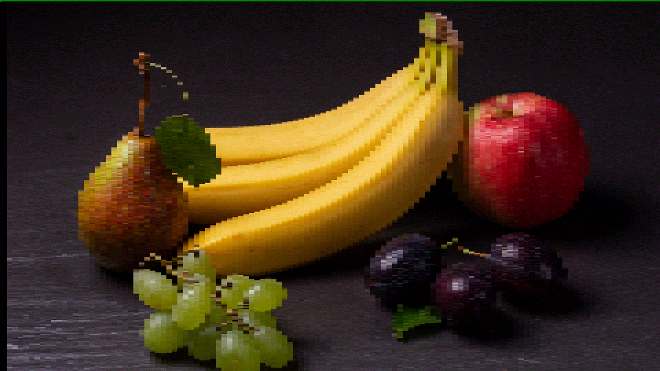

Exercise 1: Mosaic Pixelation
Mosaic Pixelation result
Mosaic Pixelation — simulated result across source images.
Exercise Illustration
Learning Outcomes
Learn how decimation and luminance modulation interact to create adaptive mosaic textures.
Key Concepts
  • Decimation is sample-and-hold downsampling
  • Horizontal and vertical axes are independent
  • Luminance modulation creates content-adaptive mosaics
Video Source
A live camera feed or recorded footage with recognizable subjects.
Steps
  1. Horizontal bands: Turn Hori Decimate (Knob 1) slowly counter-clockwise. The image breaks into wide vertical bands of uniform color.
  2. Vertical bands: Now sweep Vert Decimate (Knob 2). The image breaks into horizontal bands.
  3. Square blocks: Set both Hori Decimate and Vert Decimate to about 30%. The image becomes a uniform mosaic of roughly square blocks.
  4. Adaptive mosaic: Slowly increase Luma to Hori (Knob 3) from 0 to 100%. The block grid responds to the image content: bright and dark regions render different block sizes. This is Bitcullis’s signature effect.
  5. Inversion: Toggle Luma Invert (Switch 7). The modulation reverses. Block sizes swap between bright and dark regions.
Settings
Control Value
Hori Decimate
~30%
Vert Decimate
30%
Luma to Hori
100%
Luma Poster
0%
Chroma Poster
50%
Luma to Chroma
50%
Luma Invert
On
Bit Order
Normal
Dithering
Disabled
Dither Algo
Ordered
Bypass
Off
Threshold
0%

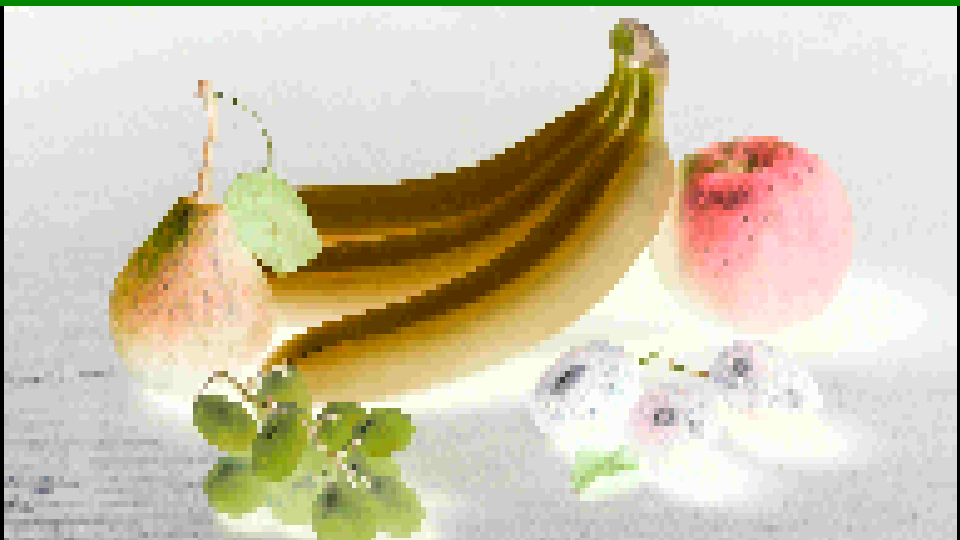

Exercise 2: Posterized Graphics
Posterized Graphics result
Posterized Graphics — simulated result across source images.
Learning Outcomes
Explore posterization and dithering interactions.
Key Concepts
  • Posterization is quantization of pixel values
  • Dithering masks quantization artifacts by adding structured noise
  • Bit reversal is a nonlinear permutation
Video Source
Footage with gradual tonal transitions, such as skies, skin tones, or gradient test patterns.
Steps
  1. Prepare: Set moderate decimation (Hori Decimate and Vert Decimate ~50%) to create a visible mosaic.
  2. Luma posterization: Slowly increase Luma Poster (Knob 4). Smooth gradients collapse into staircase bands.
  3. Chroma posterization: Now increase Chroma Poster (Knob 5) while leaving Luma Poster at a moderate value. Colors snap to a reduced palette while brightness remains smooth.
  4. Dithering: Enable Dithering (Switch 9). The harsh posterization boundaries soften as noise pushes color values across quantization boundaries. Toggle Dither Algo (Switch 10) to compare Ordered vs. Random algorithms.
  5. Bit reversal: Enable Bit Order (Switch 8), setting it to Swapped. The orderly posterized levels explode into chaotic digital textures.
  6. Threshold: Adjust Threshold (Fader 12) to carve into the posterized result. Note how the threshold cuts cleanly along posterization boundaries.
Settings
Control Value
Hori Decimate
50%
Vert Decimate
50%
Luma to Hori
50%
Luma Poster
50%
Chroma Poster
50%
Luma to Chroma
50%
Luma Invert
Off
Bit Order
Normal
Dithering
Enabled
Dither Algo
Random
Bypass
Off
Threshold
0%
