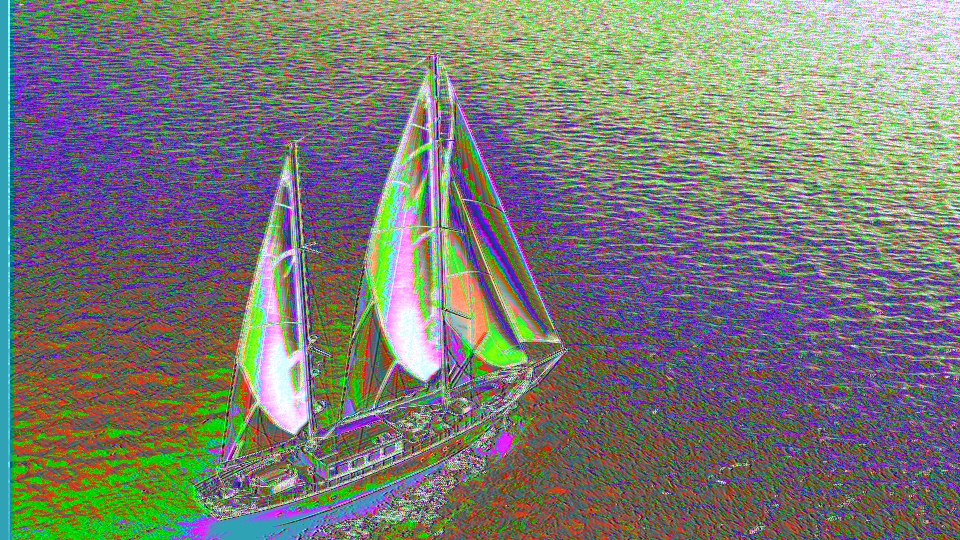

Corollas transforming luminance gradients into layered harmonic petal patterns across Y, U, and V color channels.
Corollas is a harmonic video processor that splits input luminance into four frequency-doubled layers and distributes them across the Y, U, and V channels. Its core operation is frequency folding: the input signal is reflected at its midpoint, converting ramps into triangles and triangles into higher-frequency triangles. Cascading four of these stages creates harmonics at 2×, 4×, 8×, and 16× the input frequency. The lower two harmonics form luminance; the upper two generate chrominance.
The result is a transformation that turns even simple gradients into complex, symmetrical interference patterns. Adjusting the input contrast and offset changes how the folding maps across the brightness range, while per-harmonic hue offsets and inversion toggles let you sculpt the exact shape and color of each petal layer. At subtle settings, Corollas adds gentle colorization and tonal shaping. At extreme settings, it produces vivid kaleidoscopic textures with intricate, flower-like symmetry.
Harmonics are the signature effect. The four frequency-doubled layers create mathematically precise symmetry in the output. Each harmonic is phase-locked to the input, so the patterns always track the source content.

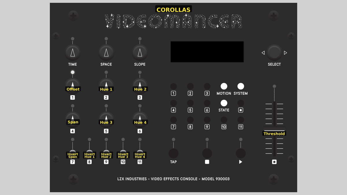

Videomancer front panel with Corollas loaded
Videomancer’s front panel with Corollas active. Knobs 1–6 (top two rows of left cluster), Toggle switches 7–11 (bottom row of left cluster), Fader 12 (right side).

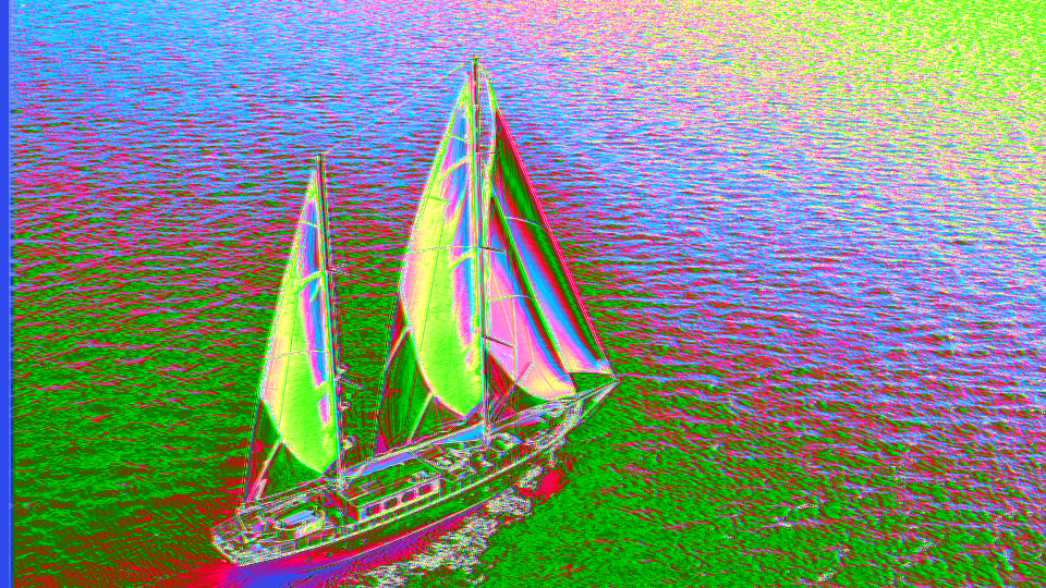

Exercise 1: Triangle Wave Folding
Triangle Wave Folding result
Triangle Wave Folding — simulated result across source images.
Exercise Illustration
Learning Outcomes
Understand how frequency doubling creates symmetrical fold patterns from input luminance.
Key Concepts
  • Frequency doubling folds a ramp at the midpoint, creating a triangle
  • Cascading doublers multiplies the frequency geometrically (2×, 4×, 8×, 16×)
  • The proc amp controls how much of the input range passes through the folding stages
Video Source
A gradient test pattern or any footage with smooth tonal transitions such as skies or slow camera pans.
Steps
  1. Baseline: Set Span (Knob 4) to about 100.0%. Set Offset (Knob 1) to center (0.0%). All Hue knobs to 0.0%. All toggles Off. Threshold at 0.0.
  2. Fold pattern: With a gradient input, the smooth ramp transforms into a symmetrical triangle pattern. Bright and dark regions fold into mirrored peaks.
  3. Increase Span: Slowly turn Span clockwise past 100%. The signal drives harder into the folding stages. More peaks appear as the harmonics grow stronger.
  4. Sweep Offset: Move Offset across its full range. The entire fold pattern slides through the brightness content like a kaleidoscope.
  5. Invert: Toggle Invert Span (Switch 7). The fold pattern complements (peaks become valleys and valleys become peaks.)

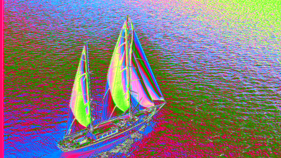

Exercise 2: Chroma Petals
Chroma Petals result
Chroma Petals — simulated result across source images.
Learning Outcomes
Explore how harmonic offsets create color from luminance.
Key Concepts
  • The 8× and 16× harmonics generate the U and V chroma channels
  • Hue offsets push chroma away from neutral, introducing visible color
  • Different offset combinations create different hues
Video Source
A camera feed with recognizable subjects and moderate contrast.
Steps
  1. Prepare: Begin with the settings from Exercise 1.
  2. Add U color: Turn Hue 3 (Knob 5) clockwise to about 50.0%. Color appears as the 8× harmonic pattern drives the U channel.
  3. Add V color: Turn Hue 4 (Knob 6) clockwise to about 50.0%. A second color component emerges as the 16× harmonic drives the V channel.
  4. Invert one chroma: Toggle Invert Hue 3 (Switch 10). The U channel color flips polarity, shifting the overall hue dramatically.
  5. Balance: Experiment with different Hue 3 and Hue 4 ratios. Equal values create one palette; unequal values create another.

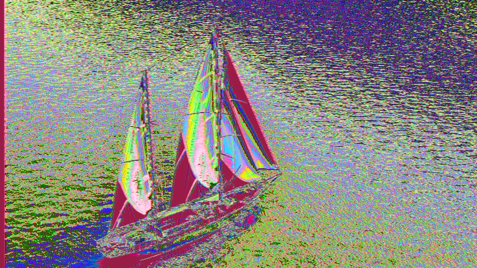

Exercise 3: Petal Isolation
Petal Isolation result
Petal Isolation — simulated result across source images.
Learning Outcomes
Combine all controls to isolate specific harmonic layers and carve petal silhouettes.
Key Concepts
  • Threshold keys out dark areas, isolating bright harmonic peaks
  • Per-harmonic inversion creates complex interference between layers
  • The full parameter set works together as a single sculptural instrument
Video Source
High-contrast footage or a black-and-white test pattern with sharp edges.
Steps
  1. Prepare: Set Span to ~180.0%, Offset near center.
  2. Color the petals: Set Hue 3 to ~70.0% and Hue 4 to ~30.0% for asymmetric coloring.
  3. Shift luminance balance: Increase Hue 1 to ~40.0% and leave Hue 2 at 0.0%. The 2× harmonic brightens while 4× stays dark, creating uneven luminance layering.
  4. Invert for interference: Toggle Invert Hue 2 (Switch 9). The 4× layer flips, creating constructive and destructive interference with the 2× layer in the luminance channel.
  5. Key the petals: Slowly raise Threshold (Fader 12) until only the brightest harmonic peaks survive. The output becomes sharp petal shapes against black.
  6. Flip the base: Toggle Invert Span (Switch 7) to produce the complementary petal arrangement.
