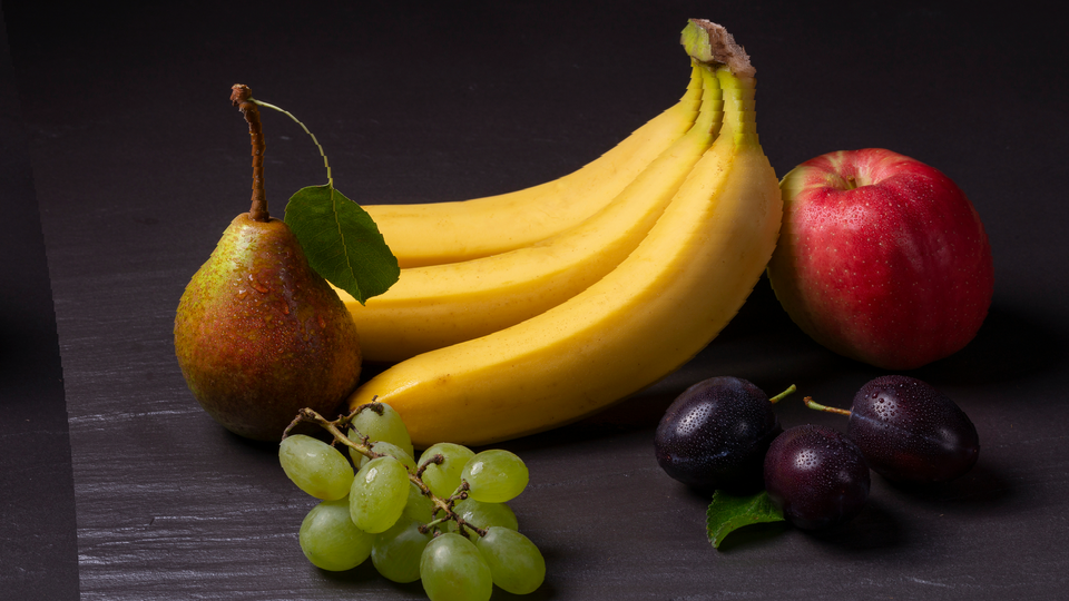

Delirium hero image
Delirium applying cascaded sinusoidal distortion to warp a video signal into undulating, dreamlike waves.
Delirium is a two-layer sinusoidal distortion engine that bends and ripples video like a reflection on disturbed water. Each layer computes a sine wave that displaces pixels horizontally, stretching and compressing the image along a wave pattern. The two layers operate in cascade, meaning one layer distorts the already-distorted output of the other, producing compound wave interference patterns that can range from gentle undulation to full psychedelic delirium.
Each layer has independent controls for amplitude (wave depth), frequency (wave spacing), and speed (animation rate). The mode switch for each layer selects whether the sine wave varies by scanline (vertical striping) or by pixel position (horizontal ripple). When both layers are active with different modes and frequencies, they produce complex two-dimensional distortion fields that continuously evolve.
Start with one layer. Set Amplitude 2 (Knob 4) to zero and experiment with Layer 1 alone before engaging the second layer. This makes the distortion behavior much easier to understand.

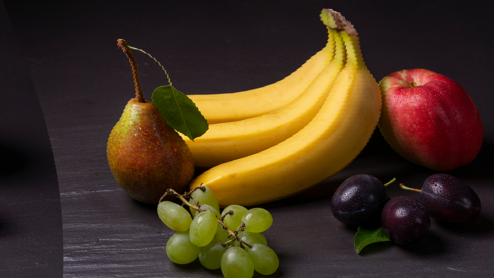

Exercise 1: Single-Layer Ripple
Single-Layer Ripple result
Single-Layer Ripple — simulated result across source images.
Exercise Illustration
Learning Outcomes
Learn how amplitude, frequency, and mode interact to shape a single sine distortion layer.
Key Concepts
  • Sine displacement shifts pixel read addresses
  • Vert mode varies displacement per scanline; Horiz mode varies per pixel
  • Amplitude controls wave depth; Frequency controls wave spacing
Video Source
A live camera feed or recorded footage with strong vertical and horizontal lines (architecture, text, grids).
Steps
  1. Disable Layer 2: Set Amplitude 2 (Knob 4) to 0%.
  2. Gentle ripple: Set Amplitude 1 (Knob 1) to about 15% and Frequency 1 (Knob 2) to about 20%. The image ripples softly with broad, slow waves.
  3. Increase frequency: Sweep Frequency 1 upward. The wave spacing tightens and the distortion becomes more intense.
  4. Switch mode: Toggle Layer 1 Mode (Switch 7) from Vert to Horiz. The distortion changes from horizontal bands rippling left/right to an accordion-like squeeze within each scanline.
  5. Animate: Increase Speed 1 (Knob 3) to set the wave in motion. The distortion scrolls continuously.

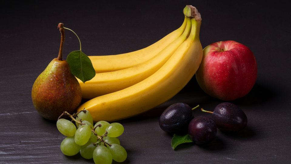

Exercise 2: Compound Cascade
Compound Cascade result
Compound Cascade — simulated result across source images.
Learning Outcomes
Explore how two cascaded distortion layers interact to create complex warping.
Key Concepts
  • Cascaded nonlinear distortion produces interference patterns
  • Perpendicular modes (one Vert, one Horiz) create two-dimensional warping
  • Cascade order changes the result even with identical settings
Video Source
Footage with recognizable geometry: faces, architecture, or text. The distortion is most legible when the source has clear structure to warp.
Steps
  1. Two perpendicular layers: Keep Layer 1 in Vert mode. Set Layer 2 Mode (Switch 8) to Horiz. Set both amplitudes to about 20% and both frequencies to about 30%.
  2. Observe compound warping: The image warps in two dimensions: scanlines ripple left/right and each scanline is also squeezed and stretched internally.
  3. Animate both: Set Speed 1 to ~20% and Speed 2 to ~15%. The two wave patterns drift at different rates, creating continuously evolving distortion.
  4. Swap cascade order: Toggle Cascade (Switch 9) from L1>L2 to L2>L1. Notice how the visual character changes even though the per-layer settings haven’t moved.
  5. Phase Link: Enable Phase Link (Switch 10). Both layers now animate in lockstep (the pattern becomes more coherent and symmetrical.)

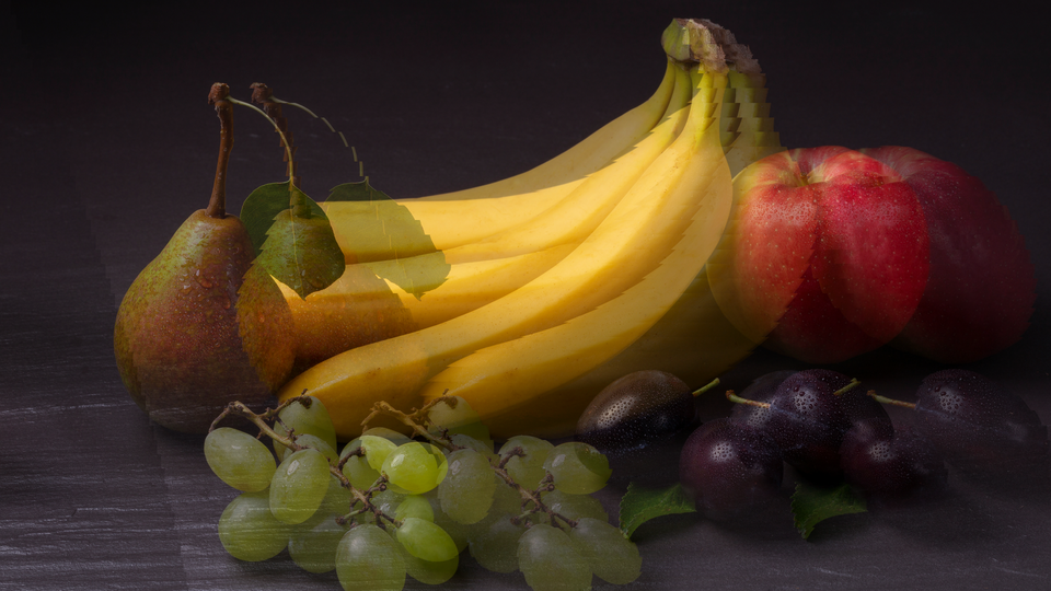

Exercise 3: EarthBound Battle Screen
EarthBound Battle Screen result
EarthBound Battle Screen — simulated result across source images.
Learning Outcomes
Recreate the iconic psychedelic battle background distortion from EarthBound.
Key Concepts
  • High amplitude + moderate frequency creates intense rubber-sheet distortion
  • Two layers at different speeds produce evolving kaleidoscopic patterns
  • Phase Lock can freeze a striking frame for examination
Video Source
Abstract video, colorful gradients, or synthesized patterns. Bold shapes and saturated colors showcase the distortion most dramatically.
Steps
  1. High amplitude: Set Amplitude 1 to ~50% and Amplitude 2 to ~40%.
  2. Different frequencies: Set Frequency 1 to ~40% and Frequency 2 to ~60%. The mismatched frequencies produce intricate interference.
  3. Cross-axis modes: Set Layer 1 Mode to Vert and Layer 2 Mode to Horiz for full two-dimensional chaos.
  4. Animate at different speeds: Set Speed 1 to ~30% and Speed 2 to ~20%. The compound pattern evolves continuously.
  5. Freeze frame: Toggle Phase Lock (Switch 11) to Lock to freeze the pattern. Adjust amplitudes and frequencies to sculpt the frozen distortion.
  6. Wet/dry blend: Pull Mix (Fader 12) down to about 50% to blend the distorted image with the clean original for a ghostly overlay effect.
