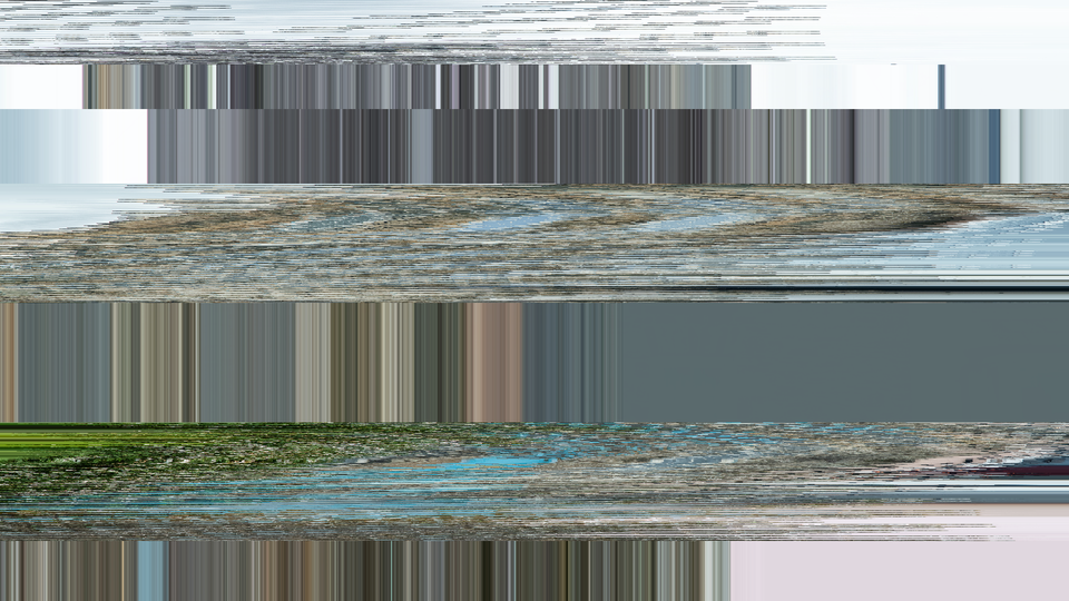

Elastica hero image

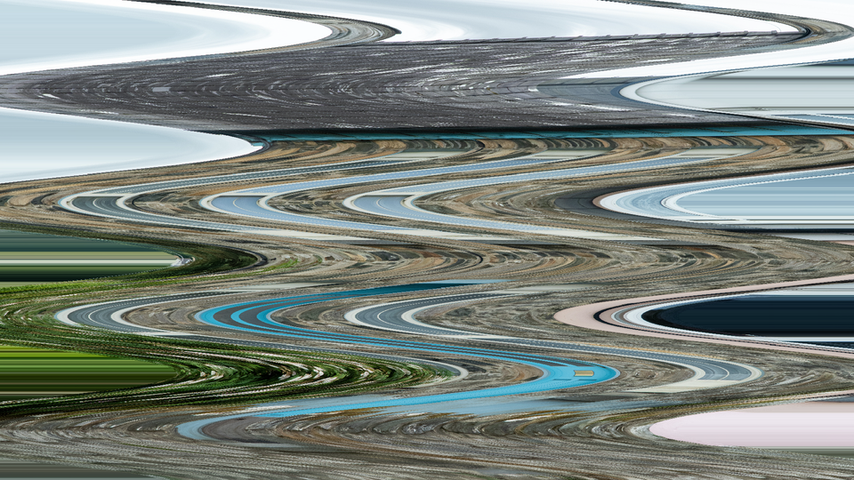

Elastica applying sine-wave horizontal displacement to create rippling, Scanimate-style warp animation across the video frame.
Elastica displaces luma only. Chroma passes through undisplaced, so the warp moves brightness detail while colour stays in place. This is how the program fits in the FPGA’s RAM across all video modes.
Elastica is a per-scanline horizontal displacement engine inspired by the Scanimate, the legendary analog computer animation system of the 1970s. Its core trick is simple: each line of the image is shifted left or right by an amount determined by a programmable waveshape. The result is a fluid bowing, rippling, shearing, or stacking of the picture that feels organic and alive: the visual equivalent of dragging your fingers across wet ink.
Elastica generates its displacement pattern using a direct digital synthesis (DDS) phase accumulator that advances once per scanline. Four waveshapes: sine, triangle, sawtooth, and square: create different flavors of distortion. A second DDS handles vertical squeeze and stretch, and the two generators can be cross-modulated for complex two-dimensional warping. When animation is enabled, the phase scrolls continuously, recreating the signature Scanimate "ripple crawl" that made the original hardware so mesmerizing.
Start with a sine wave and low amplitude. Even subtle displacement transforms static video into something that seems to breathe.

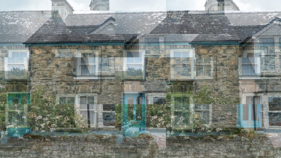

Exercise 1: Classic Scanimate Ripple
Classic Scanimate Ripple result
Classic Scanimate Ripple — simulated result across source images.
Exercise Illustration
Learning Outcomes
Recreate the signature horizontal ripple effect of the Scanimate analog animation system.
Key Concepts
  • DDS phase accumulator generates periodic displacement
  • Sine waveshape produces smooth, organic bowing
  • Animation scrolls the displacement pattern over time
Video Source
A live camera feed or recorded footage with strong vertical lines or text.
Steps
  1. Initial displacement: Set H Amplitude (Knob 2) to about 40%. The image bows gently into a sine wave.
  2. Tune the ripple: Adjust H Frequency (Knob 1) until you see 3–4 complete wave cycles across the frame height.
  3. Start animation: Toggle Animate (Switch 11) to On. Set Anim Speed (Knob 6) to about 25%. The wave pattern crawls upward through the image.
  4. Deepen the warp: Slowly increase H Amplitude to see the distortion deepen. Notice how vertical lines in the source bend and flow.
  5. Compare waveshapes: Set Wave Sel A (Switch 7) to On and leave Wave Sel B (Switch 8) Off (triangle). Compare the sharper peaks with the smooth sine (both Off).
