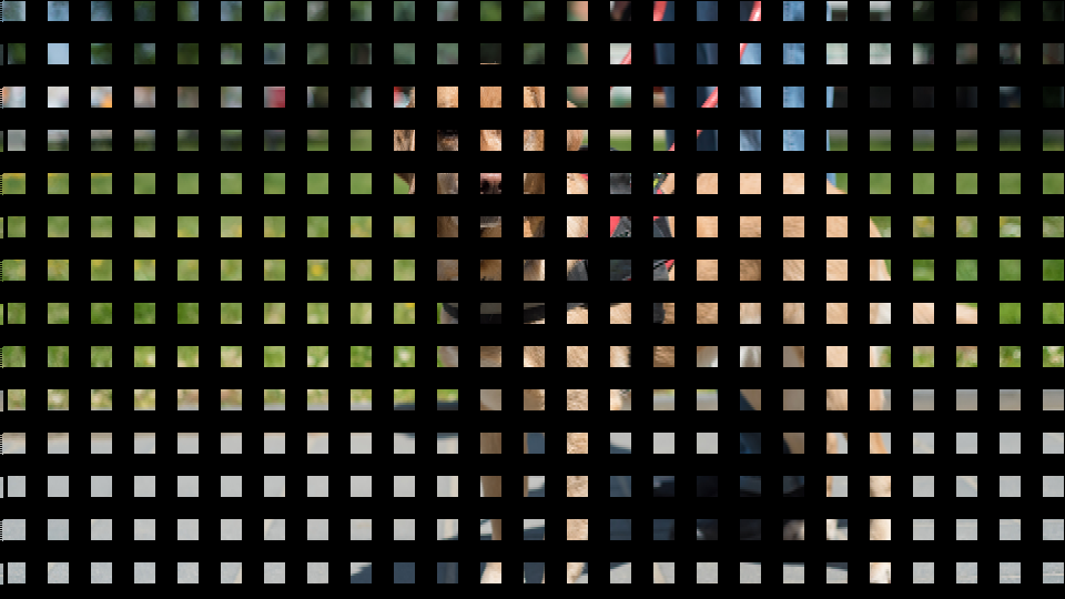

Exercise 3: Fractured Kaleidoscope
Fractured Kaleidoscope result
Fractured Kaleidoscope — simulated result across source images.
Exercise Illustration
Learning Outcomes
Combine mirroring, inversion, displacement, and blanking for an abstract fractured composition.
Key Concepts
  • Mirroring, inversion, and displacement layer together for kaleidoscopic effects
  • Blanking extracts geometric shapes from the displacement pattern
  • Blank Invert toggles between positive and negative mask shapes
Video Source
High-contrast footage, especially close-up textures, faces, or colorful abstract material.
Steps
  1. Full grid: Set Vert Freq to ~50% and Horiz Freq to ~40% to create a fine grid of displacement zones.
  2. Symmetric mirrors: Enable both Top Flip (Switch 7) and Bot Flip (Switch 8). The grid cells alternate between normal and mirrored images.
  3. Moderate displacement: Set Top Displace to ~60% and Bot Displace to ~40%. Each zone now has its own displacement wave.
  4. Invert one zone: Enable Top Invert (Switch 9). Alternating zones display inverted video, creating a dramatic tonal contrast across the grid.
  5. Carve with blanking: Increase Line Blank (Fader 12) to about 40%. Portions of the grid are replaced with black, isolating floating fragments of the pattern.
  6. Invert the mask: Toggle Blank Invert (Switch 11) to On. The blanking mask flips, revealing the previously hidden areas and hiding what was visible.
  7. Animate: Slowly sweep Top Delay (Knob 1) to shift the pattern across the blanking mask.
