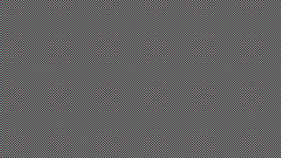

  6. Blend with source: Sweep Mix (Fader 12) to blend the processed texture with the raw input. At about 50%, the Fauxtress texture floats translucently over the source.
Settings
Control Value
H Rate
~500
V Rate
~500
Anim Rate
~300
Delay
~256
Feedback
50%
Depth
1023
H Lock
Free
V Lock
Free
Luma Src
Video
Phase Wrap
On
Invert
Off
Mix
100%
