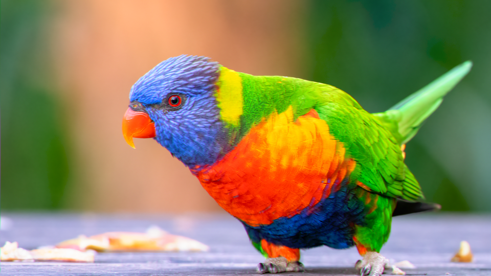

A colorful, well-lit scene with recognizable warm and cool tones (a face with a blue sky, or fruit on a table.)
Steps

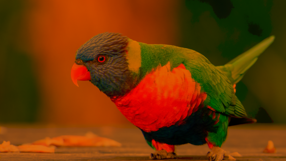

  1. Default warmth: Leave all controls at defaults. Observe the subtle warm shift from the default H&D curve and saturation boost.
  2. Kill the reds: Turn Red Exp (Knob 1) fully counterclockwise. Reds vanish, leaving a cool cyan-blue image.
  3. Kill the blues: Return Red Exp to center, then turn Blue Exp (Knob 2) fully counterclockwise. Blues vanish, leaving a warm orange-red image.
  4. Balanced underexposure: Set both Red Exp and Blue Exp to about 75%. Notice how the balanced underexposure darkens the image and compresses tones through the H&D toe.
  5. Restore punch: Increase Contrast (Knob 3) to about 80%. The straight section of the H&D curve extends, restoring punch to the underexposed image.

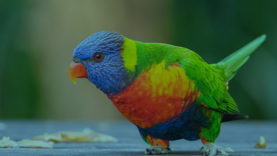

  1. Fade the dyes: Enable Film Fade (Switch 10) to Aged. The image shifts toward cyan-green as the red channel fades, simulating a decades-old print.
  2. Lift the shadows: Enable Toe Lift (Switch 8) to Lifted. Shadows rise slightly: the deepest blacks become a foggy dark gray, like a print with base density fog.
  3. Flatten the curve: Reduce Contrast (Knob 3) to about 30%. The H&D curve flattens, compressing the tonal range into a soft, low-contrast image.
  4. Muddy the colors: Increase Matrix Bleed (Knob 6) to about 40%. The faded dyes bleed into each other, further muddying the color purity.
  5. Registration slip: Add moderate Fringe (Knob 4) at step 2–3. The slight misregistration completes the degraded vintage look.
