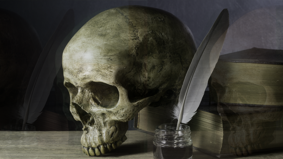

Exercise 1: Basic Feedback Tunnel
Basic Feedback Tunnel result
Basic Feedback Tunnel — simulated result across source images.
Exercise Illustration
Learning Outcomes
Discover how zoom and decay interact to create the classic recursive tunnel effect.
Key Concepts
  • Feedback is a recursive read-modify-write loop through BRAM
  • Zoom sets the spatial scale of each recursive step
  • Decay controls how quickly previous iterations fade
Video Source
A live camera feed or footage with recognizable shapes and strong contrast.
Steps
  1. Echo trail: Set Decay (Knob 2) to about 75% and Inject (Knob 3) to about 50%. Move your hand or an object in front of the camera. You should see ghostly echoes trailing behind the motion.
  2. Tunnel out: With Zoom Polar on Expand (default), set Zoom (Knob 1) slightly above center, around +25%. The echoes bloom outward on each pass, creating a tunnel that expands from the center of the screen.
  3. Tunnel in: Toggle Zoom Polar (Switch 7) to Contract. The tunnel reverses — recursion collapses inward toward the center.
  4. Balance the loop: Slowly increase Decay until the tunnel pattern sustains itself without fading. You’re looking for the threshold where the loop is just barely self-sustaining.
  5. Mix blend: Pull the Mix fader (Fader 12) to about 70% to see the original input layered beneath the tunnel pattern.
Settings
Control Value
Zoom
~+25%
Decay
~75%
Inject
~50%
Color Drift
0%
H Shift
0%
Brightness
50%
Zoom Polar
Contract
Drift Dir
CW
Self-Excite
Off
Channel Lock
Locked
Freeze
Off
Mix
~70%

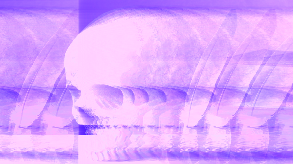

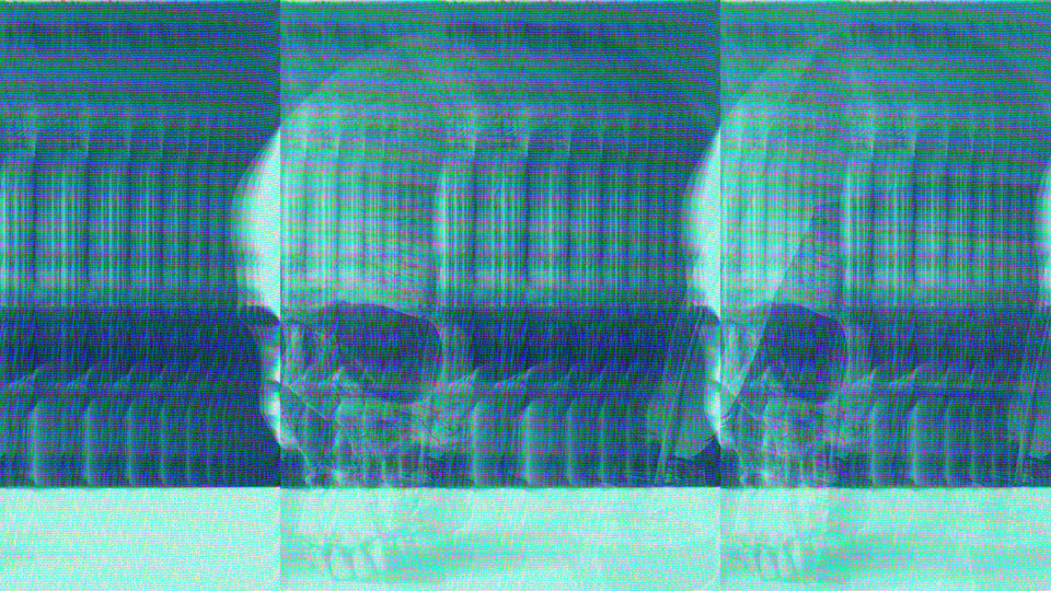

Exercise 2: Rainbow Spiral
Rainbow Spiral result
Rainbow Spiral — simulated result across source images.
Learning Outcomes
Add color drift and horizontal shift to create evolving, colorful feedback patterns.
Key Concepts
  • Givens rotation shifts hue on each feedback pass
  • H Shift adds horizontal motion to the feedback loop
  • Channel Lock changes the character of color evolution
Video Source
High-contrast footage with distinct shapes (geometric patterns or silhouettes work well.)
Steps
  1. Start from Exercise 1: Keep your tunnel running at moderate decay.
  2. Add color: Slowly increase Color Drift (Knob 4) from zero. Each recursive layer acquires a different hue, and the tunnel becomes a rainbow spiral.
  3. Reverse direction: Toggle Drift Dir (Switch 8) to CCW. The color cycle reverses.
  4. Horizontal motion: Increase H Shift (Knob 5) slightly. The feedback pattern slides sideways, frame by frame, creating a scrolling spiral.
  5. Unlock channels: Toggle Channel Lock (Switch 10) to Indep. The U and V chrominance channels now rotate in opposite directions, producing more saturated, split-complementary color patterns.
  6. Freeze a moment: When you see a pattern you like, toggle Freeze (Switch 11) to On. The buffer holds its state. Toggle it off to resume.
Settings
Control Value
Zoom
~+25%
Decay
~75%
Inject
~40%
Color Drift
~30%
H Shift
~15%
Brightness
50%
Zoom Polar
Contract
Drift Dir
CW
Self-Excite
Off
Channel Lock
Indep
Freeze
Off
Mix
100%

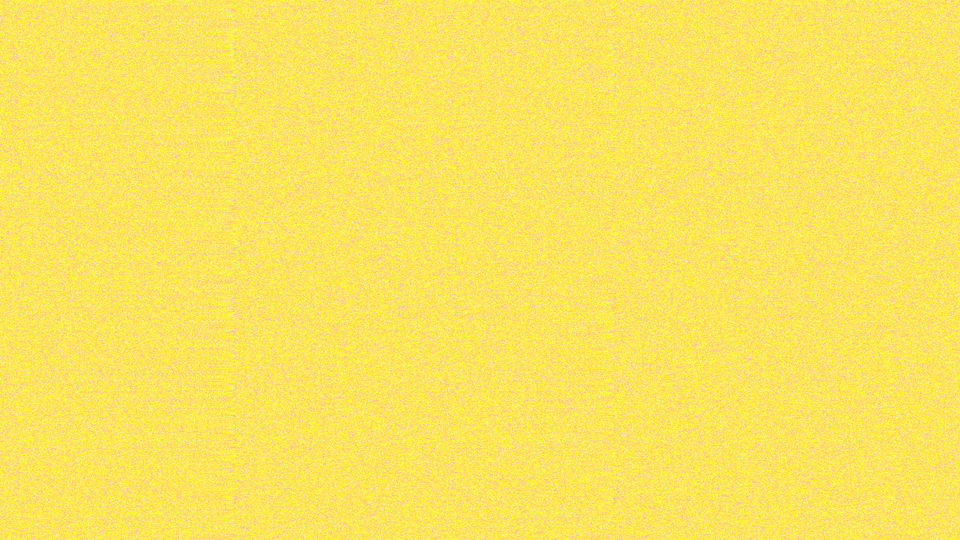

Exercise 3: Self-Exciting Synthesis
Self-Exciting Synthesis result
Self-Exciting Synthesis — simulated result across source images.
Learning Outcomes
Use Howler as a standalone video synthesizer with no external input.
Key Concepts
  • Self-Excite seeds the feedback loop with LFSR noise
  • The feedback loop sculpts noise into structured patterns
  • Inject controls the energy entering the system
Video Source
No source video needed (disconnect or ignore the input signal.)
Steps
  1. Enable noise: Toggle Self-Excite (Switch 9) to On. The input is replaced with pseudorandom noise from two LFSR generators.
  2. Build the loop: Set Decay to ~70%, Inject to ~50%, and Zoom to ~+25%. The noise begins to organize into recursive structures as the feedback loop magnifies and reinforces certain patterns.
  3. Add drift: Increase Color Drift to ~40%. The evolving noise patterns gain color, cycling through the spectrum as the loop iterates.
  4. Brightness bloom: Increase Brightness (Knob 6) above 50% to amplify the luminance. The patterns brighten and bloom, creating vivid self-generated imagery.
  5. Explore: Slowly sweep Zoom and Decay to find different self-sustaining regimes. Some settings produce stable geometric patterns; others produce chaotic, constantly evolving textures.
Settings
Control Value
Zoom
~+25%
Decay
~70%
Inject
~50%
Color Drift
~40%
H Shift
~20%
Brightness
~70%
Zoom Polar
Expand
Drift Dir
CW
Self-Excite
On
Channel Lock
Locked
Freeze
Off
Mix
100%
