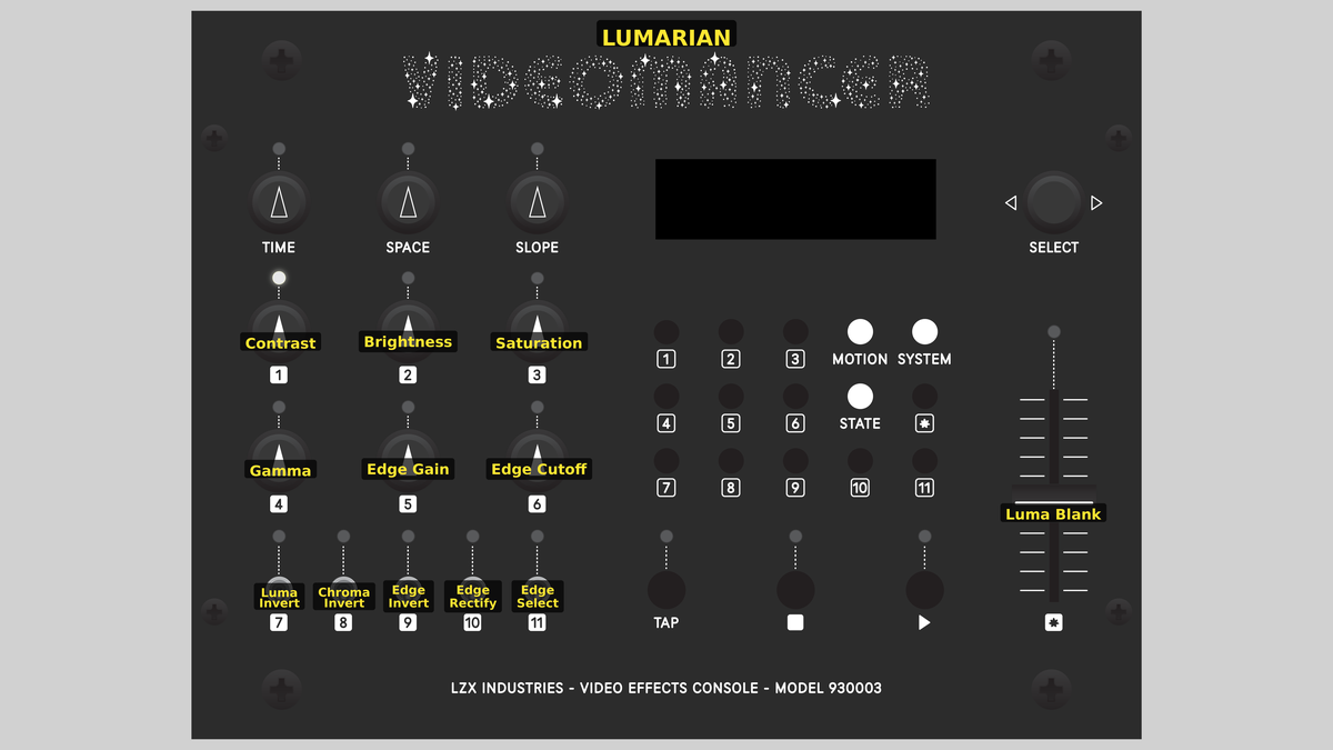

Videomancer front panel with Lumarian loaded
Videomancer’s front panel with Lumarian active. Knobs 1–6 (top two rows of left cluster), Toggle switches 7–11 (bottom row of left cluster), Fader 12 (right side).

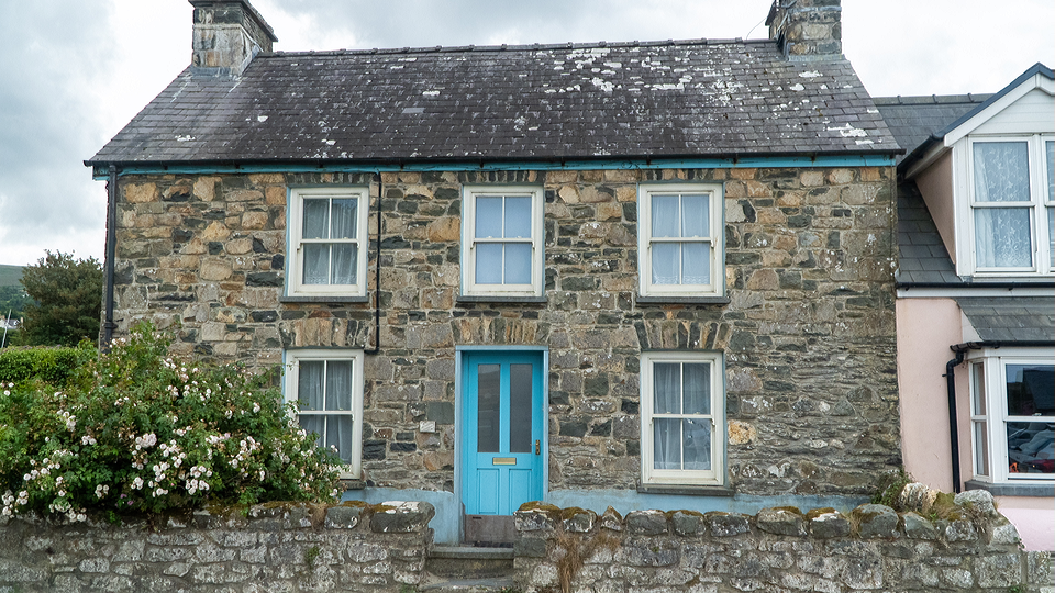

Classical Color Correction result
Classical Color Correction — simulated result across source images.
Exercise Illustration
Learning Outcomes
Learn how the proc amp and gamma stages interact to achieve balanced color correction.
Key Concepts
  • Contrast scales the tonal range; brightness shifts it
  • Gamma reshapes the midtone distribution without clipping
  • Saturation controls color intensity independently of luminance
Video Source
A live camera feed or recorded footage with a mix of shadow, midtone, and highlight areas.
Steps
  1. Boost contrast: Turn Contrast (Knob 1) clockwise to about 130%. The image gains dynamic range (shadows darken, highlights brighten.)
  2. Compensate brightness: Adjust Brightness (Knob 2) slightly counterclockwise to bring the overall level back to a natural balance.
  3. Lift midtones: Turn Gamma (Knob 4) slightly clockwise (above center). Notice how shadow detail becomes visible without blowing out highlights.
  4. Desaturate gently: Reduce Saturation (Knob 3) to about 80%. Colors become more muted and filmic.
  5. Compare: Toggle each control back to its default position one at a time to hear the difference each correction makes.

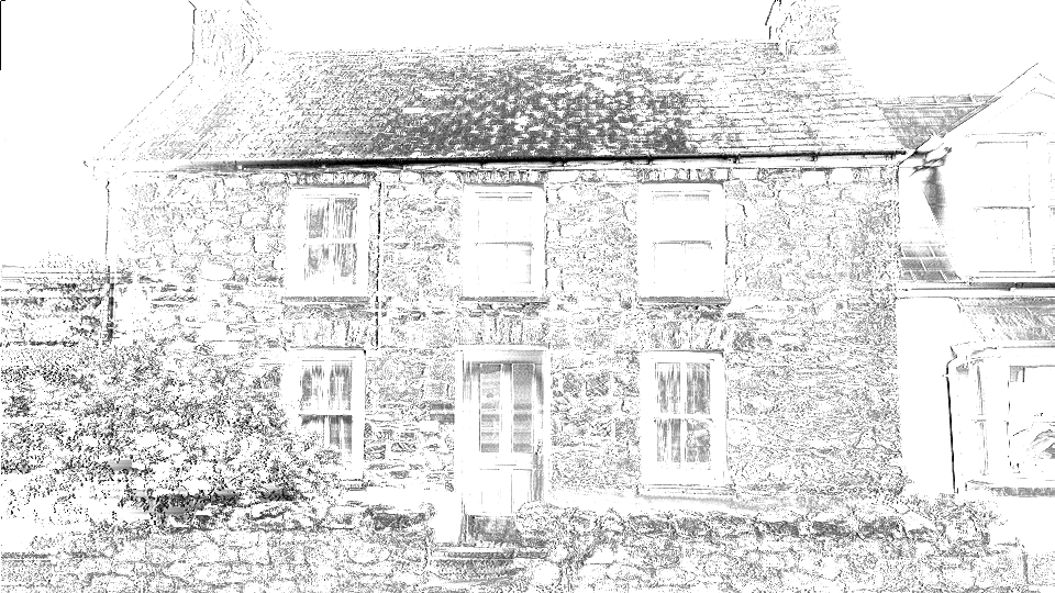

Edge Sculpting result
Edge Sculpting — simulated result across source images.
Learning Outcomes
Explore the edge enhancement chain and its rectifier modes to create dramatic edge outlines.
Key Concepts
  • The high-pass filter extracts edges; cutoff controls their scale
  • The rectifier shapes edge polarity; three toggles yield eight combinations
  • Edge gain blends enhanced edges back into the image
Video Source
Footage with strong contours: architectural shapes, faces, or high-contrast graphic patterns.
Steps
  1. Apply moderate contrast: Set Contrast to about 120% and Gamma slightly above center to establish a clean tonal base.
  2. Reveal edges: Turn Edge Gain (Knob 5) to about 100%. Turn Edge Cutoff (Knob 6) to about 50%. Bright halos appear along contours.
  3. Rectify edges: Toggle Edge Rectify (Switch 10) to On. Both sides of each contour now glow, doubling the edge lines.
  4. Select both edges: Toggle Edge Select (Switch 11) to Both. The edge response becomes more symmetrical and pronounced.
  5. Invert edge polarity: Toggle Edge Invert (Switch 9) to On. Edge halos become dark grooves. Toggle it back off and notice the difference.
  6. Threshold carve: Slowly increase Luma Blank (Fader 12) to about 40%. Only the brightest edge-enhanced regions survive, creating glowing outlines on black.

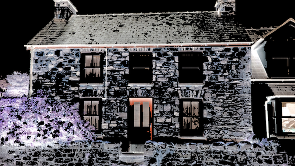

Inverted Luminance Key result
Inverted Luminance Key — simulated result across source images.
Learning Outcomes
Combine gamma curves, inversion, and threshold keying to create a luminance key mask.
Key Concepts
  • Gamma extremes create dramatic contrast curves
  • Luma Invert flips the tonal map, changing what the threshold keeps
  • Chroma Invert shifts hues to their complements
Video Source
High-contrast footage such as silhouettes, text on a background, or stage lighting.
Steps
  1. Crush with gamma: Turn Gamma (Knob 4) fully counterclockwise. Midtones collapse into shadows, leaving only the brightest highlights.
  2. Boost contrast: Set Contrast (Knob 1) to about 160% to amplify the stark gamma curve.
  3. Add edge detail: Set Edge Gain (Knob 5) to about 60% and Edge Cutoff (Knob 6) to about 30%. Edges appear as thin bright lines in the gamma-crushed image.
  4. Invert luminance: Toggle Luma Invert (Switch 7) to On. The crushed shadows become bright fields; the surviving highlights become dark. The edge lines also invert.
  5. Invert chroma: Toggle Chroma Invert (Switch 8) to On. Colors shift to complementary hues.
  6. Key threshold: Increase Luma Blank (Fader 12) until only the desired tonal regions remain. With both inversions active, the threshold carves into the flipped image.
  7. Adjust saturation: Sweep Saturation (Knob 3) to tint the remaining key regions.
