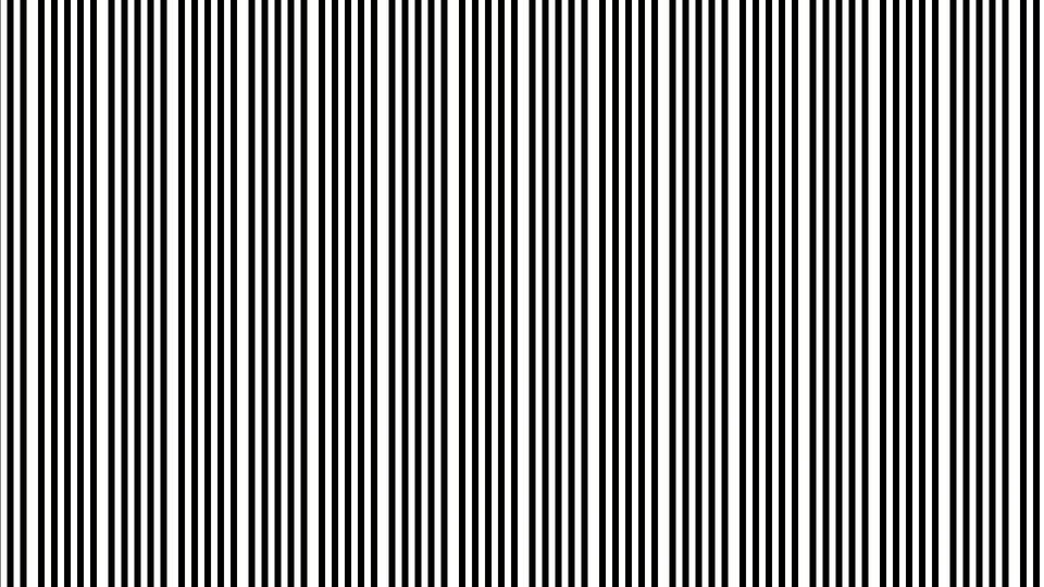

Moire hero image
Moire overlaying sinusoidal interference rings on a live video input, creating luminous rippling textures from two rotating grid layers.
Moire generates smooth sinusoidal interference patterns by superimposing two independently configurable grid layers: circles, ellipses, arcs, and sine waves: and blending the result with an incoming video signal. The two grids each have adjustable pitch and rotation angle. Where their periodic structures overlap, the characteristic moiré fringes emerge: sweeping curves, pulsing rings, and shimmering corridors of light that shift dramatically with even small parameter changes.
Moire produces pure grayscale patterns in its synthesis path and crossfades them with the input video through the Mix fader. At full mix, Moire acts as a standalone pattern synthesizer. At partial mix, the interference texture overlays the source footage, adding rhythmic structure and luminous depth. With the Video Mod control engaged, the input video’s brightness bends the spacing of Grid B, locking the moiré fringes to the image content.
Even tiny adjustments to Pitch or Angle create dramatic changes in moiré patterns. Move the knobs slowly (the interference fringes sweep and reshape in real time.)

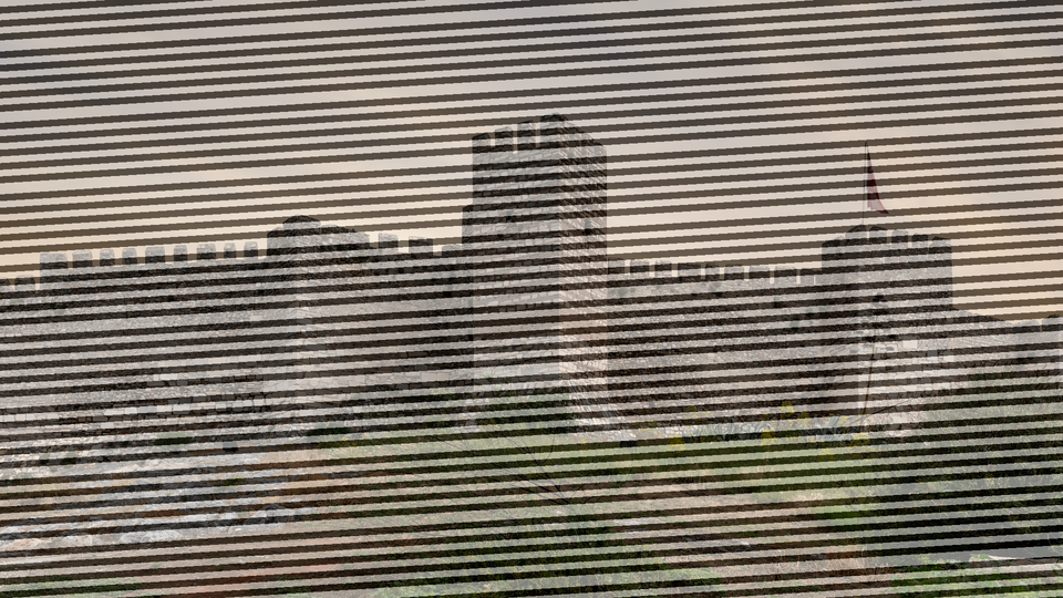

Exercise 1: Beat Frequency Fringes
Beat Frequency Fringes result
Beat Frequency Fringes — simulated result across source images.
Exercise Illustration
Learning Outcomes
Discover how small pitch differences between the two grids create large-scale moiré fringes.
Key Concepts
  • Moiré fringes emerge from the frequency difference between two grids
  • Close pitch values → broad fringes; distant values → fine fringes
  • Angle offset determines fringe curvature
Video Source
Any video input, or no input with Mix fully clockwise.
Steps
  1. Match the grids: Set Pitch A (Knob 1) and Pitch B (Knob 4) to the same step. The two grids cancel almost perfectly, producing a nearly uniform field.
  2. Offset one step: Move Pitch B one step clockwise. Bold, sweeping moiré fringes appear (these are the beat frequency between the two grids.)
  3. Add angle: Slowly rotate Angle A (Knob 2) away from zero. The straight fringes curve into arcs and hyperbolic shapes.
  4. Widen the gap: Move Pitch B farther from Pitch A. The fringes become finer and more numerous as the frequency difference increases.
  5. Try Fine: Enable Fine (Switch 11) to double both frequencies. The overall ring density increases, but the pitch ratio stays the same, so the moiré fringe spacing is preserved.
Settings
Control Value
Pitch A
Step 3 (~8 px)
Angle A
Video Mod
0%
Pitch B
Step 4 (~12 px)
Angle B
Anim Speed
0%
Grid A
Sine
Grid B
Circles
Combine A
Multiply
Combine B
Diff
Fine
Off
Mix
100%

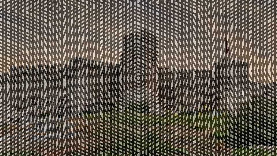

Exercise 2: Animated Ellipses and Arcs
Animated Ellipses and Arcs result
Animated Ellipses and Arcs — simulated result across source images.
Learning Outcomes
Layer different geometric shapes and add animation drift.
Key Concepts
  • Ellipses stretch the Y axis before distance computation
  • Arcs use a cosine fade to clip circles to a hemisphere
  • Animation drift smoothly shifts the phase of both grids
Video Source
A static image or test pattern with strong horizontal and vertical features.
Steps
  1. Elliptical Grid A: Set Grid A to Ellipse (Switch 7). The concentric rings flatten into ovals, changing the fringe topology.
  2. Arc Grid B: Set Grid B to Arcs (Switch 8). The lower half of Grid B’s circles fades smoothly away, leaving semicircular arcs that interact asymmetrically with Grid A’s ellipses.
  3. Angle both grids: Set Angle A to about 45° and Angle B to about 120°. The tilted ellipses and arcs produce complex, non-repeating fringe corridors.
  4. Animate: Increase Anim Speed (Knob 6) to about 30%. The rings pulse outward and the moiré fringes glide slowly across the frame.
  5. Try Additive: Set Combine A to Add (Switch 9). The fringes brighten and the overall texture becomes more luminous.
Settings
Control Value
Pitch A
Step 4 (~12 px)
Angle A
~45°
Video Mod
0%
Pitch B
Step 5 (~16 px)
Angle B
~120°
Anim Speed
~30%
Grid A
Ellipse
Grid B
Arcs
Combine A
Add
Combine B
Diff
Fine
Off
Mix
100%

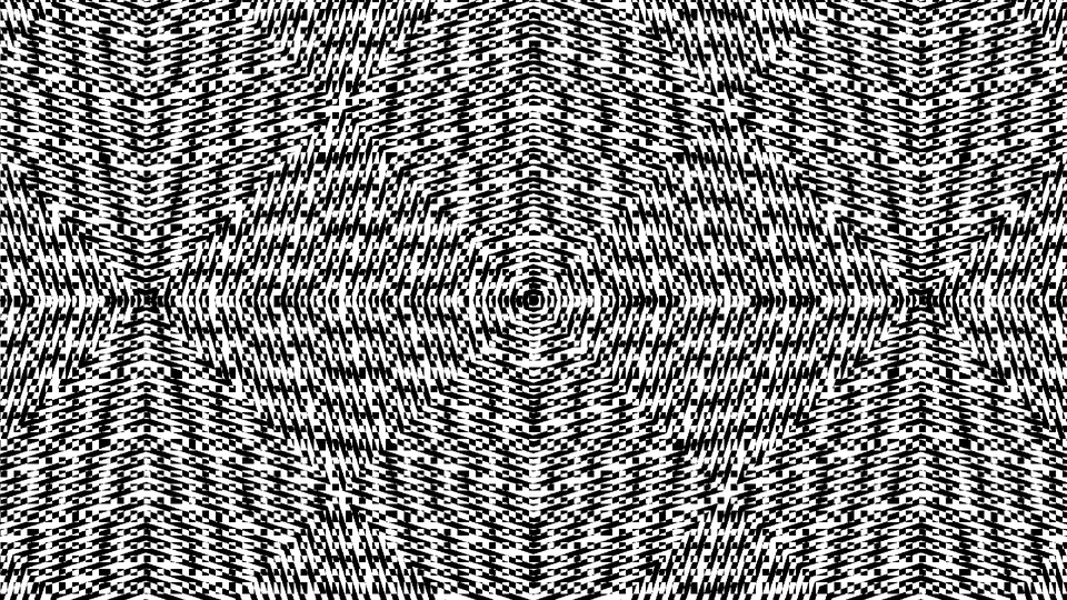

Exercise 3: Video-Modulated Moiré
Video-Modulated Moiré result
Video-Modulated Moiré — simulated result across source images.
Learning Outcomes
Use the input video to warp the moiré pattern, creating content-reactive interference textures.
Key Concepts
  • Video Mod offsets Grid B’s coordinates based on input luminance
  • Grid A stays fixed while Grid B warps, so fringes track image content
  • Mix blends the moiré synthesis over the original video
Video Source
Live camera footage or recorded video with varied brightness (faces, landscapes, or objects with strong tonal contrast.)
Steps
  1. Establish a base pattern: Set both pitches to neighboring steps with a moderate angle offset. Verify that a clear moiré fringe pattern is visible.
  2. Engage video modulation: Slowly increase Video Mod (Knob 3) from 0%. Grid B’s rings distort and follow the bright areas of the video.
  3. Blend: Pull Mix (Fader 12) to about 50%. The moiré texture overlays the source video, with the interference fringes bending around bright objects.
  4. Try all combine modes: Cycle through the four combination modes (Switches 9 and 10) while Video Mod is active. Each mode reacts differently to the video-driven distortion.
  5. Add animation: Set Anim Speed to about 20%. The video-locked fringes drift slowly, creating a shimmering, alive texture over the source image.
Settings
Control Value
Pitch A
Step 2 (~6 px)
Angle A
~30°
Video Mod
~75%
Pitch B
Step 3 (~8 px)
Angle B
~90°
Anim Speed
~20%
Grid A
Ellipse
Grid B
Circles
Combine A
Multiply
Combine B
Min
Fine
Off
Mix
~50%
