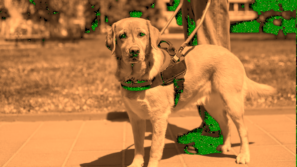

Exercise 1: Autonomous Pattern Growth
Autonomous Pattern Growth — simulated result across source images.
Exercise Illustration
Learning Outcomes
Observe how Feed Rate and Kill Rate interact to produce different pattern types without any input video.
Key Concepts
Gray-Scott parameters F and k define pattern morphology
The Pattern toggle changes diffusion ratios for spots vs. stripes
Species evolve autonomously from sparse LFSR noise seeding
Steps
Watch emergence: Start with all defaults. Observe patterns emerging from the noise floor (sparse spots or stripes gradually appear and grow.)
Increase growth rate: Slowly increase Feed Rate (Knob 1) while keeping Kill Rate (Knob 2) steady. Watch patterns grow denser and more active.
Finer turbulence: Now slowly increase Kill Rate. The patterns become finer and more turbulent as the inhibitor drains faster.
Spots vs stripes: Toggle Pattern (Switch 9) between Spots and Stripes. In Spots mode, isolated circular features dominate. In Stripes mode, patterns connect into labyrinthine networks.
Freeze the moment: Toggle Freeze (Switch 7) to halt the simulation. Study the frozen pattern structure. Unfreeze to resume.

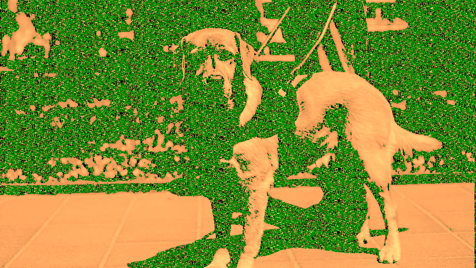

Exercise 2: Video-Seeded Growth
Video-Seeded Growth — simulated result across source images.
Learning Outcomes
Use input video luminance to control where reaction-diffusion patterns emerge.
Key Concepts
Input luminance seeds inhibitor injection above a threshold
Seed Thresh controls how much of the input image triggers growth
One-Shot mode produces localized bursts vs. Continuous distributed seeding
Steps
Connect a source: Connect a video source showing a recognizable subject with varied brightness.
Seed from brightness: Increase Seed Thresh (Knob 4) until patterns begin appearing where the input video is bright. Growth follows the bright contours of the input image.
Single-burst seeding: Switch Seed Mode (Switch 8) to One-Shot. Notice how seeding becomes a single burst per frame rather than continuous injection (patterns grow outward from a single seed point.)
Flood the threshold: Switch back to Cont. and slowly raise Seed Thresh further. Progressively dimmer areas begin producing growth. At high values, nearly the entire image seeds the simulation.
Overlay on source: Adjust Mix (Fader 12) to blend the synthesized pattern over the original input video.

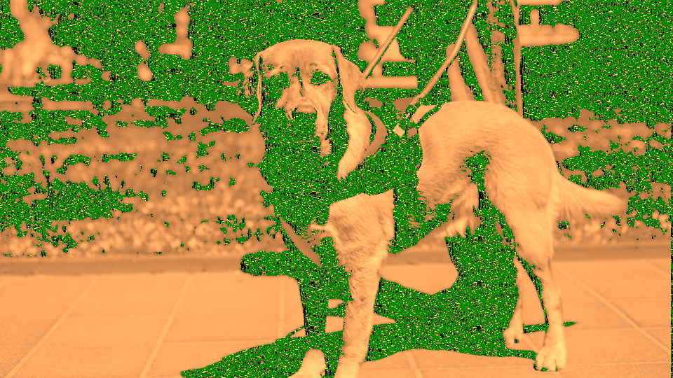

Exercise 3: Network Memory Visualization
Network Memory Visualization — simulated result across source images.
Learning Outcomes
Explore the network species (W) and how Invert, Turbo, and Sim Speed reveal the simulation’s history.
Key Concepts
The W species accumulates a persistent map of past growth
Invert toggle switches between active fronts and network history
Sim Speed controls how quickly the network fades
Steps
Grow the network: Set moderate Feed Rate and Kill Rate to produce active patterns. Let the simulation run for several seconds to build up network history.
Reveal the web: Toggle Invert (Switch 10) to On. The display now emphasizes W: the persistent strand network rather than the active growth fronts. The luminous web shows everywhere growth has been.
Tune persistence: Adjust Sim Speed (Knob 6). At low values, the network persists for a long time, building up a dense historical map. At high values, the network fades quickly, showing only recent growth.
Photographic negative: Enable Turbo (Switch 11). All three species invert: dark background becomes bright, bright patterns become dark. Combined with different Color Map palettes, this produces dramatic visual shifts.
Palette exploration: Sweep Color Map (Knob 5) through all eight palettes while in Web mode with Turbo enabled.
