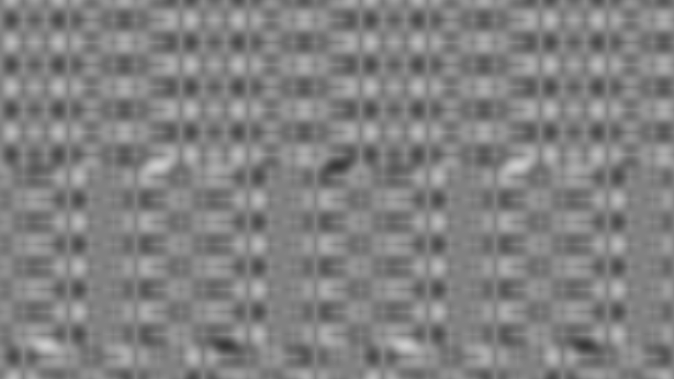

Exercise 1: Scrolling Marble Terrain
Scrolling Marble Terrain result
Scrolling Marble Terrain — simulated result across source images.
Exercise Illustration
Learning Outcomes
Understand the relationship between scale, scroll, and the raw noise field.
Key Concepts
  • Gradient noise is an infinite, seamless procedural pattern
  • Scale controls lattice cell size
  • Scroll velocity sweeps through the infinite noise space
Steps
  1. Set the zoom: Set Scale (Knob 2) to step 3 or 4. You should see a gentle marble-like pattern of light and dark bands.
  2. Hold position: Centre Scroll X (Knob 1) and Scroll Y (Knob 3) so the pattern is stationary.
  3. Horizontal drift: Slowly turn Scroll X clockwise. The landscape drifts horizontally. Return to centre to stop.
  4. Diagonal motion: Now combine both: set Scroll X and Scroll Y slightly off-centre for slow diagonal motion through the noise field.
  5. Zoom through scales: Sweep Scale through all 8 steps while scrolling. Zooming in reveals a different scale of the same infinite texture.
Settings
Control Value
Scroll X
~60%
Scale
4
Scroll Y
~55%
Warp
0%
Palette Shift
0%
Palette Speed
0%
Texture
Gradient
Palette
A
Color
Warm
Video
Noise
Octave
1x
Mix
100%

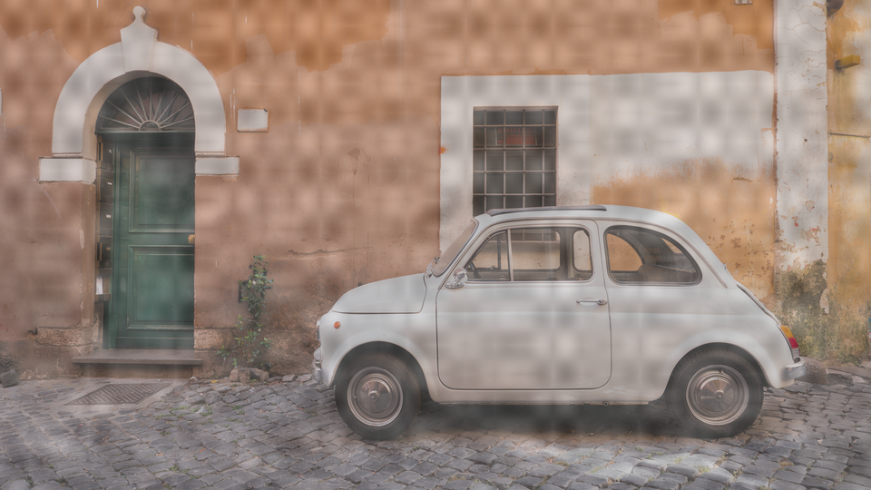

Exercise 2: Colour Palettes and Animation
Colour Palettes and Animation result
Colour Palettes and Animation — simulated result across source images.
Learning Outcomes
Explore all four palettes and their animated cycling behaviour.
Key Concepts
  • Palette BRAM maps monochrome noise to full-colour YUV
  • Palette Shift rotates the colour mapping statically
  • Palette Speed animates the cycling via a DDS accumulator
Steps
  1. Stop scrolling: Start from the Exercise 1 settings, but stop scrolling (centre Knobs 1 and 3).
  2. Cycle all palettes: Flip Palette (Switch 8) and Color (Switch 9) to cycle through all four combinations: Marble, Fire, Ocean, Neon. Notice how each completely re-colours the same noise field.
  3. Rotate the palette: Slowly increase Palette Shift (Knob 5). The colour bands rotate through the palette (dark areas become coloured, coloured areas shift hue.)
  4. Animate the colours: Now increase Palette Speed (Knob 6) to a low value. The colours begin cycling automatically, creating an animated lava-lamp effect.
  5. Sharp ridge contours: Enable Ridged mode with Texture (Switch 7). The smooth colours develop sharp contour lines (ridged noise creates dramatic palette boundaries.)
Settings
Control Value
Scroll X
0%
Scale
4
Scroll Y
0%
Warp
0%
Palette Shift
~40%
Palette Speed
~25%
Texture
Ridged
Palette
B
Color
Cool
Video
Noise
Octave
1x
Mix
100%
