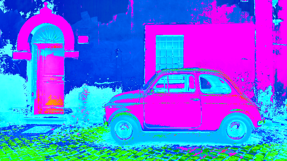

Pinwheel remapping a portrait’s color spectrum through luminance-driven hue rotation, spinning warm tones into cool and back again.
Pinwheel is a color transformation program that rotates the hue of each pixel based on its brightness. At its heart is a true vector rotation in the UV color plane, performed per pixel in real time using a hardware sine/cosine lookup table and a 2×2 matrix multiplier. The rotation angle is computed from a combination of a fixed hue offset and a luminance-dependent modulation term. The result is a "color pinwheel": brighter and darker parts of the image spin to different positions on the color wheel, creating vivid, content-adaptive color remapping.
Beyond hue rotation, Pinwheel includes saturation and brightness controls, a colorize mode that replaces the input color with pure hue-shifted tone, and a bit-level crush stage that can posterize or glitch the output. These layers combine to produce effects ranging from subtle color grading to aggressive digital color destruction.
The signature effect is luminance-driven hue rotation. Turn up Luma to Hue (Knob 4): different brightness regions of the image shift to entirely different colors. This is what makes Pinwheel unique: it’s not a uniform color shift, it’s a content-adaptive one.

  1. Turn Hue (Knob 1) slowly from left to right. The entire image shifts through the color spectrum: reds become greens, greens become blues, and so on. This is a uniform hue rotation.
  2. Now increase Luma to Hue (Knob 4) to about 75%. Bright and dark areas of the image now have different hues. The image’s tonal range fans out across the color wheel.
  3. Increase Saturation (Knob 2) past halfway. Colors become more vivid as the chroma scaling boosts the UV components after rotation.
  4. Toggle Colorize (Switch 7) to On. The input color is stripped away, and pure hue-rotated tone is applied. The image becomes a monochrome-to-color map, with brightness determining the hue.

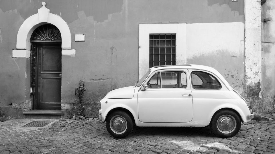

Video Source
A color bar pattern or any footage with a range of distinct, saturated colors.
Steps
  1. Neutral starting point: Set all controls to their defaults (midpoint). Ensure Luma to Hue (Knob 4) is at 0% so there is no content-dependent modulation.
  2. Sweep the spectrum: Slowly sweep Hue (Knob 1) from −180° to +180°. The entire image’s palette rotates through the spectrum. Reds become greens, greens become blues, blues become reds.

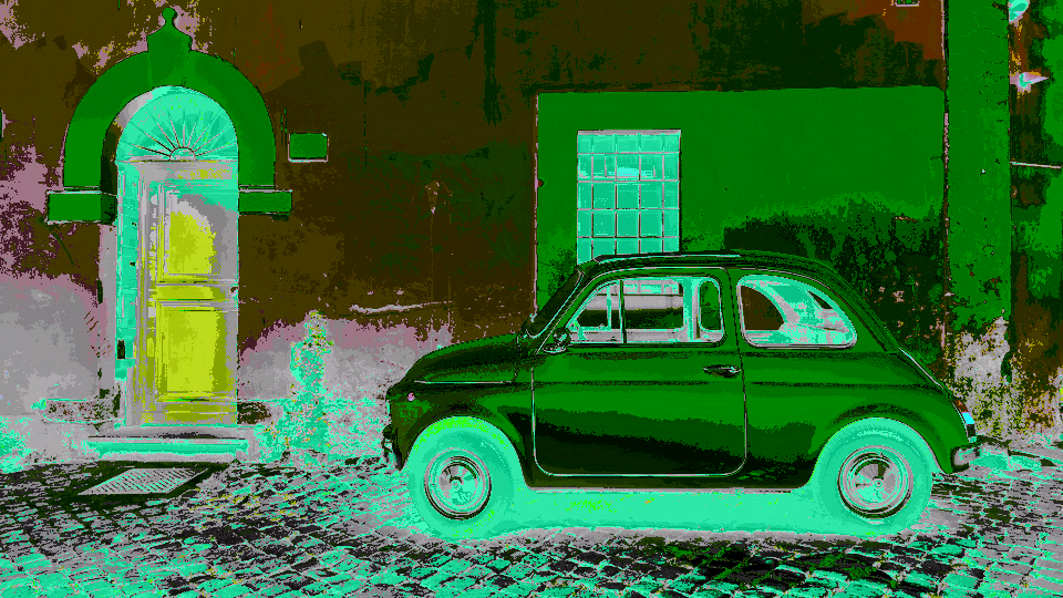

Exercise 3: Crushed Color Glitch
Crushed Color Glitch result
Crushed Color Glitch — simulated result across source images.
Exercise Illustration
Learning Outcomes
Combine hue rotation with bit-level crushing to create abstract digital color textures.
Key Concepts
  • Bit-crushing reduces or scrambles color information at the bit level
  • Glitch mode (XOR) creates unpredictable value mapping
  • Luma and chroma crush are independent
Video Source
Any footage, especially material with a mix of bright and dark regions.
Steps
  1. Rainbow baseline: Start with Exercise 2’s luminance rainbow settings (Luma to Hue at ~80%, Colorize on).
  2. Crush the luma: Reduce Posterize (Knob 5) to about 40%. The luminance collapses into visible banding (flat steps of brightness replace smooth gradients.)
  3. Reduce color depth: Reduce Chroma Crush (Fader 12) to about 50%. The vivid rainbow palette snaps to a reduced set of colors.
  4. Engage glitch mode: Toggle Crush Mode (Switch 10) to Glitch. The orderly banding explodes into chaotic digital texture as AND masking switches to XOR scrambling.
  5. Inversion combos: Toggle Luma Invert (Switch 8) and Chroma Invert (Switch 9) to see how inversion interacts with the XOR crush. Each combination produces a different scrambled palette.
  6. Explore destruction: Sweep Posterize and Chroma Crush slowly to explore the full range of digital destruction.
