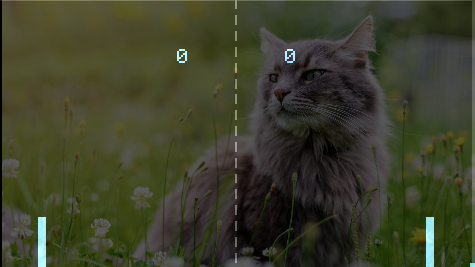

Exercise 1: Your First Rally
Your First Rally result
Your First Rally — simulated result across source images.
Exercise Illustration
Learning Outcomes
Learn the basic controls and play a game against the AI.
Key Concepts
  • Paddle position is directly controlled by the knob
  • Ball speed affects difficulty
  • AI skill determines how beatable the opponent is
Steps
  1. Default setup: Ensure P2 Mode (Switch 7) is set to AI and all other toggles are at defaults.
  2. Set ball speed: Turn Ball Spd (Knob 1) to about 40%. The ball should move at a moderate pace.
  3. Easy opponent: Set AI Skill (Knob 4) to about 30% (a beatable opponent.)
  4. Play the ball: Use P1 Pos (Knob 3) to move your paddle. Try to intercept the ball before it passes. Notice how the bounce angle changes depending on where the ball hits your paddle.
  5. Full match: Play until the score resets (one player reaches 9). Gradually increase AI Skill to challenge yourself.

Exercise 2: Neon Overlay
Neon Overlay result
Neon Overlay — simulated result across source images.
Learning Outcomes
Blend the Pong court with input video to create a colorful overlay effect.
Key Concepts
  • The Mix fader blends synthesized graphics with pass-through video
  • Color mode tints game objects with a selectable hue
  • Brightness and mix interact to control overlay visibility
Steps
  1. Connect video: Feed a video source into Videomancer’s input.
  2. Choose court hue: Flip Color (Switch 10) to Hue and set Court Hue (Knob 5) to taste (a warm orange or cool blue works well.)
  3. Boost brightness: Set Bright (Knob 6) to about 90% for vivid game objects.
  4. Blend overlay: Pull the Mix fader (Fader 12) down to about 60%. The Pong court should overlay your input video as a semi-transparent layer.
  5. Clean the display: Disable Net (Switch 8) and Score (Switch 9) for a cleaner overlay, or leave them on for the full retro aesthetic.
  6. Play over video: Play the game while watching the ball and paddles float over your video source.
