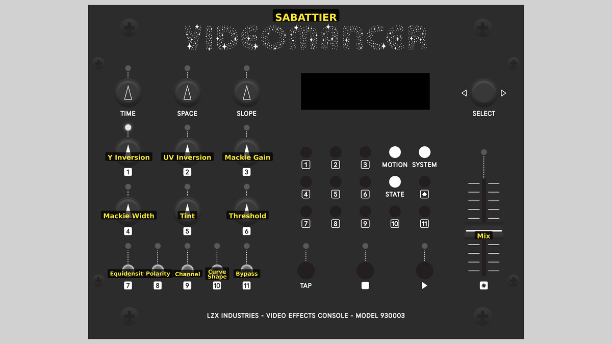

Videomancer front panel with Sabattier loaded
Videomancer’s front panel with Sabattier active. Knobs 1–6 (top two rows of left cluster), Toggle switches 7–11 (bottom row of left cluster), Fader 12 (right side).

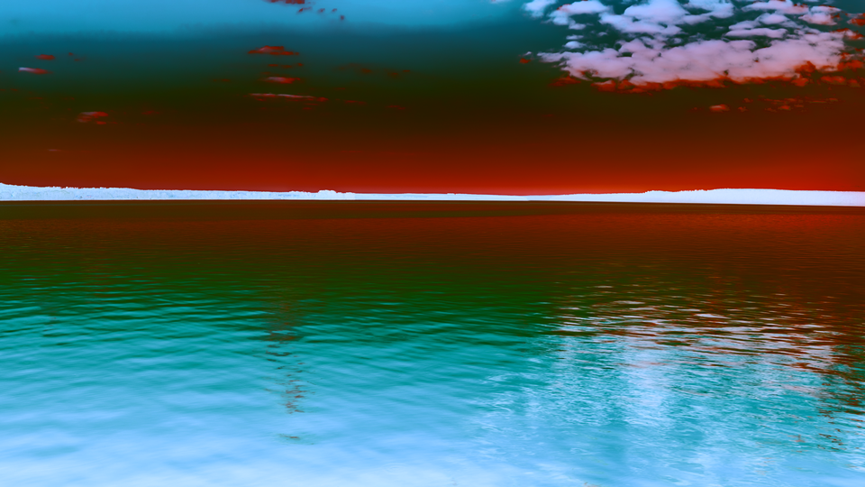

Exercise 1: Classic Sabattier
Classic Sabattier result
Classic Sabattier — simulated result across source images.

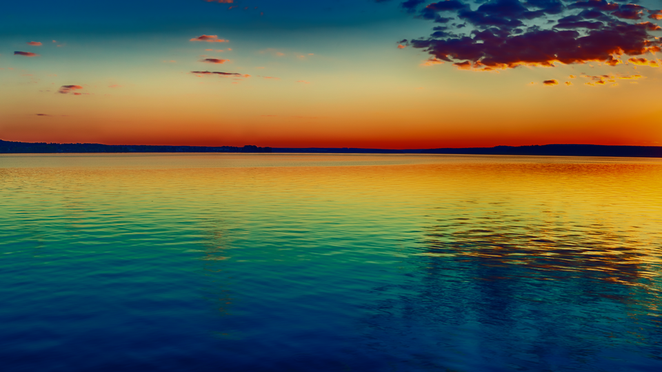

Exercise 2: Mackie Line Portraits
Mackie Line Portraits result
Mackie Line Portraits — simulated result across source images.

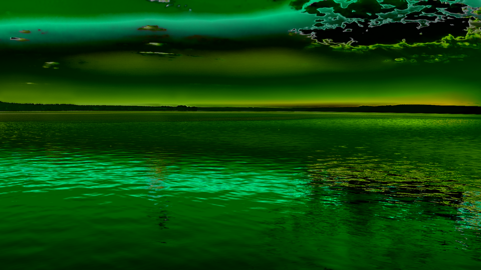

Exercise 3: Equidensity Contour Map
Equidensity Contour Map result
Equidensity Contour Map — simulated result across source images.
