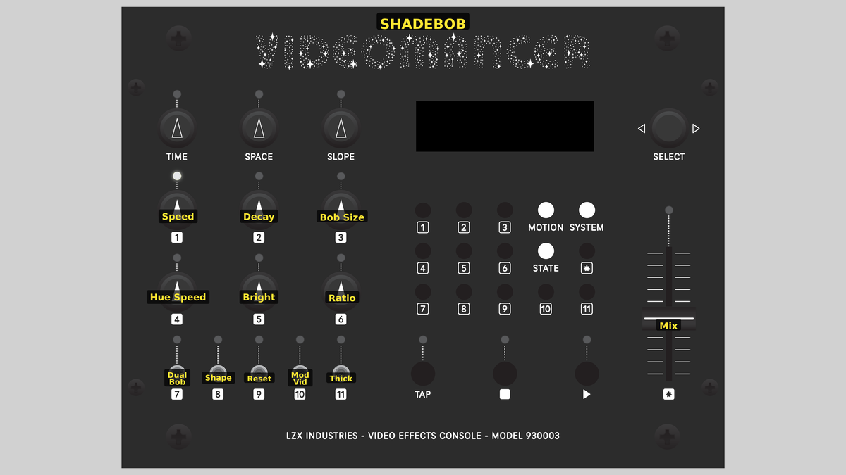

Videomancer front panel with Shadebob loaded
Videomancer’s front panel with Shadebob active. Knobs 1–6 (top two rows of left cluster), Toggle switches 7–11 (bottom row of left cluster), Fader 12 (right side).
