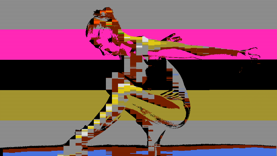

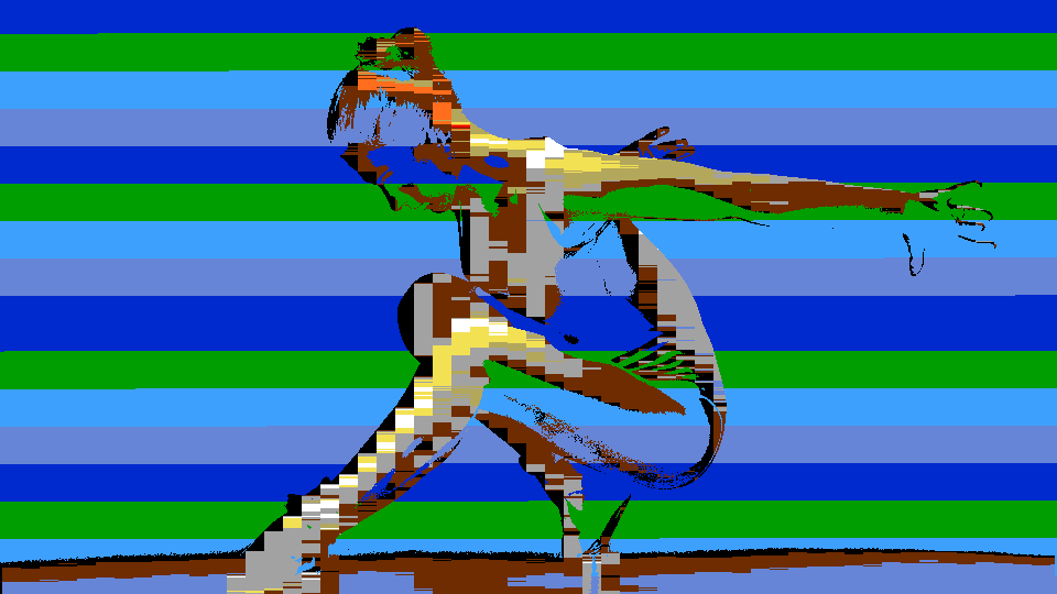

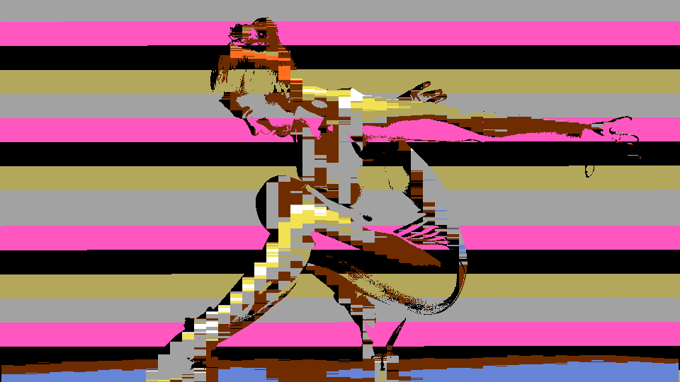

Exercise 1: Color Stack Cycling
Color Stack Cycling result
Color Stack Cycling — simulated result across source images.
Exercise Illustration
Learning Outcomes
Learn how the Color Stack background animation interacts with the foreground palette quantization.
Key Concepts
  • The Color Stack cycles four palette entries spaced evenly from the base hue
  • Stack Rate controls the speed of cycling across tiles
  • Threshold splits each tile into foreground (palette match) and background (stack color)
Video Source
A live camera feed or recorded footage with a mix of bright and dark regions.
Steps
  1. Set tile grid: Set Tile Size (Knob 1) to about 50% for medium-sized tiles. The image is immediately quantized to the 16-color palette.
  2. Cycle background hue: Turn Stack Hue (Knob 2) slowly through the full range. Background colors cycle through the complete Intellivision palette.
  3. Reveal the stack: Set Threshold (Knob 5) to about 40%. Dark regions of the image now show the Color Stack background instead of the palette-matched color.
  4. Animate the stack: Increase Stack Rate (Knob 3) from 0% toward maximum. The background pattern begins shimmering as the stack advances faster across tiles.
  5. Denser texture: Adjust Tile Size smaller. The denser tile grid makes the Color Stack cycling more visible as a fine animated texture.

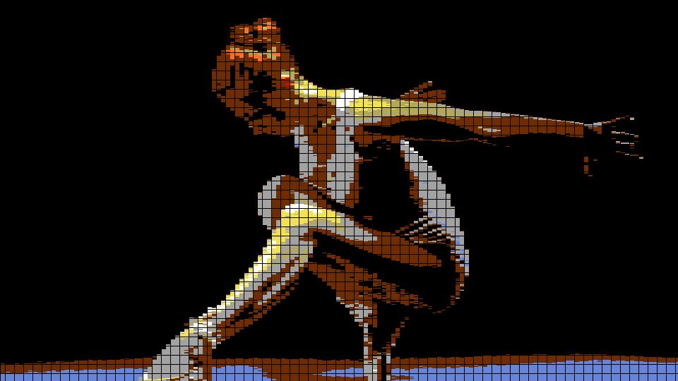

Exercise 2: Colored Squares Mosaic
Colored Squares Mosaic result
Colored Squares Mosaic — simulated result across source images.
Learning Outcomes
Explore Colored Squares mode and the grid overlay to create dense, blocky retro mosaics.
Key Concepts
  • Colored Squares subdivides each tile into four independently quantized quadrants
  • Grid overlay makes tile boundaries explicit
  • Saturation and Brightness shape the palette appearance
Video Source
Footage with varied colors and moderate contrast: nature scenes, painted surfaces, or abstract patterns work well.
Steps
  1. Quad subdivide: Switch Mode (Switch 7) to ClrSqrs. Each tile now shows four independent color blocks instead of one.
  2. Show tile grid: Enable Grid (Switch 8). Dark lines appear at every tile boundary, giving the image a graph-paper quality.
  3. Shrink the tiles: Reduce Tile Size (Knob 1) to about 30%. The quadrants become smaller and denser, revealing more of the source image’s color structure through the palette.
  4. Vivid palette: Push Saturation (Knob 4) fully clockwise. The palette colors become vivid and oversaturated (pure retro gameplay aesthetic.)
  5. Maximize foreground: Lower Threshold (Knob 5) toward 0% so nearly all pixels are palette-matched foreground, maximizing the Colored Squares mosaic.
