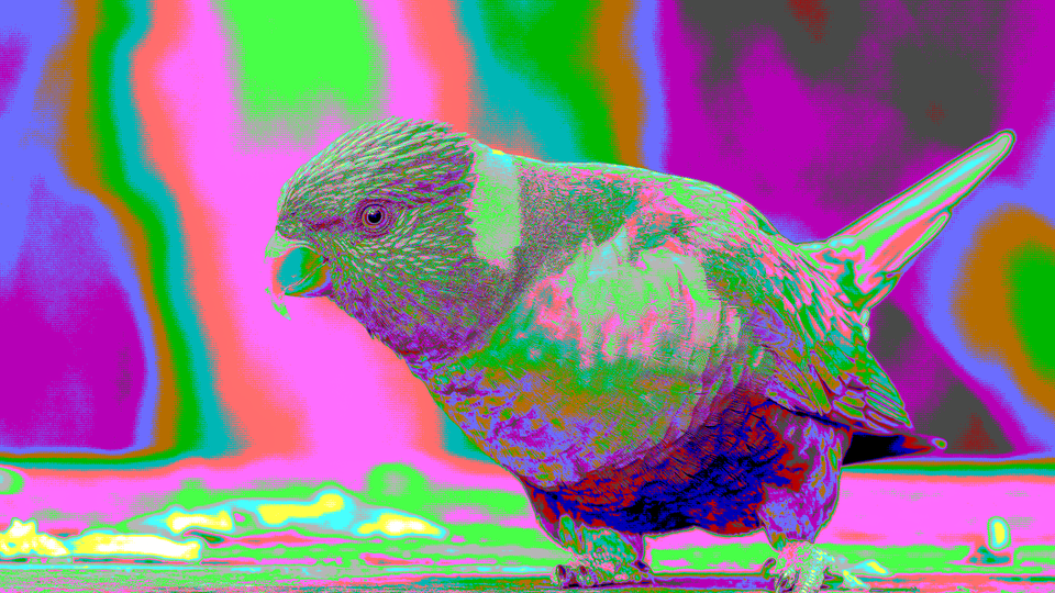

Exercise 2: Macintosh Halftone
Macintosh Halftone result
Macintosh Halftone — simulated result across source images.
Exercise Illustration
Learning Outcomes
Use dithering to create the maximum number of apparent shades from only two colors.
Key Concepts
  • Smaller palettes benefit most from dithering
  • Dither size determines how many apparent gray levels are possible
  • Noise versus Bayer dithering produces drastically different textures
Video Source
A grayscale image or footage of an evenly lit scene with smooth tonal gradations (skies, fabric, gradients).
Steps
  1. Select palette: Set Palette (Knob 1) to position 2 (Macintosh). The image becomes pure black and white with no intermediate tones.
  2. Start small: Set Dither Size (Knob 2) to the 2×2 position. A coarse checkerboard pattern introduces one apparent gray level between black and white.
  3. Increase resolution: Step through Dither Size positions. At 4×4, more intermediate tones appear. At 8×8, the stipple pattern becomes fine enough to suggest smooth gradients.
  4. Dither strength: Sweep Dither Amt (Knob 3) from 0 to 100%. At low amounts, the pattern barely appears. At high amounts, it dominates the image.
  5. Switch algorithms: Toggle Dither Mode (Switch 9) from Bayer to Noise. The geometric stipple grid transforms into a random grain. Compare the two: ordered dithering is structured and mechanical; noise dithering is organic and film-like.
  6. Contrast: Increase Contrast (Knob 5) to push more pixels toward pure black or white, reducing the dithered mid-tone area.
Settings
Control Value
Palette
2 (Macintosh)
Dither Size
3 (8×8)
Dither Amt
70%
Brightness
50%
Contrast
60%
Saturation
50%
Pixel Dbl
Off
Scanlines
Off
Dither Mode
Bayer
Invert
Off
Dith Phase
Off
Mix
100%

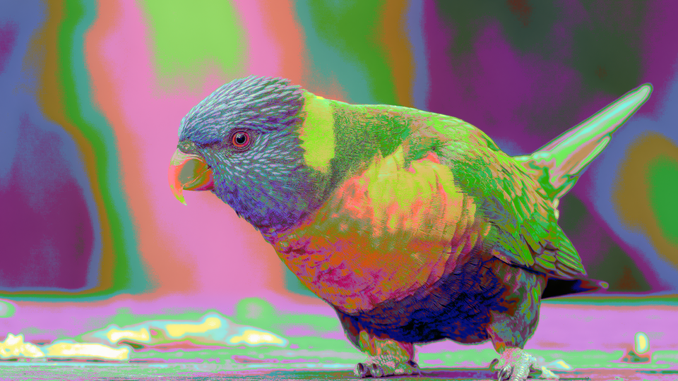

Exercise 3: CRT Television Emulation
CRT Television Emulation result
CRT Television Emulation — simulated result across source images.
Learning Outcomes
Combine palette quantization with display emulation for a full retro broadcast look.
Key Concepts
  • Pixel doubling and scanlines together simulate low-resolution CRT output
  • Saturation control adjusts the vividness of palette colors beyond their historical values
  • Mix allows blending the retro effect for subtlety
Video Source
Footage with bold colors and motion: cartoons, music performances, or colorful abstract video work well.
Steps
  1. Select palette: Set Palette (Knob 1) to position 6 (Amiga OCS) for a rich 16-color palette.
  2. Enable dithering: Set Dither Size to 4×4 and Dither Amt to about 50%.
  3. Boost color: Turn Saturation (Knob 6) fully clockwise for oversaturated, vivid palette colors.
  4. Display emulation: Enable both Pixel Dbl (Switch 7) and Scanlines (Switch 8).
  5. Fine tune: Adjust Contrast (Knob 5) to about 65% for punchy, saturated blocks. Adjust Brightness (Knob 4) to taste.
  6. Blend: Pull the Mix fader (Fader 12) to about 70% to let some of the original image bleed through the palette restriction. The result is a subtle retro color cast rather than hard quantization.
  7. Invert: Toggle Invert (Switch 10) to produce a negative-image version through the Amiga palette (an effect that has no historical equivalent.)
Settings
Control Value
Palette
6 (Amiga OCS)
Dither Size
2 (4×4)
Dither Amt
~50%
Brightness
50%
Contrast
~65%
Saturation
100%
Pixel Dbl
On
Scanlines
On
Dither Mode
Bayer
Invert
Off
Dith Phase
Off
Mix
~70%
