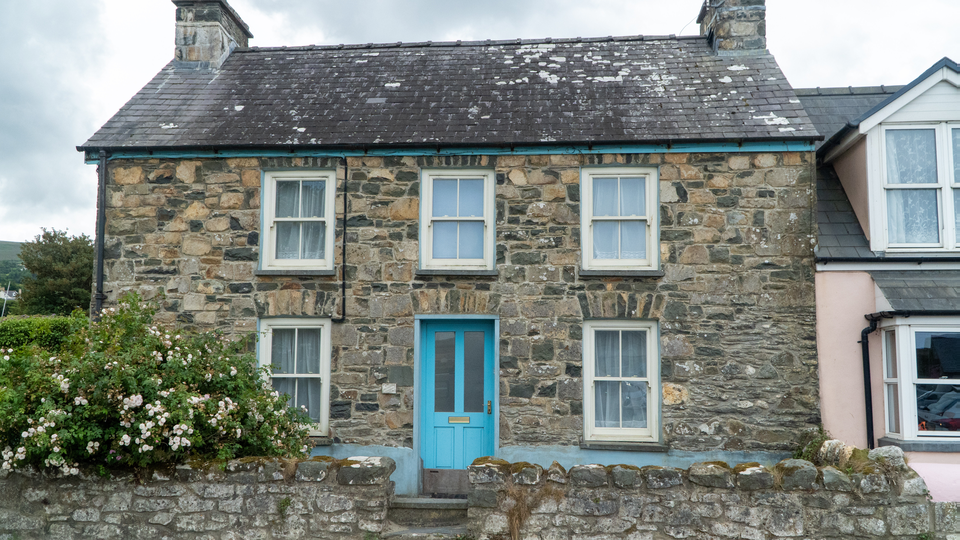

YUV Amplifier hero image
YUV Amplifier shaping independent gain, offset, and inversion across all three video channels to transform color and contrast in real time.
YUV Amplifier is a fundamental color processing tool for Videomancer. It provides independent gain (contrast) and offset (brightness) controls for each of the three YUV channels, along with per-channel inversion and a global fade control. If you think of your video signal as three separate streams of information: one for brightness and two for color: YUV Amplifier gives you a full set of knobs to shape each stream independently.
At default settings, the signal passes through unchanged. Small adjustments produce subtle color grading: warming or cooling the image, boosting contrast, or shifting the overall brightness. Larger adjustments push the image into bold, stylized territory: saturated hues, solarized tones, and inverted color fields. The fade control lets you blend any processed result smoothly toward black or white.
YUV Amplifier is a workhorse utility. Place it anywhere in a signal chain to fine-tune color balance, correct levels, or create dramatic color shifts before or after other effects.

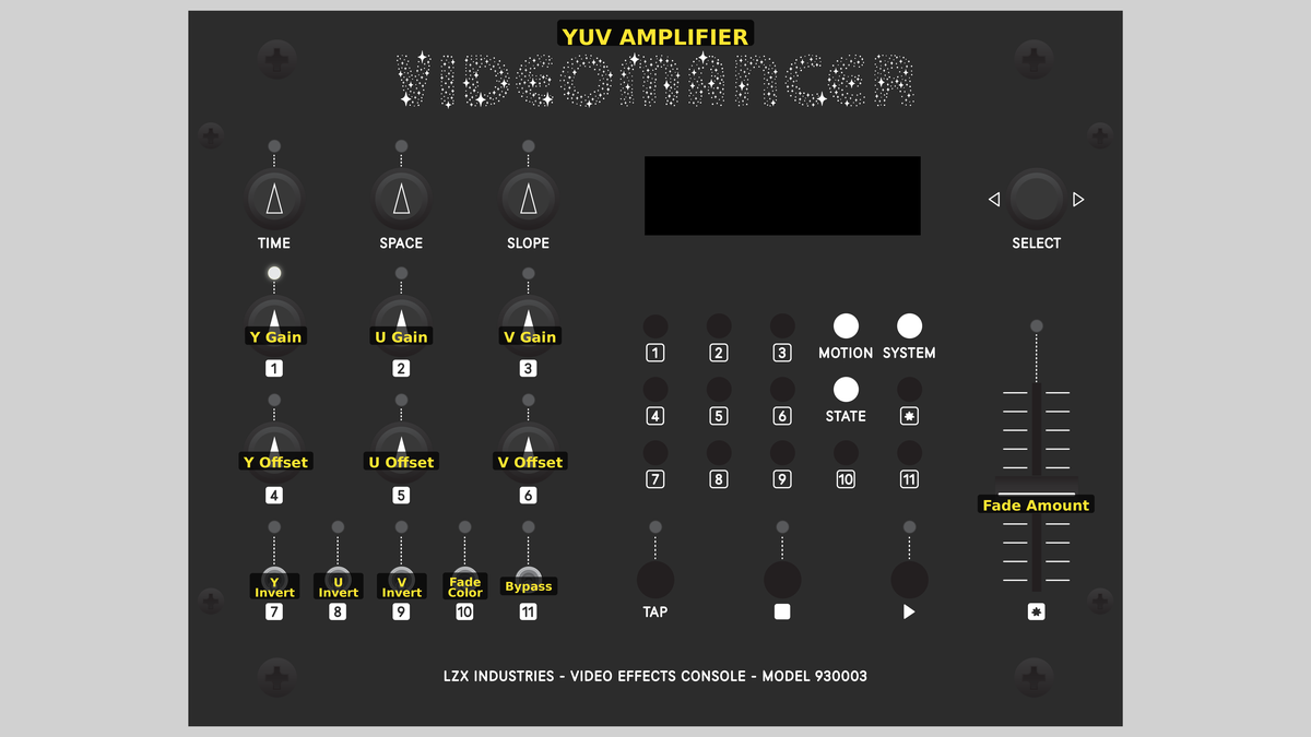

Videomancer front panel with YUV Amplifier loaded
Videomancer’s front panel with YUV Amplifier active. Knobs 1–6 (top two rows of left cluster), Toggle switches 7–11 (bottom row of left cluster), Fader 12 (right side).
Knob 1 — Y Gain
Property Value
Range
0.0% – 200.0%
Default
100.1%
Y Gain controls the contrast of the luminance channel. It maps to the contrast input of the Y proc amp. At 0%, fully counterclockwise, all luminance detail is crushed to the offset value: the image becomes a flat field. At the default position of 100%, the signal passes with unity gain. Turning clockwise toward 200% doubles the contrast, pushing midtones apart and driving highlights and shadows toward their extremes. High gain values can clip the signal, producing hard white and black regions.
Gain is applied as multiplication around the midpoint (512). Values above midpoint are pushed higher; values below are pushed lower. The formula is: (input − 512) × gain / 512 + offset.
Knob 2 — U Gain
Property Value
Range
0.0% – 200.0%
Default
100.1%
U Gain controls the contrast of the blue-difference chrominance channel. At 0%, the U channel collapses to its offset value, removing all blue-yellow color variation. At the default of 100%, the original color balance is preserved. Increasing toward 200% boosts blue-yellow saturation, making blues more vivid and yellows more intense. Because U and V are independent, you can boost blue saturation without affecting red-green tones.
Knob 3 — V Gain
Property Value
Range
0.0% – 200.0%
Default
100.1%
V Gain controls the contrast of the red-difference chrominance channel. It behaves identically to U Gain but operates on the red-green axis. At 0%, red-green color differences vanish. At 100%, the image is unchanged. At 200%, reds and cyans become intensely saturated. Reducing V Gain while keeping U Gain high shifts the palette toward blue and yellow, suppressing reds and greens.
Setting both U Gain and V Gain to 0% while keeping Y Gain at 100% produces a clean monochrome image (all color is removed, leaving only luminance.)
Knob 4 — Y Offset
Property Value
Range
-100.0% – 100.0%
Default
0.1%
Y Offset shifts the overall brightness of the luminance channel. It maps to the brightness input of the Y proc amp. At the default of 0%, no offset is applied. Turning counterclockwise toward −100% darkens the entire image. Turning clockwise toward +100% brightens the entire image. Unlike gain, offset shifts all values uniformly: darks and lights move together. Combined with high Y Gain, offset can reposition the tonal range to expose shadow detail or recover highlights.
Knob 5 — U Offset
Property Value
Range
-100.0% – 100.0%
Default
0.1%
U Offset shifts the blue-difference chrominance channel. At the default of 0%, the color balance is neutral. Positive values push the image toward blue; negative values push it toward yellow. This is a global color temperature adjustment on the blue-yellow axis. Small offsets produce subtle warming or cooling effects; large offsets create strong color casts.
Knob 6 — V Offset
Property Value
Range
-100.0% – 100.0%
Default
0.1%
V Offset shifts the red-difference chrominance channel. At the default of 0%, the color balance is neutral. Positive values push the image toward red and magenta; negative values push it toward green and cyan. Combined with U Offset, you can target any hue: positive U and positive V yields magenta, negative U and positive V yields red, and so on.
Adjusting U Offset and V Offset together is equivalent to a white balance correction. Small shifts can compensate for the color temperature of a light source, matching the look between different cameras or scenes.
Switch 7 — Y Invert
Property Value
Off
Off
On
On
Default
Off
Y Invert flips the luminance channel by applying a bitwise complement. When set to On, every pixel’s brightness is reversed: black becomes white and white becomes black, producing a photographic negative effect on the luminance. Inversion is the first processing step: it happens before gain and offset are applied, so all downstream processing operates on the inverted signal. This means Y Gain and Y Offset will amplify and shift the inverted values.
Switch 8 — U Invert
Property Value
Off
Off
On
On
Default
Off
U Invert flips the blue-difference chrominance channel. When set to On, blue tones become yellow and yellow tones become blue. Like Y Invert, this occurs before the U proc amp, so U Gain and U Offset operate on the inverted signal. Combining U Invert with V Invert produces a full chroma inversion (all hues rotate by 180 degrees on the color wheel.)
Switch 9 — V Invert
Property Value
Off
Off
On
On
Default
Off
V Invert flips the red-difference chrominance channel. When set to On, red tones become cyan and cyan tones become red. This is the complement operation on the red-green axis. Enabling V Invert alone creates a color-shifted palette where warm tones become cool and cool tones become warm, while blue-yellow relationships remain unchanged.
Switch 10 — Fade Color
Property Value
Off
Black
On
White
Default
Black
Fade Color selects whether the fade target is black or white. When set to Black, reducing Fade Amount blends the Y channel toward zero (black) and the U and V channels toward neutral. When set to White, reducing Fade Amount blends the Y channel toward maximum (white) while U and V still fade toward neutral. In both cases, chrominance fades to gray (only the luminance target changes.)
Because U and V always fade toward 512 (neutral gray), a full fade to black produces a true black frame, while a full fade to white produces a clean white frame. Neither introduces a color cast at full fade.
Switch 11 — Bypass
Property Value
Off
Off
On
On
Default
Off
Bypass routes the unprocessed input signal directly to the output, skipping all gain, offset, inversion, and fade processing. Sync timing is still aligned through the delay pipeline, so switching Bypass on and off does not cause a glitch or sync disruption. Use Bypass for instant A/B comparison between the raw input and your processed result.
Fader 12 — Fade Amount
Property Value
Range
0.0% – 100.0%
Default
100.0%
Fade Amount controls the blend between the processed signal and the fade target color. At the default of 100%, fully up, the processed signal passes through with no fading. As you pull the fader toward 0%, the image progressively dissolves into the color selected by Fade Color. At 0%, the processed signal is completely replaced by the fade target (a solid black or white frame.)
Fade Amount is a wet/dry mix for the entire program. Use it as a performance control to smoothly blend between your processed look and a solid color, or to dial back the intensity of extreme gain and offset settings without changing them individually.

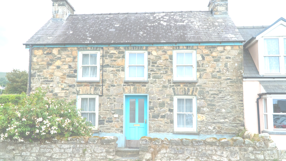

Exercise 1: Brightness and Contrast
Brightness and Contrast result
Brightness and Contrast — simulated result across source images.
Exercise Illustration
Learning Outcomes
Learn how gain and offset interact to shape the luminance of an image.
Key Concepts
  • Gain controls contrast (spread around center)
  • Offset controls brightness (uniform shift)
  • High gain amplifies the effect of offset changes
Video Source
A camera feed or recorded footage with a mix of highlights, midtones, and shadows.
Steps
  1. Boost contrast: Turn Y Gain (Knob 1) clockwise to about 150%. The image becomes punchier (shadows deepen and highlights brighten.)
  2. Lift shadows: Now turn Y Offset (Knob 4) clockwise. The entire image brightens, revealing shadow detail. Notice that with high gain, the offset shift is more dramatic.
  3. Crush blacks: Turn Y Offset counterclockwise past center. Shadows collapse to solid black while highlights remain visible. This is a classic broadcast "setup" adjustment.
  4. Flat gray: Turn Y Gain counterclockwise to about 10%. The image collapses to a narrow band of grays near the offset value, regardless of content.
  5. Recover: Return both controls to center (100% gain, 0% offset). The image returns to its original appearance.
Settings
Control Value
Y Gain
~150%
U Gain
100%
V Gain
100%
Y Offset
+25%
U Offset
0%
V Offset
0%
Y Invert
Off
U Invert
Off
V Invert
Off
Fade Color
Black
Bypass
Off
Fade Amount
100%

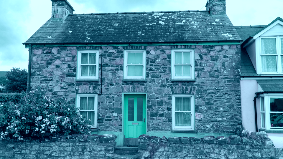

Exercise 2: Color Temperature Shift
Color Temperature Shift result
Color Temperature Shift — simulated result across source images.
Learning Outcomes
Use chrominance offset and gain to create warm and cool color grades.
Key Concepts
  • U Offset shifts blue-yellow balance
  • V Offset shifts red-cyan balance
  • Combined offsets target any hue on the color wheel
Video Source
Footage with neutral tones (skin tones, gray walls, or daylight scenes work well.)
Steps
  1. Cool shift: Turn U Offset (Knob 5) clockwise to about +30%. The image takes on a cool, bluish cast.
  2. Warm shift: Return U Offset to center, then turn V Offset (Knob 6) clockwise to about +30%. The image shifts warm (reds and magentas appear.)
  3. Golden hour: Set U Offset to about −20% and V Offset to about +15%. The combination of reduced blue and boosted red creates a warm, golden look.
  4. Desaturate: Reduce both U Gain (Knob 2) and V Gain (Knob 3) to about 50%. Colors become muted and pastel. At 0% for both, the image is monochrome.
  5. Oversaturate: Push both U Gain and V Gain to 180%. Colors become vivid and almost electric. The image takes on a stylized, hyper-real quality.
Settings
Control Value
Y Gain
100%
U Gain
100%
V Gain
100%
Y Offset
0%
U Offset
−20%
V Offset
+15%
Y Invert
Off
U Invert
Off
V Invert
Off
Fade Color
Black
Bypass
Off
Fade Amount
100%

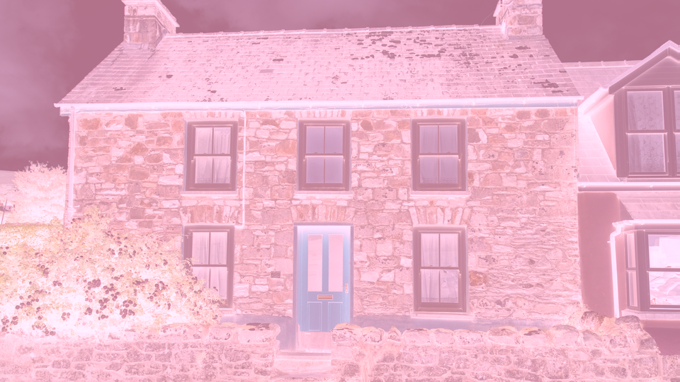

Exercise 3: Inverted Fade Performance
Inverted Fade Performance result
Inverted Fade Performance — simulated result across source images.
Learning Outcomes
Combine channel inversion with the fade control for dramatic, performable color effects.
Key Concepts
  • Per-channel inversion creates complementary color shifts
  • Fade Amount acts as a global wet/dry mix
  • Fade Color changes the dissolve destination
Video Source
Any video source (high-contrast material with strong colors works best.)
Steps
  1. Negative image: Toggle all three invert switches: Y Invert, U Invert, and V Invert: to On. The image becomes a full photographic negative: all tones and hues are reversed.
  2. Partial fade: Pull Fade Amount (Fader 12) down to about 50%. The negative image blends halfway toward black, creating a dark, eerie half-tone.
  3. White fade: Flip Fade Color (Switch 10) to White. The same negative image now blends toward white (a ghostly, washed-out appearance.)
  4. Selective inversion: Turn off Y Invert and leave U Invert and V Invert on. The brightness returns to normal, but all colors are complementary (blues become yellow, reds become cyan.)
  5. Perform: Slowly sweep Fade Amount from 0% to 100% while toggling invert switches. The image transforms fluidly between solid color, inverted, and processed states.
Settings
Control Value
Y Gain
100%
U Gain
100%
V Gain
100%
Y Offset
0%
U Offset
0%
V Offset
0%
Y Invert
On
U Invert
On
V Invert
On
Fade Color
White
Bypass
Off
Fade Amount
~50%
