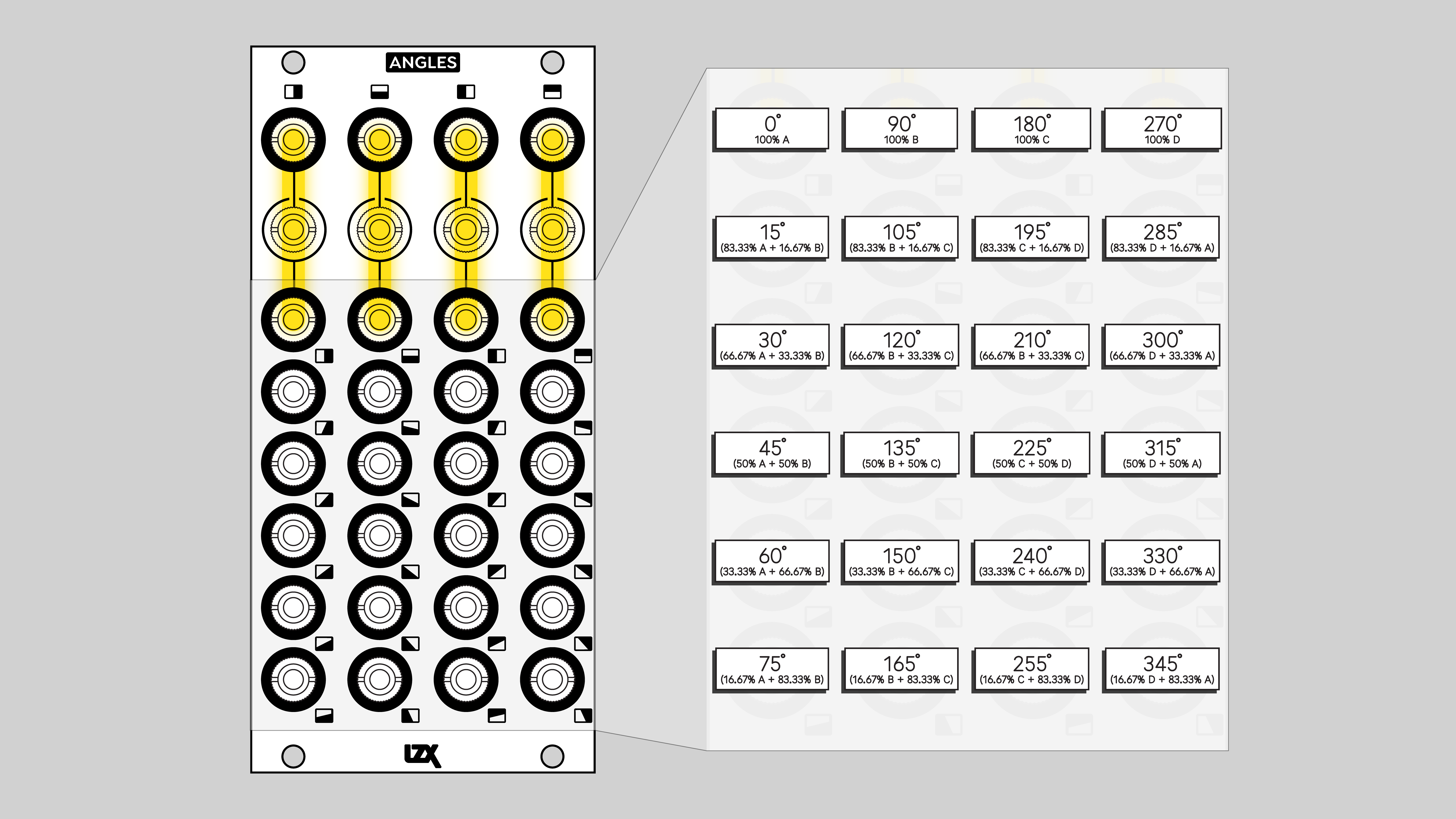

Connectors & Indicators

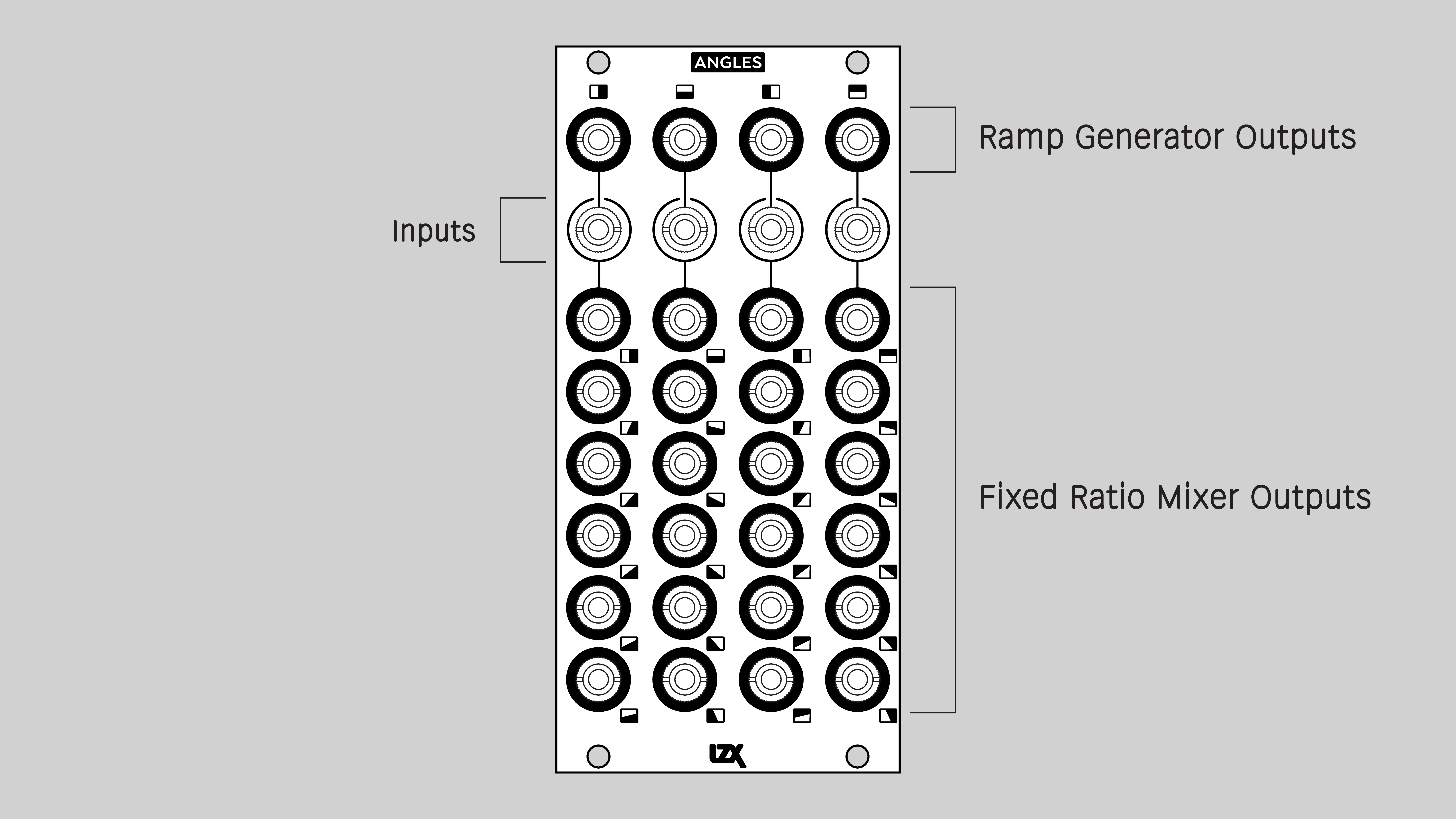

ANGLES controls and connections

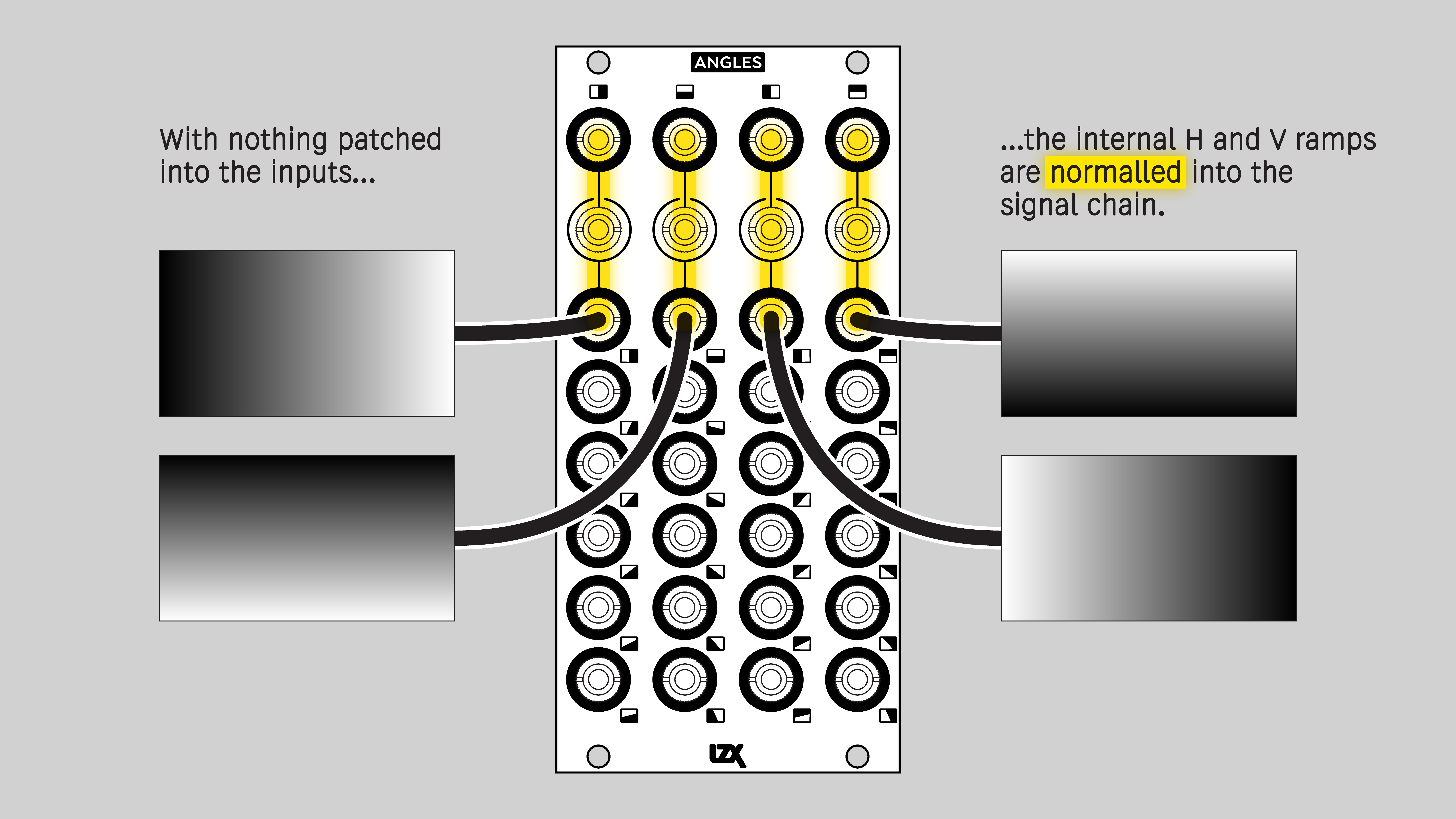

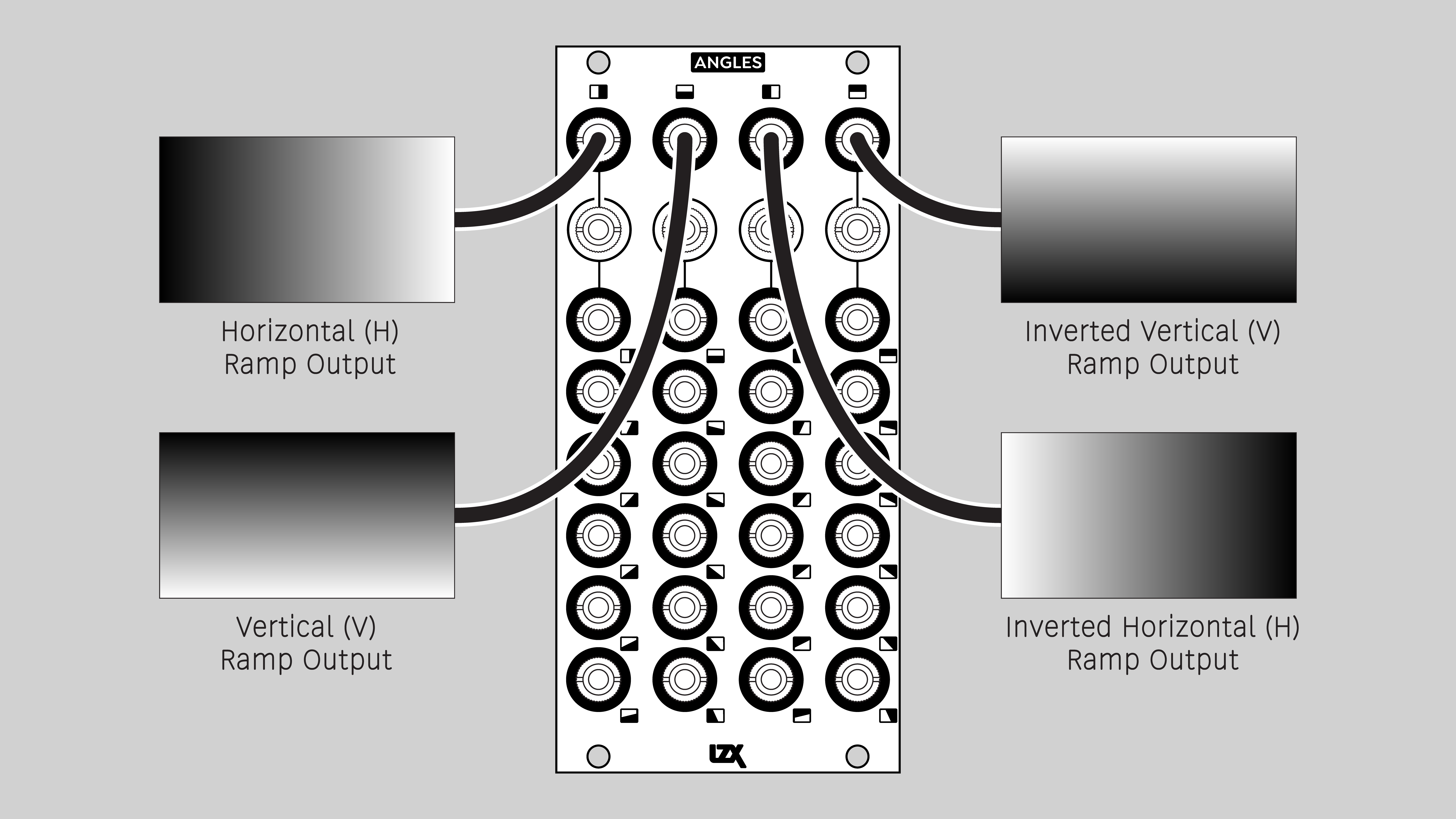

 <br /> Angles is populated with 32 jacks. The top row of jacks are ramp outputs: horizontal, vertical, inverted horizontal, and inverted vertical.
ANGLES H and V ramp outputs
 <br /> These ramps are internally normalled into the A, B, C, and D input jacks on the second row. If nothing is patched into an input jack, a ramp provides the source to the mixing stages below.
ANGLES internal normalling

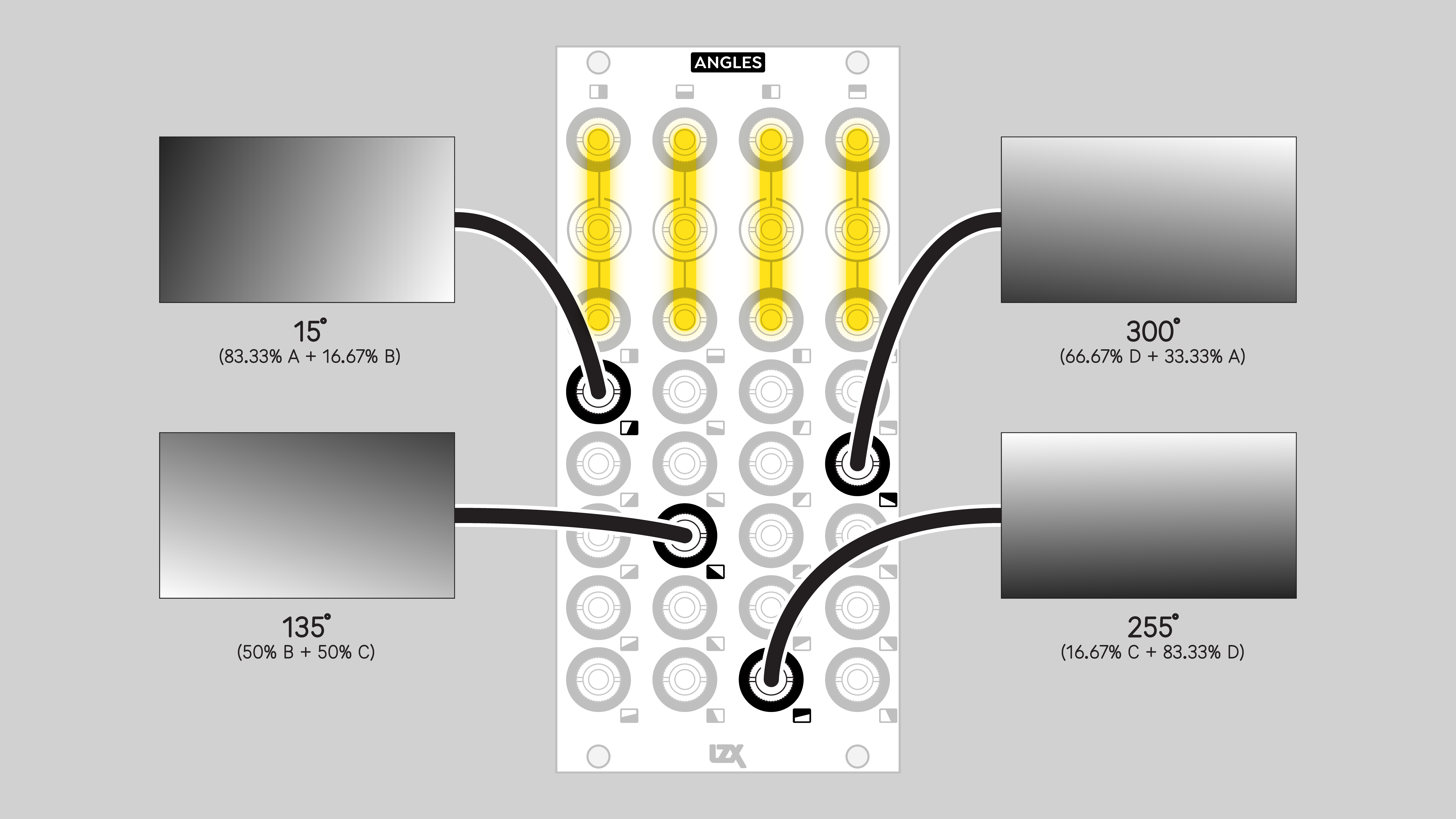

Each of the 24 outputs is a unique mix of two of the A, B, C, and D inputs. Pairs of sources are mixed at ratios of 1:0, 5:1, 2:1, 1:1, 1:2, and 1:5. This results in mixtures of:
  • 100% & 0%
  • 83.3% & 16.7%
  • 66.7% & 33.3%
  • 50% & 50%
  • 33.3% & 66.7%
  • 16.7% & 83.3%
ANGLES fixed ratio outputs
When two ramps are mixed, the result is an angled ramp. Different starting orientations and mixing amounts give different angles. ANGLES splits the circle in 24 equal sections, outputting 24 differently angled ramps, in rotational increments of 15 degrees.
ANGLES rotated ramps

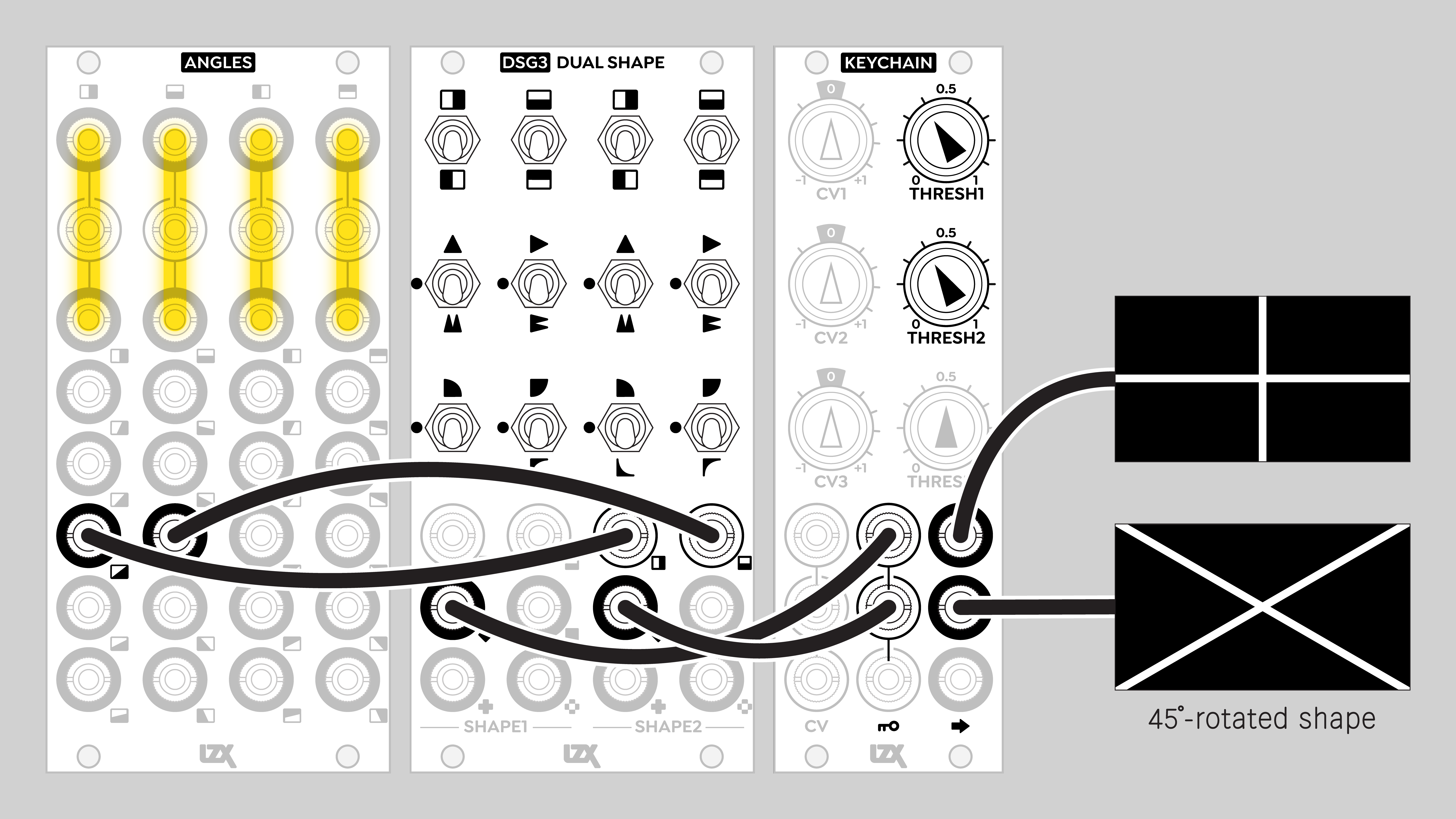

Patch any two outputs from ANGLES into DSG3 to completely change the orientation of its generated patterns.
ANGLES patch: DSG3 orientation

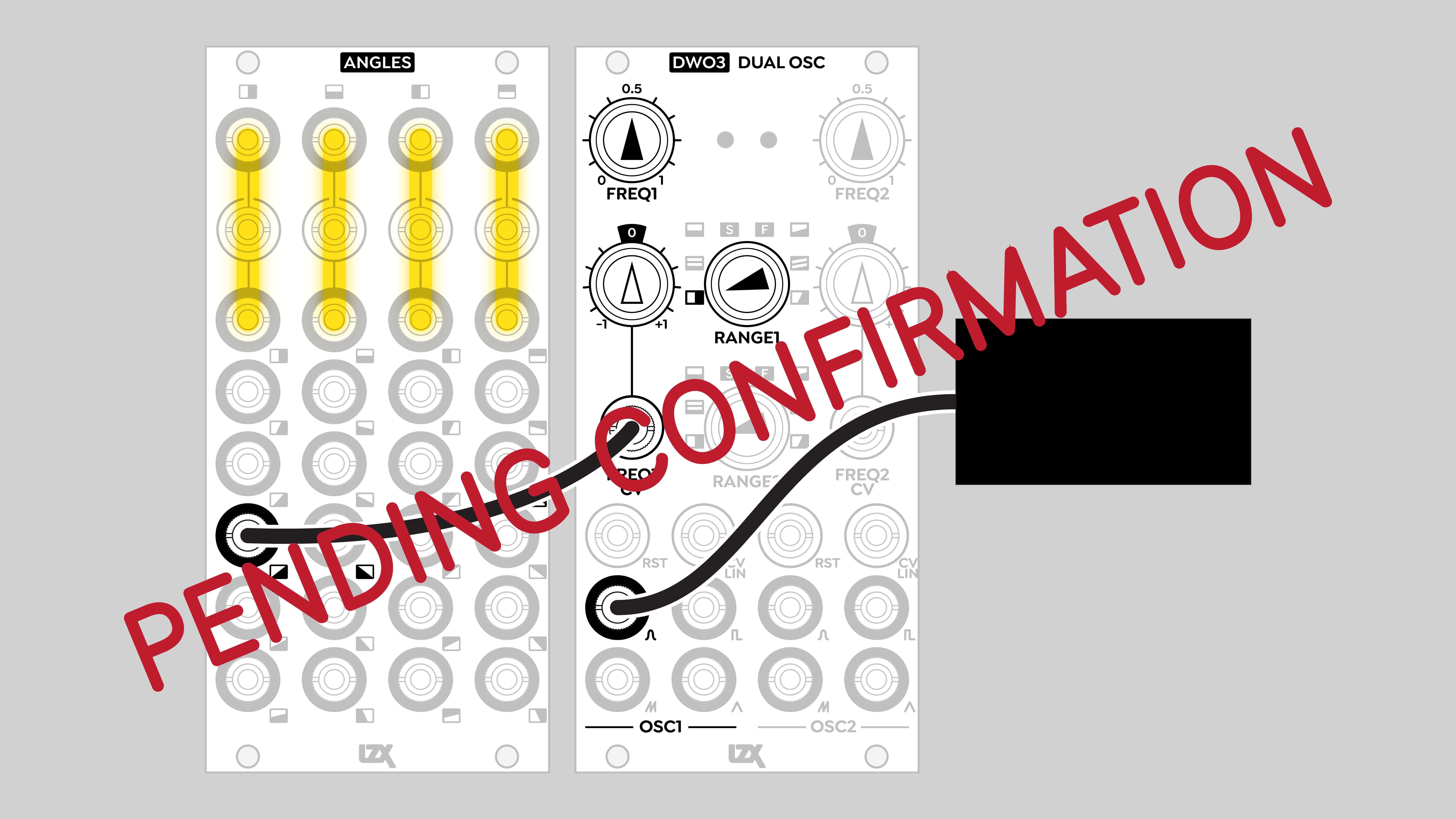

Patch outputs from ANGLES into DWO3 inputs to frequency modulate its waveforms at different angles.
ANGLES patch: oscillator frequency modulation

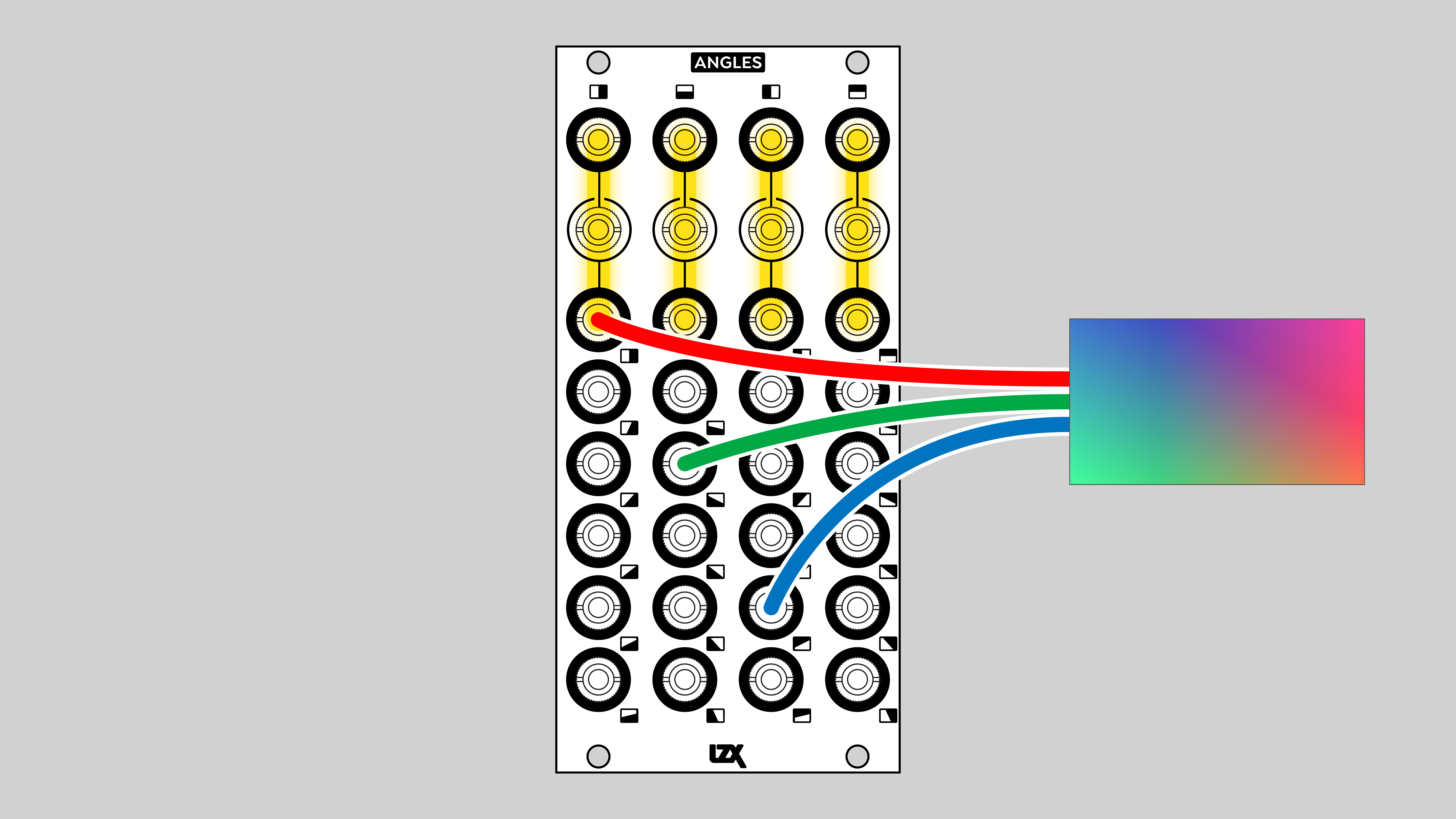

Use any three outputs from ANGLES as RGB channels to create a complex color gradient. This can be a direct visual element or a source of modulation.
ANGLES patch: complex color gradient

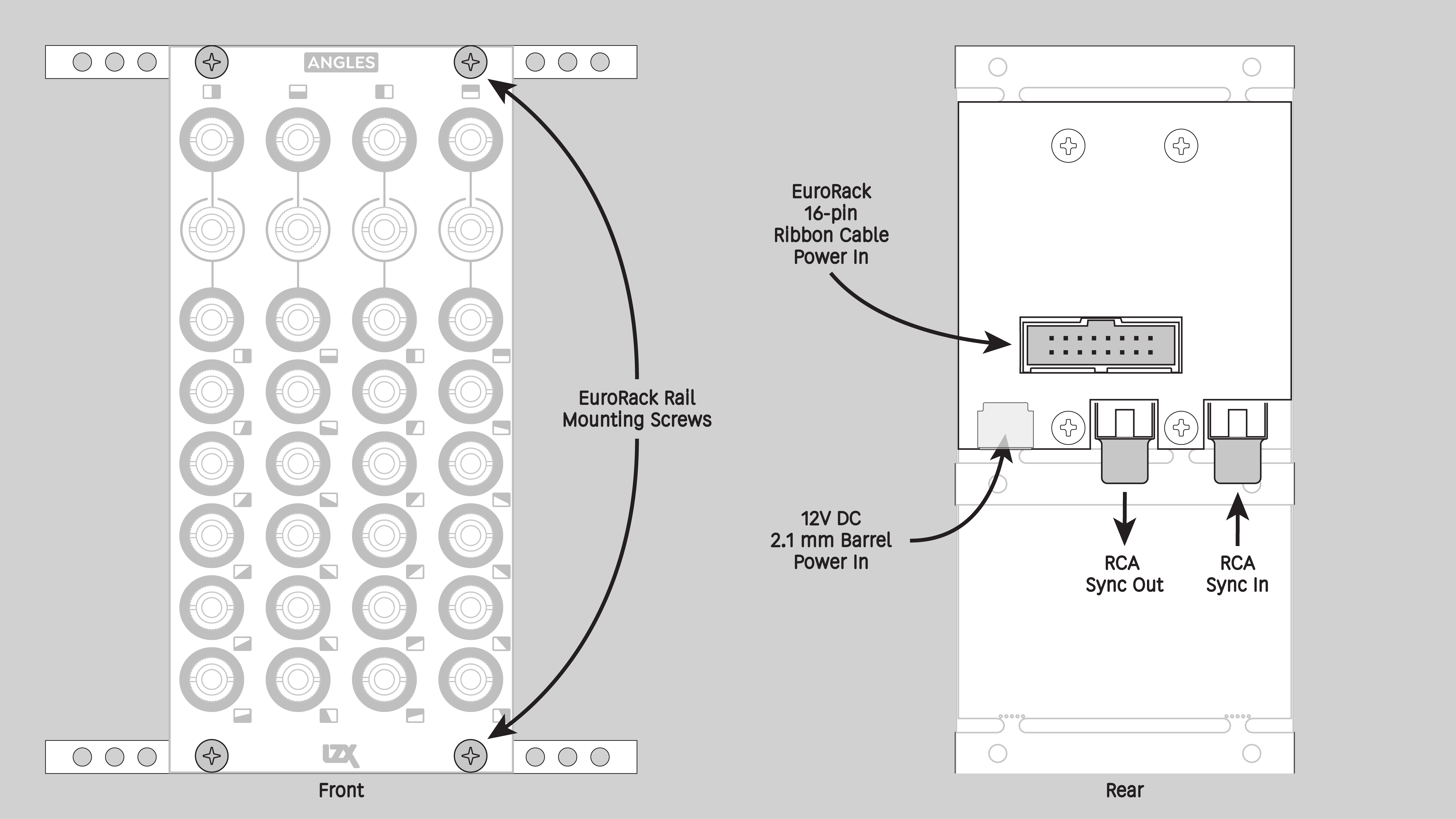

Installation
ANGLES installation
Requirements
  • EuroRack enclosure.
  • 12V DC or EuroRack power supply.
  • EuroRack power cable (included) or a 2.1mm DC barrel power cable (not included).
  • Four M2.5 x 6mm mounting screws, or screws provided or specified by the enclosure manufacturer.
  • #1 Phillips head screwdriver, or hand tool provided or specified by the enclosure manufacturer.
Procedure

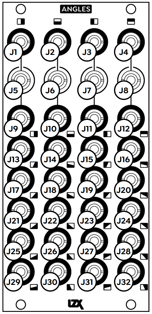

Angles: labeled front panel controls
Jack Function
J1
H Ramp out
J2
V Ramp out
J3
Inverted H ramp out
J4
Inverted V ramp out
J5
A in
J6
B in
J7
C in
J8
D in
J9
0 degrees out<br />(100% A)
J10
90 degrees out<br />(100% B)
J11
180 degrees out<br />(100% C)
J12
270 degrees out<br />(100% D)
J13
15 degrees out<br />(83% A + 17% B)
J14
105 degrees out<br />(83% B + 17% C)
J15
195 degrees out<br />(83% C + 17% D)
J16
285 degrees out<br />(83% D + 17% A)
Jack Function
J17
30 degrees out<br />(67% A + 33% B)
J18
120 degrees out<br />(67% B + 33% C)
J19
210 degrees out<br />(67% C + 33% D)
J20
300 degrees out<br />(67% D + 33% A)
J21
45 degrees out<br />(50% A + 50% B)
J22
135 degrees out<br />(50% B + 50% C)
J23
225 degrees out<br />(50% C + 50% D)
J24
315 degrees out<br />(50% D + 50% A)
J25
60 degrees out<br />(33% A + 33% B)
J26
150 degrees out<br />(33% B + 33% C)
J27
240 degrees out<br />(33% C + 33% D)
J28
330 degrees out<br />(33% D + 33% A)
J29
75 degrees out<br />(17% A + 83% B)
J30
165 degrees out<br />(17% B + 83% C)
J31
255 degrees out<br />(17% C + 83% D)
J32
345 degrees out<br />(17% D + 83% A)
