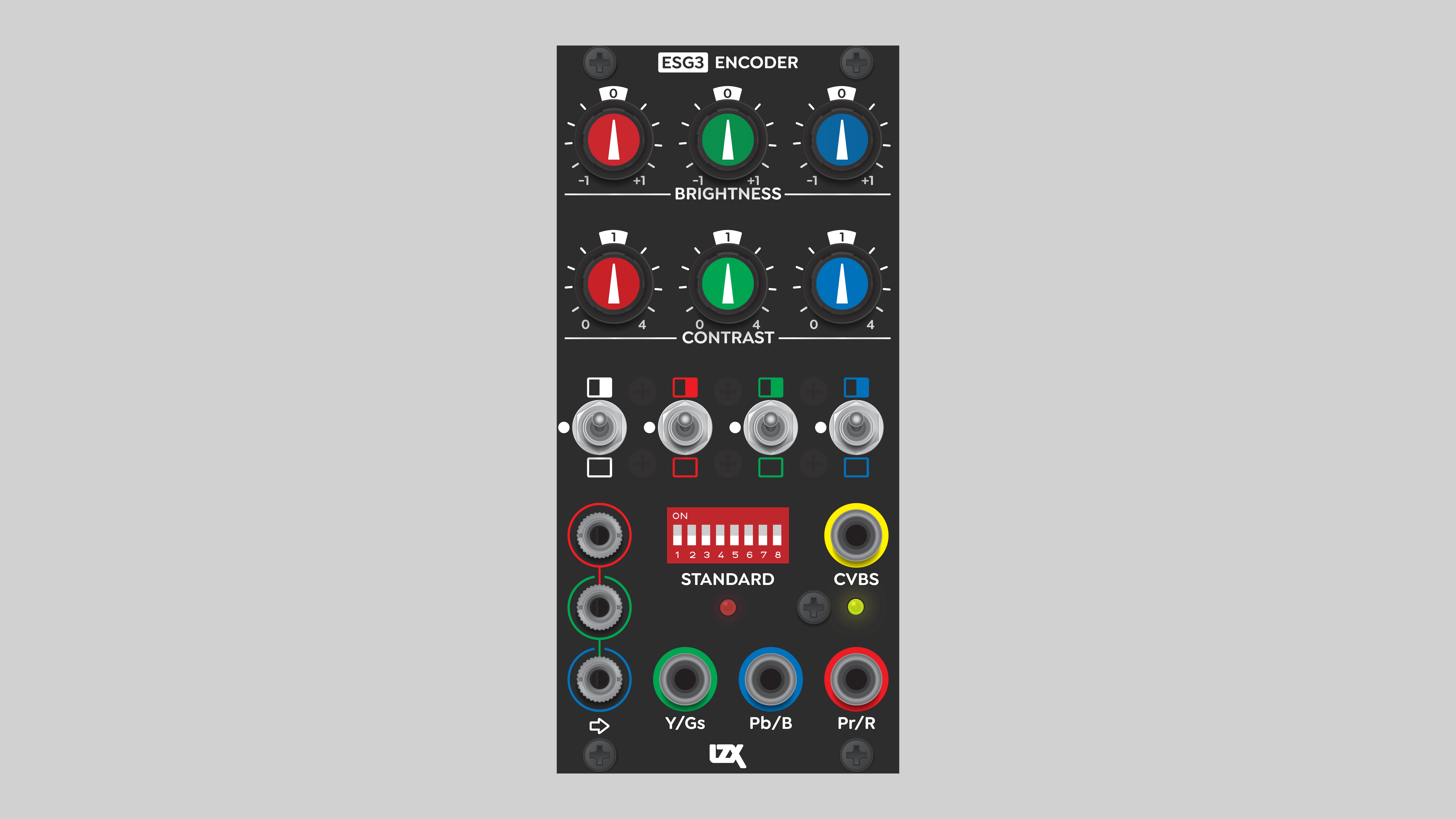

ESG3 front panel
Critical to the video mission, ESG3 combines three essential functions into a compact form factor. ESG3 generates sync, outputs SD or HD video, and manipulates color. More than a utility module, ESG3 features integrated processing amplifiers, making it a creative instrument.
To output legal video signals from a modular synthesizer, an encoder is required. ESG3 converts LZX-compatible 1 volt signals to composite, RGB component, or YPbPr component video. It supports a wide range of video standards, from NTSC and PAL up to full high definition.
A modular synthesizer also requires a source of video sync. ESG3 generates sync with or without an external reference. It can be the ultimate source of sync, or genlock to incoming sync or video. Either way, ESG3 ensures that the entire modular system dances to the beat of the same drummer.
Proc amp controls allow aesthetic image manipulation. Each RGB channel features brightness and contrast adjustments. Invert or mute each channel with the flick of a switch. Invert or mute all outputs with another switch, making it easy to cut to black.

LEDs
Status of video sync is indicated by the LED light directly below the Standard DIP switches. When ESG3 is genlocked to external sync, the LED glows green. When ESG3 is in internal sync mode, not genlocked to external sync, the light glows amber.
Status of composite video output is indicated by the LED light directly below the CVBS output. When ESG3 is set to a standard that supports composite video (NTSC/PAL), the light glows green, and composite video appears at the CVBS output jack. When ESG3 is set to a video standard that does not support composite video (all HD formats), the light glows amber, and no signal appears at the CVBS output jack.
Jacks, pots, and switches
On the bottom left of the module are three input jacks to accept 1v LZX modular video. They are color-coded to accept red, green, and blue color components. Anything patched into a Red, Green, or Blue input is converted to the corresponding color component of a video image.
Inputs are internally normalled, allowing signals to cascade down to the inputs below. Patching a signal into only the top (Red) input sends that signal to all three inputs. If the Contrast and Brightness controls are set to unity gain and bias, then patching into only the Red input results in a grayscale output.
ESG3 only accepts signals in the unipolar range of 0 to 1 volts. Any signal below 0v or above 1v is discarded.
Component video outputs appear at RCA jacks at the bottom right of the module. In YPbPr modes, the order of outputs from left to right is Y, Pb (Blue minus Y), and Pr (Red minus Y). In RGB modes, the order of outputs from left to right is Green, Blue, and Red.
In standard definition modes, composite video output is available from the RCA jack labeled CVBS, color-coded with a yellow insulator inside the jack.
In standard definition modes, both composite and component outputs are simultaneously active. In high definition modes, the composite output is not active.
ESG3 features four toggle switches, each with three positions, to invert or mute individual RGB components, or the global outputs.
At the top of the module are six potentiometer knobs, controlling the Contrast and Brightness of each RGB channel.
To the left of each RGB switch are two small recessed trim potentiometers. These are calibration controls. Their usage is described in the Calibration section below.
Early production units of ESG3 featured detent knob positions. For those units, calibration is more important because the knobs "want" to go to a center, default value. If the unit isn’t calibrated, those default positions result in outputs that aren’t at unity gain relative to the signal inputs.

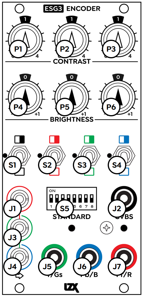

DWO3: labeled front panel controls
Jack Function
J1
Red in
J2
RCA Composite video out
J3
Green in
J4
Blue in
J5
RCA Y or Green+Sync video out
J6
RCA Pb or Blue video out
J7
RCA Pr or Red video out
Switch Function
S1
All Outputs <br />Invert/Mute
S2
Red <br />Invert/Mute
S3
Green <br />Invert/Mute
S4
Blue <br />Invert/Mute
S5
Video Standard <br />DIP switches
Pot Function
P1
Red Contrast
P2
Green Contrast
P3
Blue Contrast
P4
Red Brightness
P5
Green Brightness
P6
Blue Brightness
