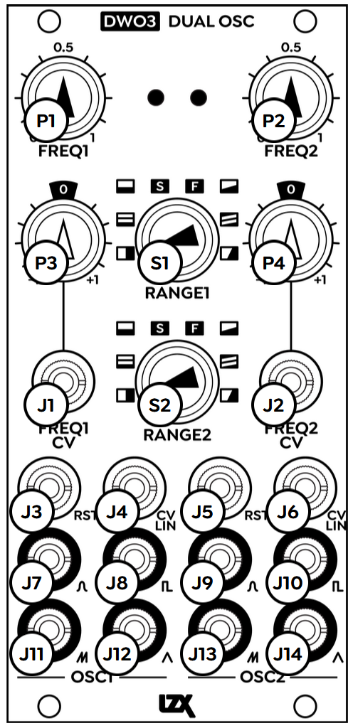

DWO3: labeled front panel controls
Jack Function
J1
Osc 1 Exponential Frequency CV in
J2
Osc 2 Exponential Frequency CV in
J3
Osc 1 Reset in
J4
Osc 1 Linear <br />Frequency CV in
J5
Osc 2 Reset in
J6
Osc 2 Linear <br />Frequency CV in
J7
Osc 1 Sine out
J8
Osc 1 Square out
J9
Osc 1 Sine out
J10
Osc 2 Square out
J11
Osc 1 Sawtooth out <br />(rising ramp)
J12
Osc 1 Triangle out
J13
J14
Osc 1 Triangle out
Switch Function
S1
Osc 1 Range
S2
Osc 2 Range
Pot Function
P1
Osc 1 Frequency
P2
Osc 2 Frequency
P3
Osc 1 Exponential Frequency CV Depth
P4
Osc 2 Exponential Frequency CV Depth
