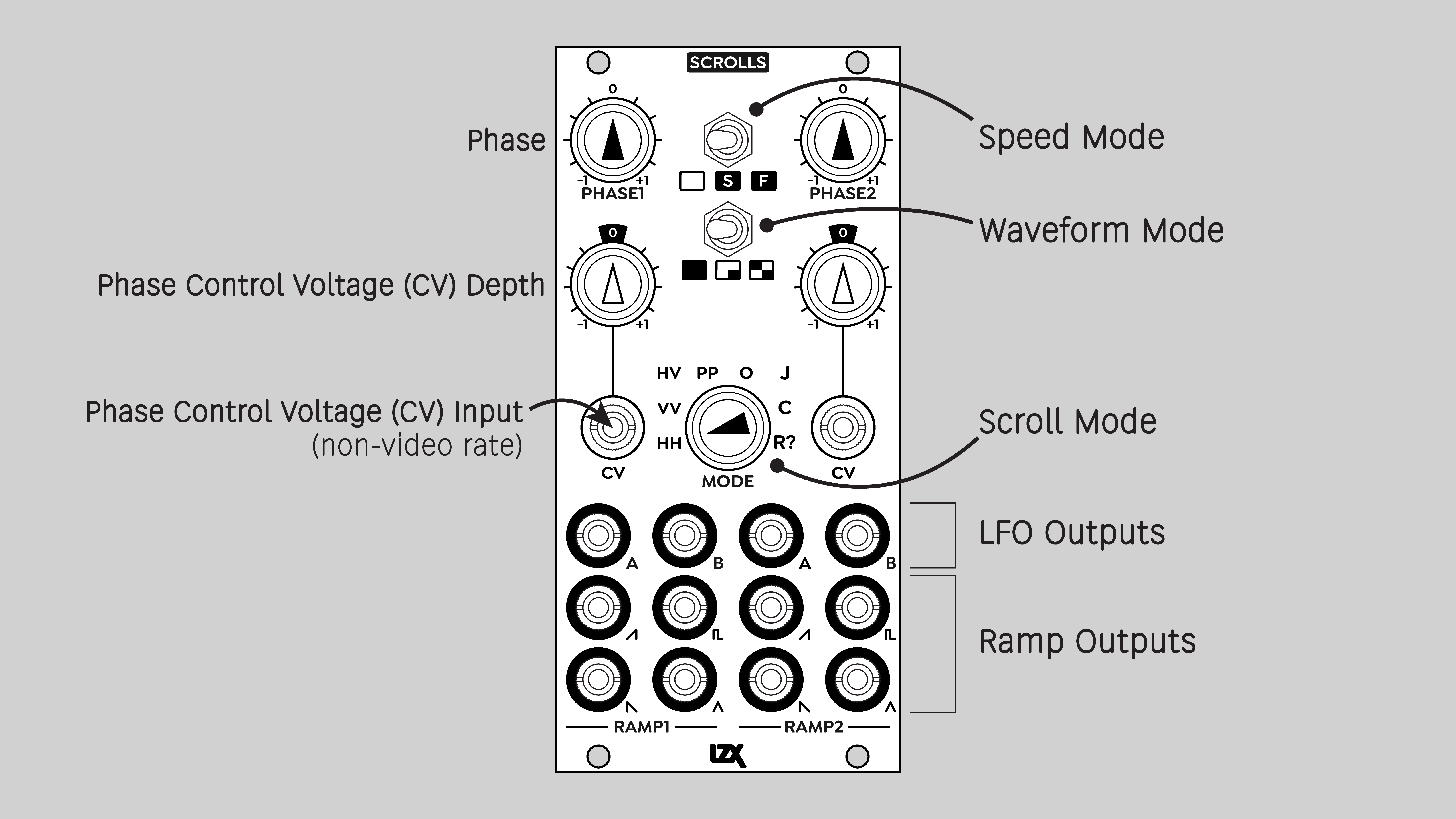

Scrolls is a rhythm source, almost like the visual version of a drum machine. It packs a great deal of functionality into a small package of 12 HP, with no menu diving.
Two identical submodules, Ramp 1 and Ramp 2, provide independent inputs and outputs.
The primary global Mode of Scrolls is chosen from the eight-position rotary switch in the center of the panel. This selects whether H or V signals are available from the video generator jacks, and how all motion is controlled.
Two three-position toggle switches choose other global options. The top switch selects the Speed mode. The switch directly below that selects the Waveform mode.

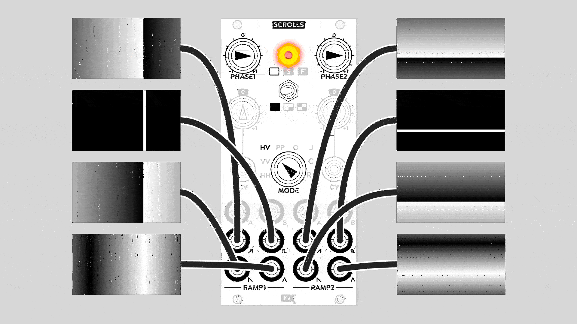

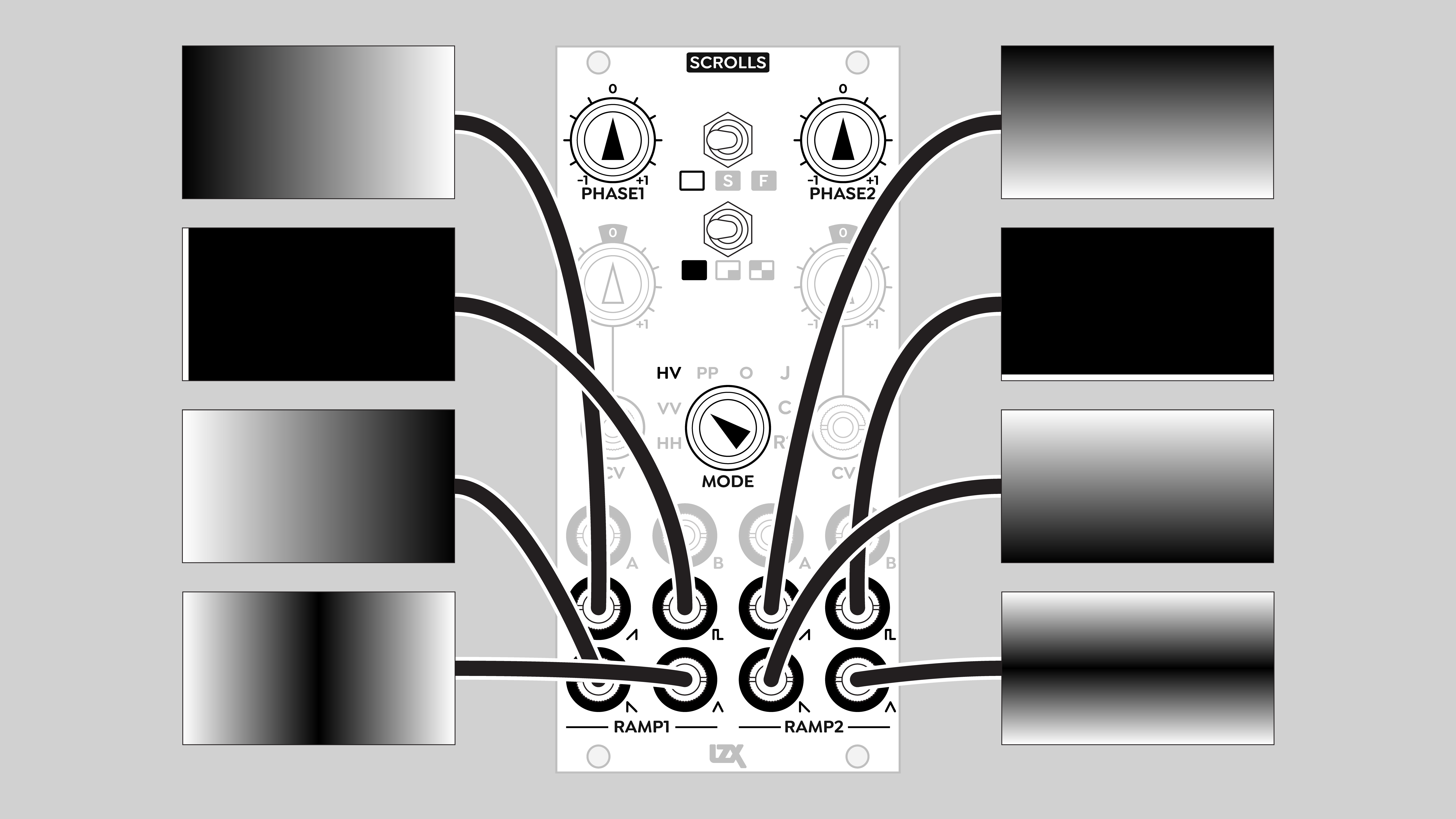

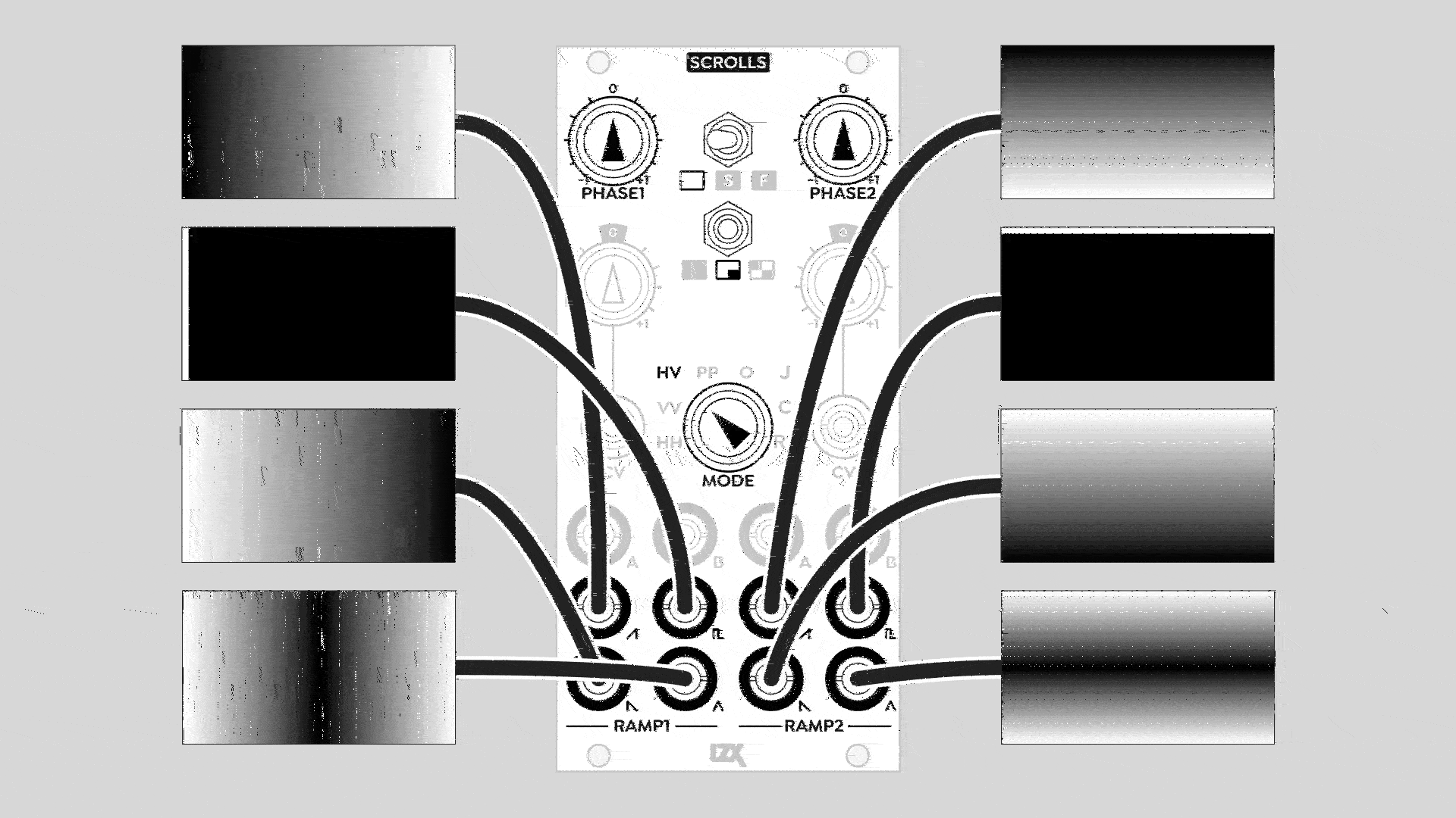

As the primary driver of a generative video patch, Scrolls features numerous outputs. The two bottom rows of jacks are the video waveform generators. Each Ramp submodule provides the following outputs: Ramp (rising), Pulse, Sawtooth (falling), and Triangle.

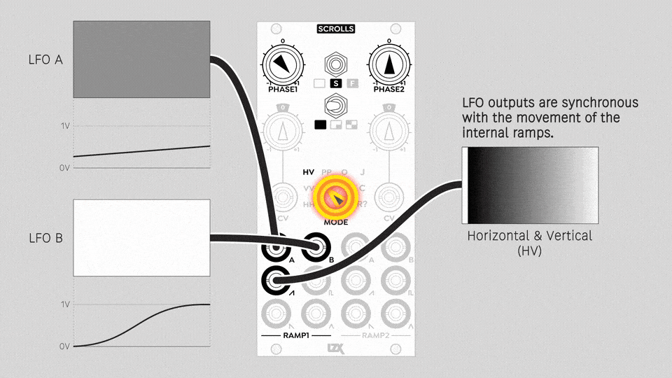

Above the video outputs is a row of low frequency control voltage outputs. Each Ramp submodule features two LFO outputs, labeled A and B.
Per each Ramp Submodule, a bipolar Phase potentiometer shifts the position of the generator, or controls the motion in some other way. The Phase value can be driven by a control voltage supplied to the CV jack. The incoming phase CV is multiplied by the value set with the Phase CV Depth attenuverter potentiometer.

Choose from three waveform modes. The toggle switch selects one of three modes, from left to right: Wrap, Blank, and Mirror.
Wrap
The ramp phase scrolls continuously, repeating across the screen.
Scrolls: Wrap waveform
Blank
The ramp phase can be shifted entirely offscreen.
Scrolls: Blank waveform
Mirror
The ramp phase inverts on every other cycle. The result is a scrolling virtual canvas, double the width and double the height of the video image.
Scrolls: Mirror waveform

HV: Horizontal & Vertical
Ramp 1 video waveforms are horizontal, Ramp 2 video waveforms are vertical.
LFO A is a sine wave. LFO B is a rising ramp in phase with LFO A, such that the lowest values of the two oscillators happen at the same time.
Scrolls: HV mode

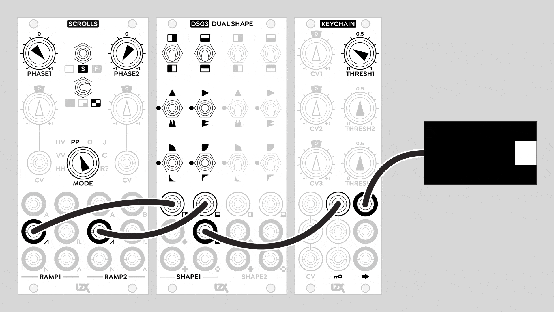

PP: Ping Pong
Ramp 1 video waveforms are horizontal, Ramp 2 is vertical. Motion uses triangle waves, for the bouncing DVD player logo effect.
LFO A is a triangle wave. LFO B is a sine wave, in phase with LFO A.
Scrolls: Ping-pong mode

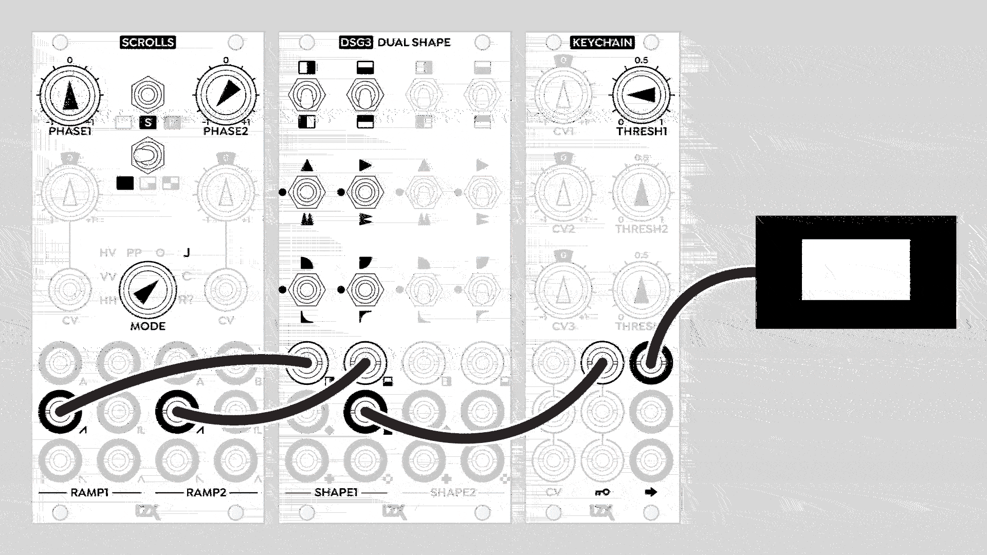

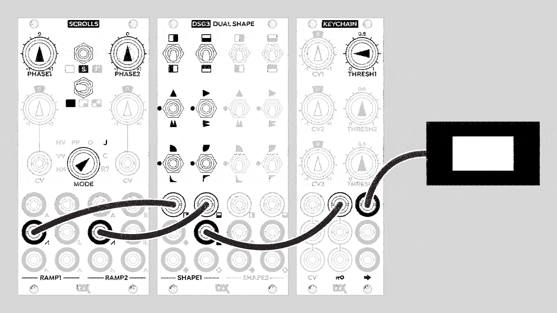

Example Patches

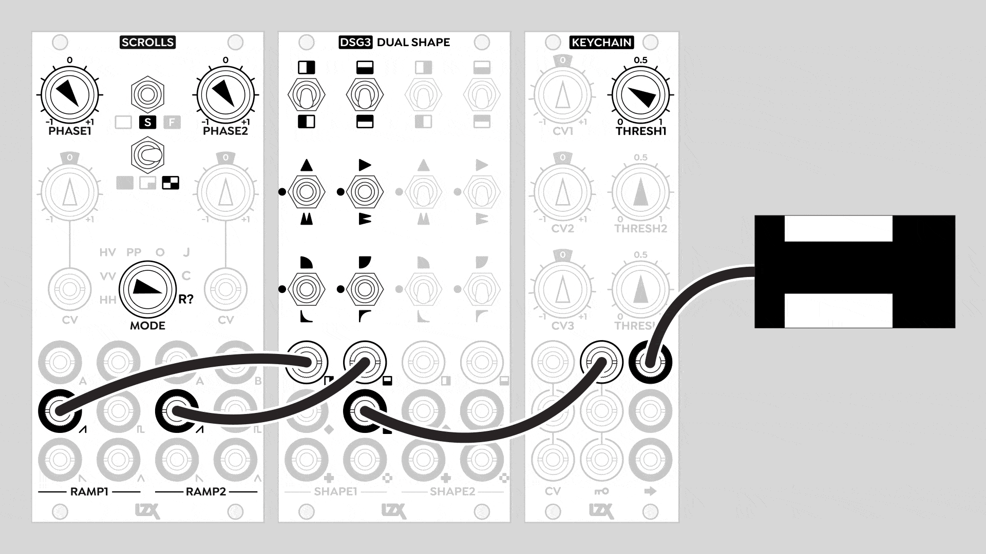

Reset DWO3
Scrolls patch: DWO3 reset

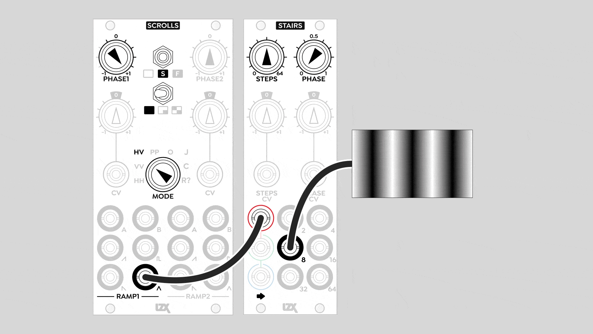

Stairs
Scrolls patch: Stairs

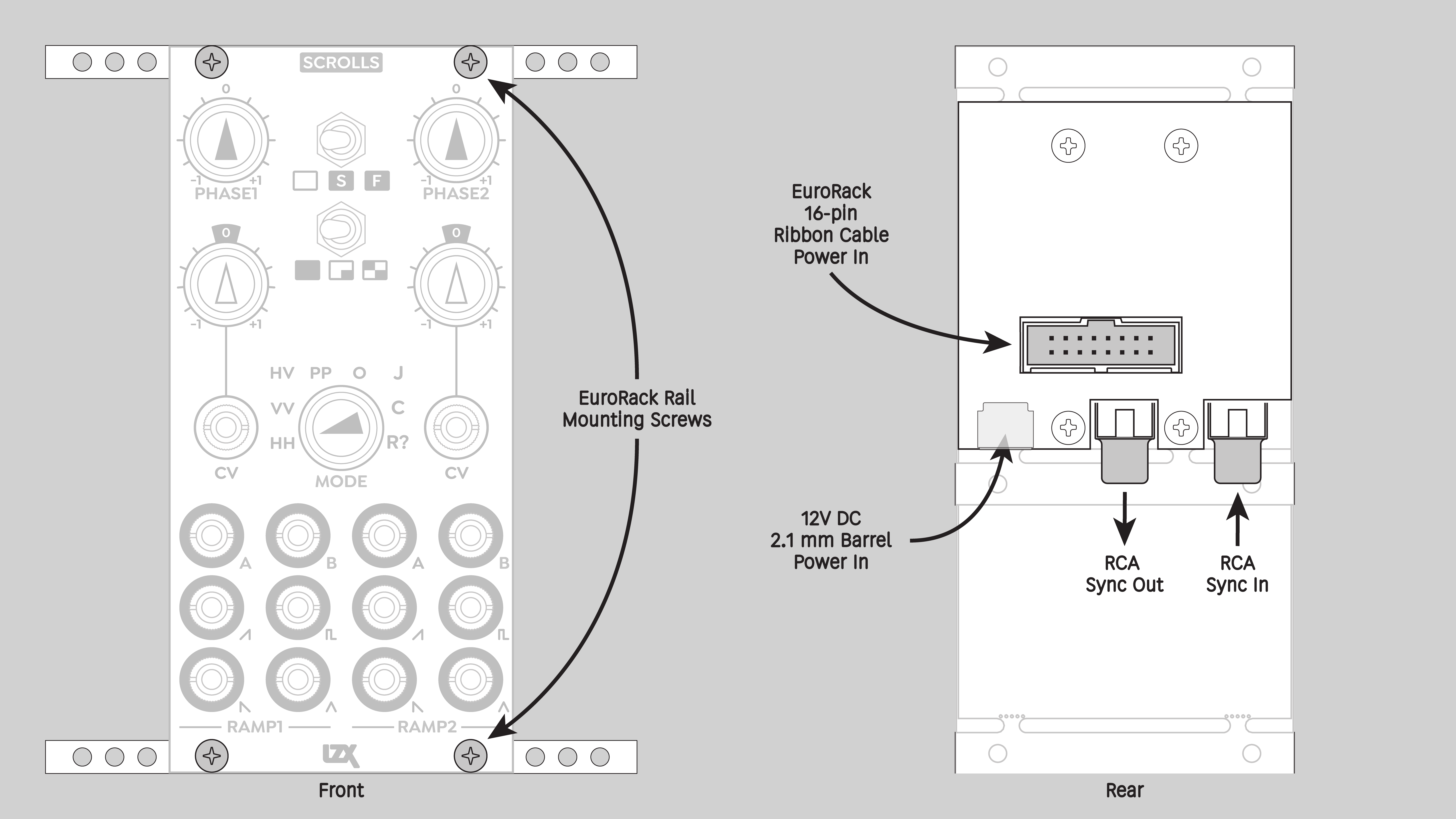

Installation
Scrolls installation
Requirements
  • EuroRack enclosure
Procedure
