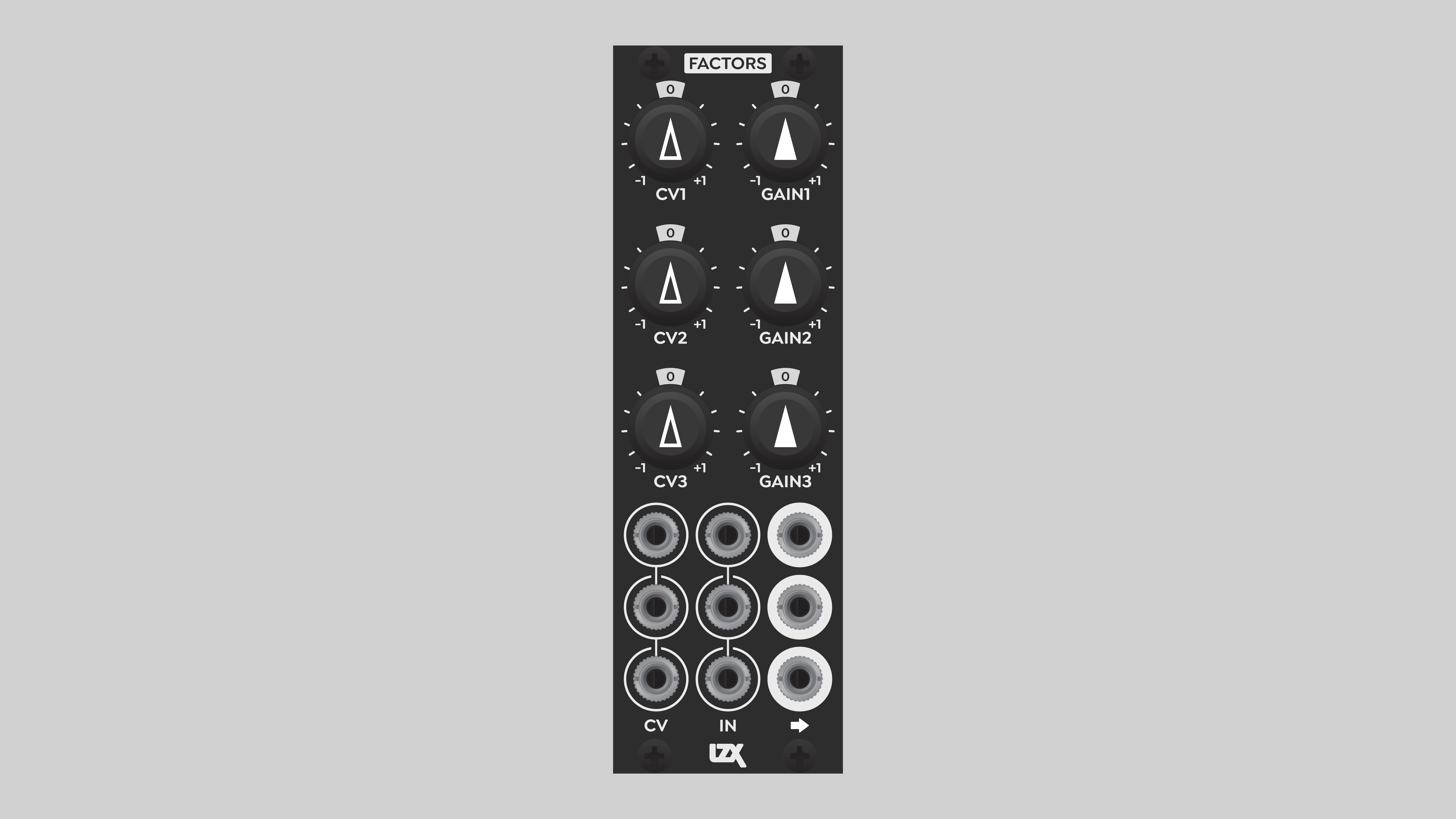

Factors is a triple four-quadrant multiplier and modulator. It’s specifically designed for the LZX patchable video standard of 0 to +1v. Use it to modulate amplitudes, adjust image contrast, or predictably control the transforms of vector graphics.
For video images and patterns, Factors is an amplitude modulator and symmetrical contrast adjuster. The scaling operation is centered on the mid-gray value of 0.5 volts: a "fade to gray". The ability to simultaneously set the black point and white point with a single voltage controllable parameter opens up interesting visual possibilities.
For XY vector graphics, Factors allows transforms (position, rotation, scale) to be centered on the raster or oscillographic figure. An ordinary one- or two-quadrant multiplier or voltage controlled amplifier would perform transforms around a corner of the figure. An ordinary four-quadrant multiplier would perform transforms around the center of the figure, but would require bipolar voltages throughout the patch. Factors is the solution for centered transforms of unipolar signals such as video ramps.

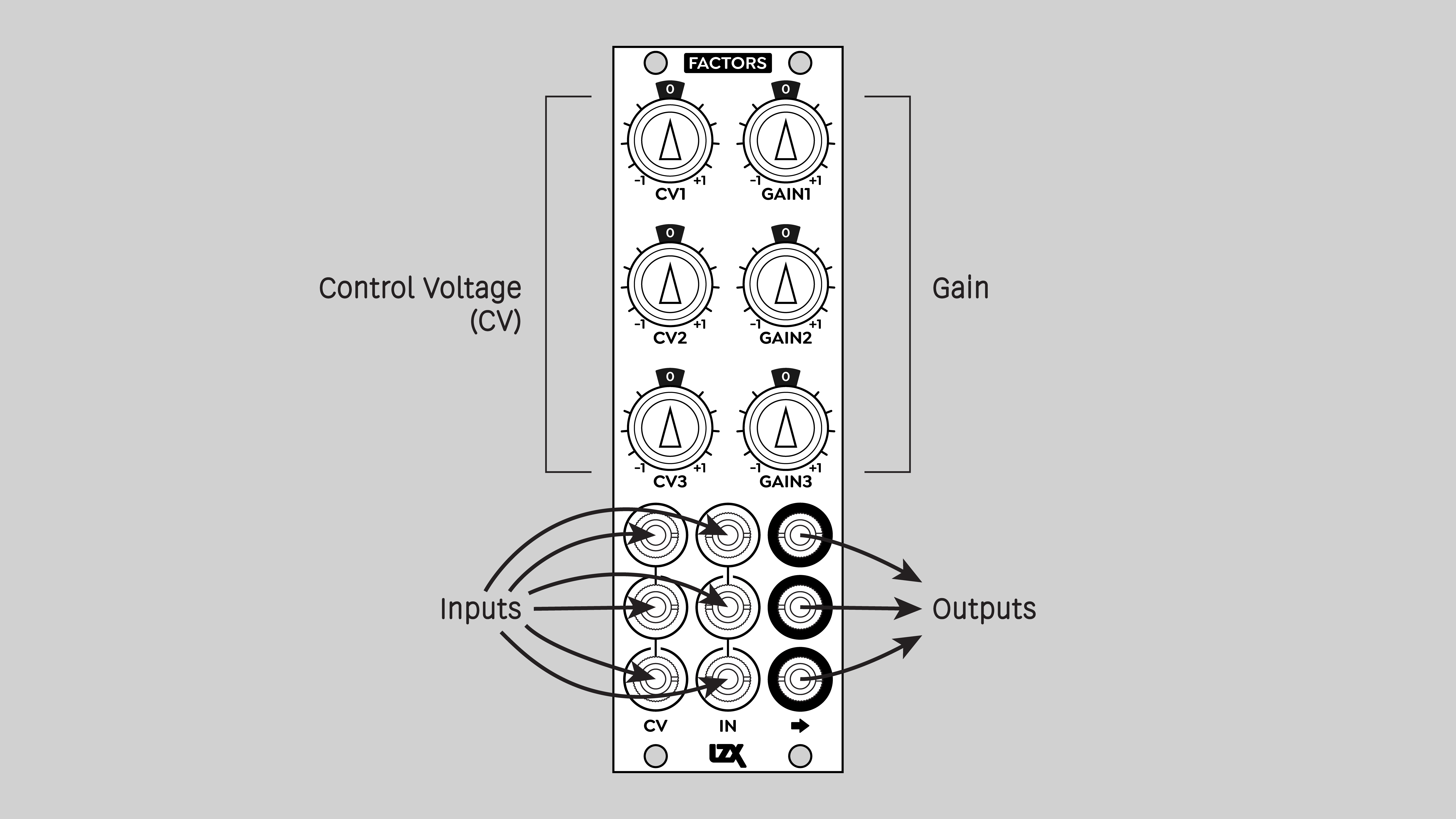

Factors has three discrete multipliers, labeled 1, 2, and 3. As described below, they are internally normalled in series, so you can produce two or three variations on a single pair of sources.
Each multiplier has two inputs, labeled CV and In. These inputs are actually identical, and the labeling is merely conventional. It may help the artist to keep track of which signals are which. For example, if you wanted to modulate the amplitude of a high frequency video oscillator with a low frequency control signal, it would make sense to think of the high frequency oscillator as the "signal", and the low frequency oscillator as the "modulator". But technically, it doesn’t matter which of the pair of signal factors goes into which CV or In jack.
Each input signal goes through an attenuverter before the multiplication operation. These are the knobs labeled CV1 through CV3, and Gain1 through Gain3 for the CV and In jacks, respectively. This makes it easy to dial down or invert the individual signal factors.

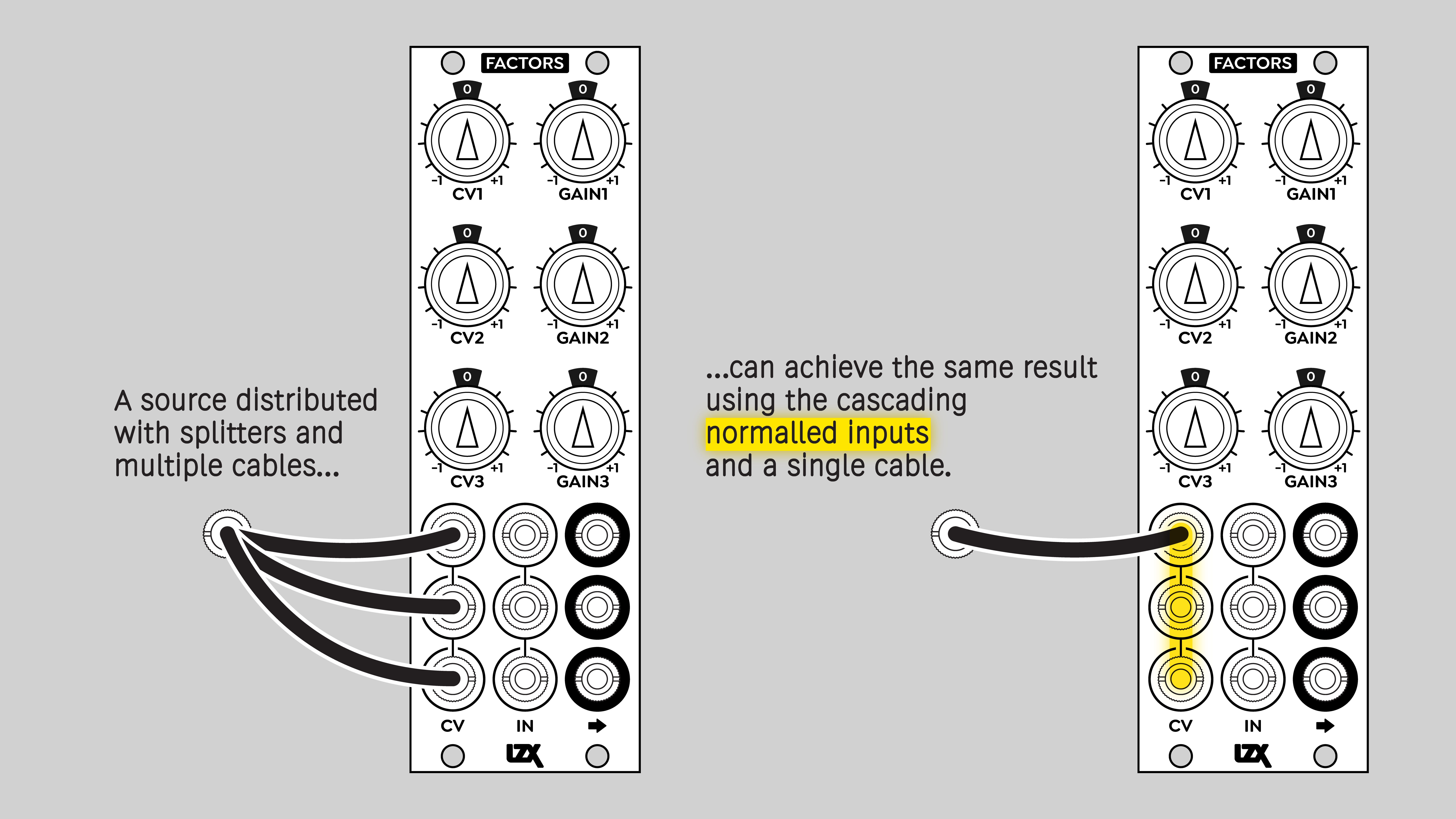

The inputs are internally self-normalled to cascade from top to bottom. A signal patched into a top row input flows to the other inputs in that column.

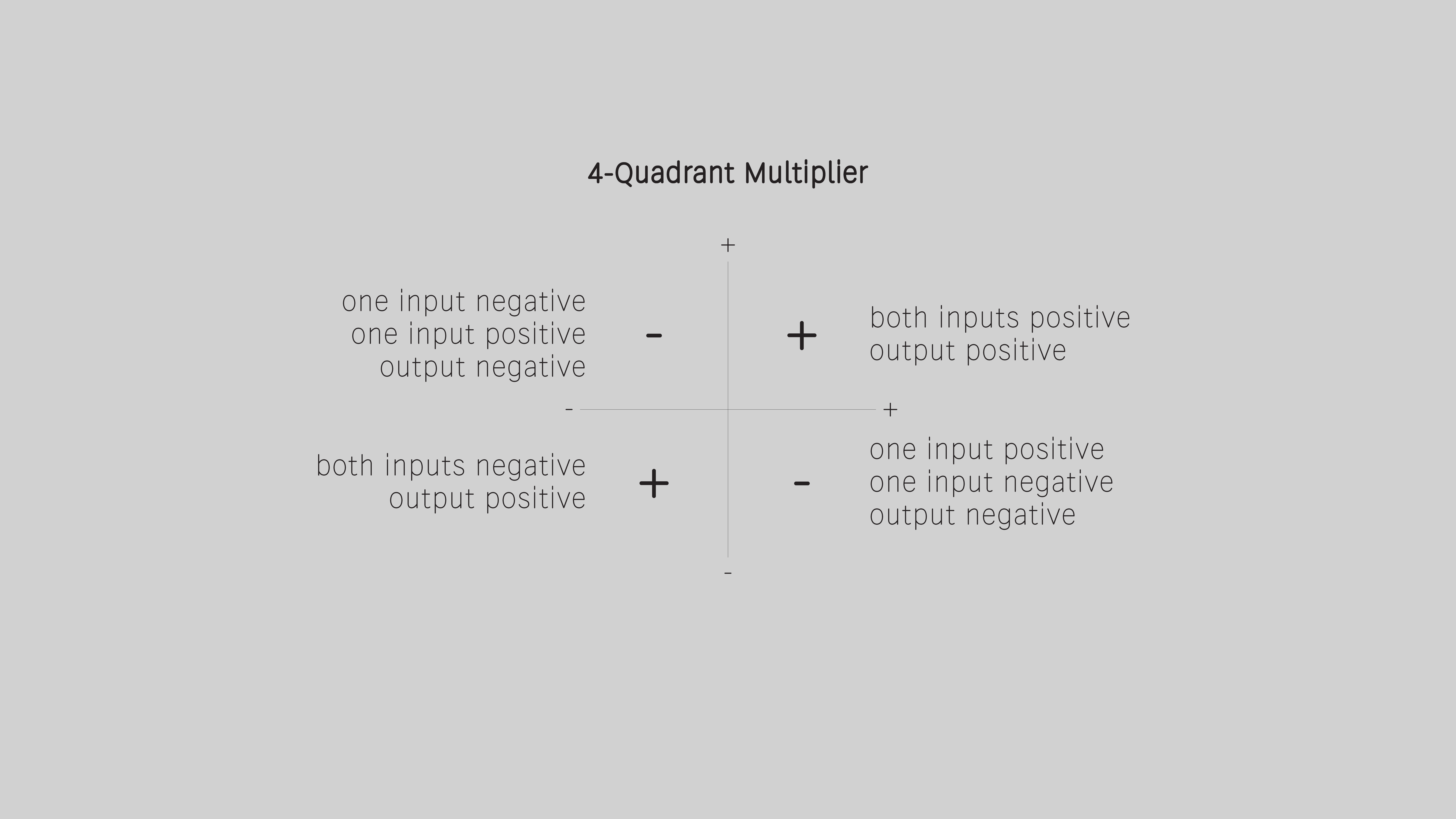

A conventional four-quadrant multiplier (4QM) is designed to operate on bipolar signals: values that are signed positive or negative. The center of the multiplication operation is at a value of zero. This doesn’t work very well in the context of video signals that are always positive. It’s also not optimized for XY vector graphics. A conventional 4QM places the origin or pivot point of vector transforms at a corner of the figure rather than in the center. The figure would scale or rotate around a corner point.

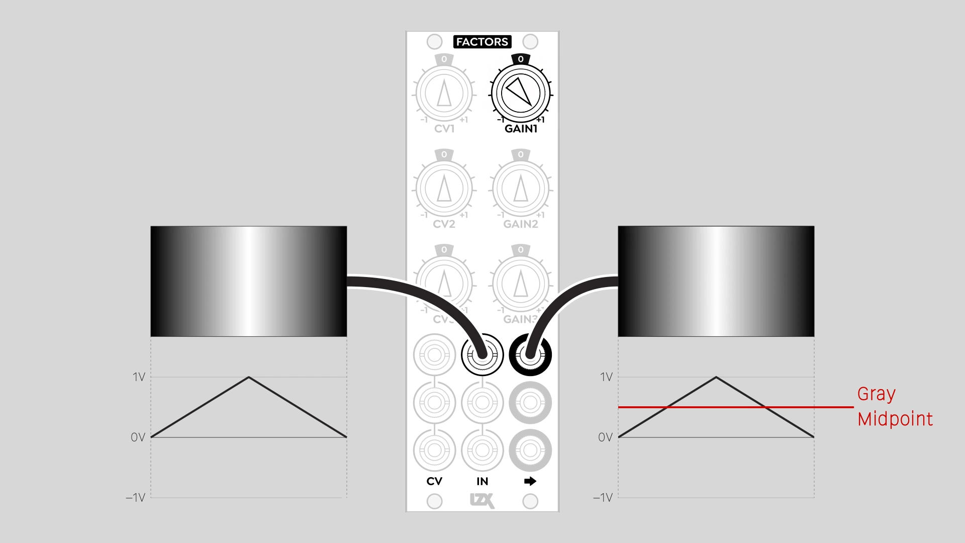

Factors solves this problem by performing multiplication operations centered on a value of 0.5 rather than zero. Incoming signals are internally biased down by 0.5 volts, making them bipolar. Then Factors performs a conventional 4QM operation. Finally, Factors biases the resulting product back up by 0.5 volts. The end result is that the pivot point of XY vector transforms is in the center of the figure instead of at a corner. Additionally, the resulting scaling operation doesn’t pass through zero, and doesn’t flip the image horizontally and vertically. The image never turns inside out, it scales from zero to its maximum size.
Factors is not just for XY vector graphics, it also applies to conventional video images. It gives the artist another tool for manipulating images. An ordinary one-quadrant multiplier or voltage controlled amplifier adjusts the gain of a signal centered on a value of zero volts: a fade to black. Factors modulates the gain of a signal centered on the midpoint of 0.5 volts: a fade to gray.

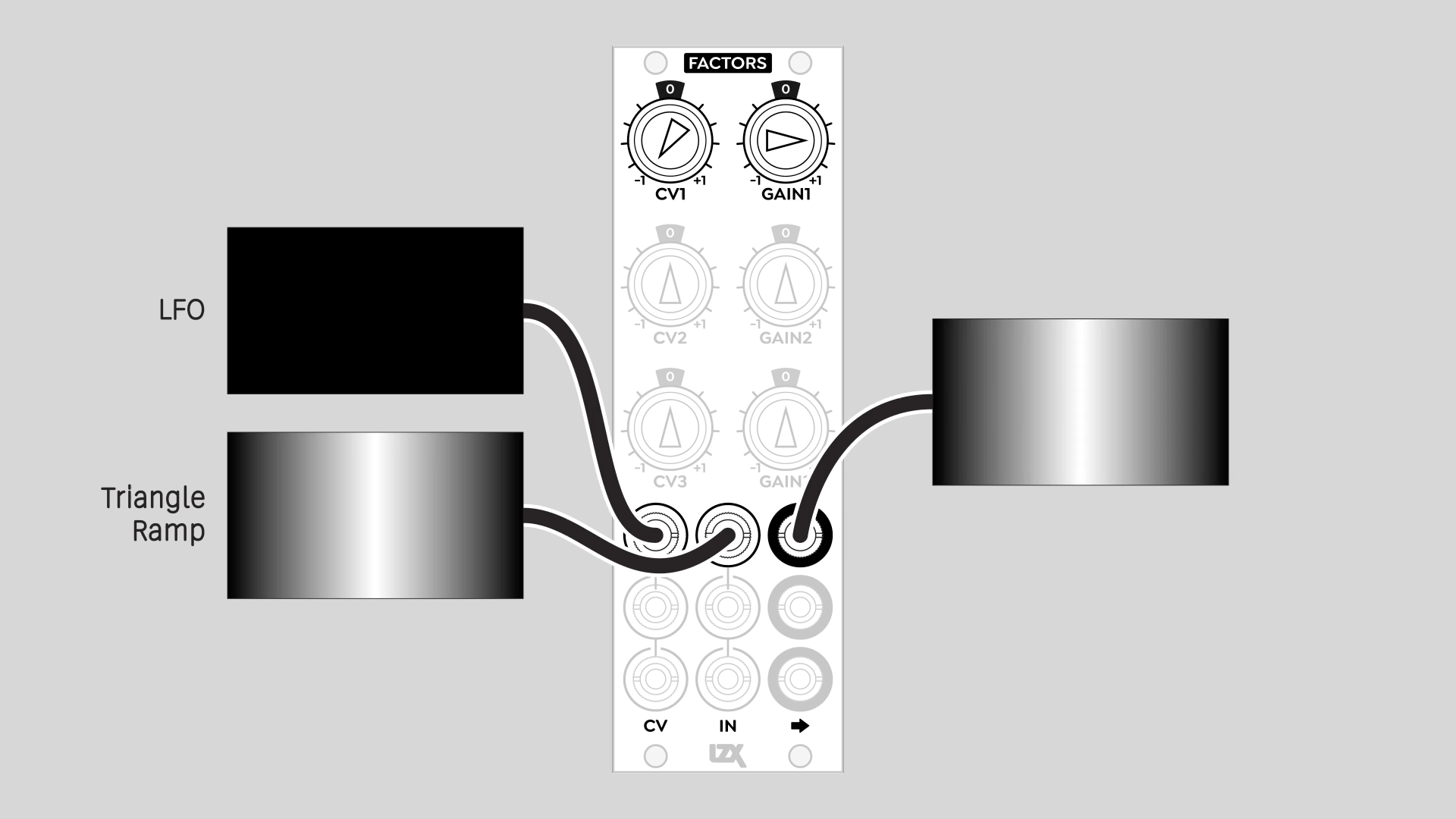

Inversion Around Middle Gray
Factors inversion around middle gray

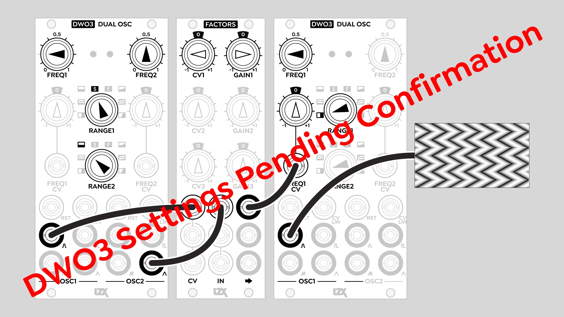

Voltage Controlled Inversion
Factors voltage controlled inversion
Factors modulation control

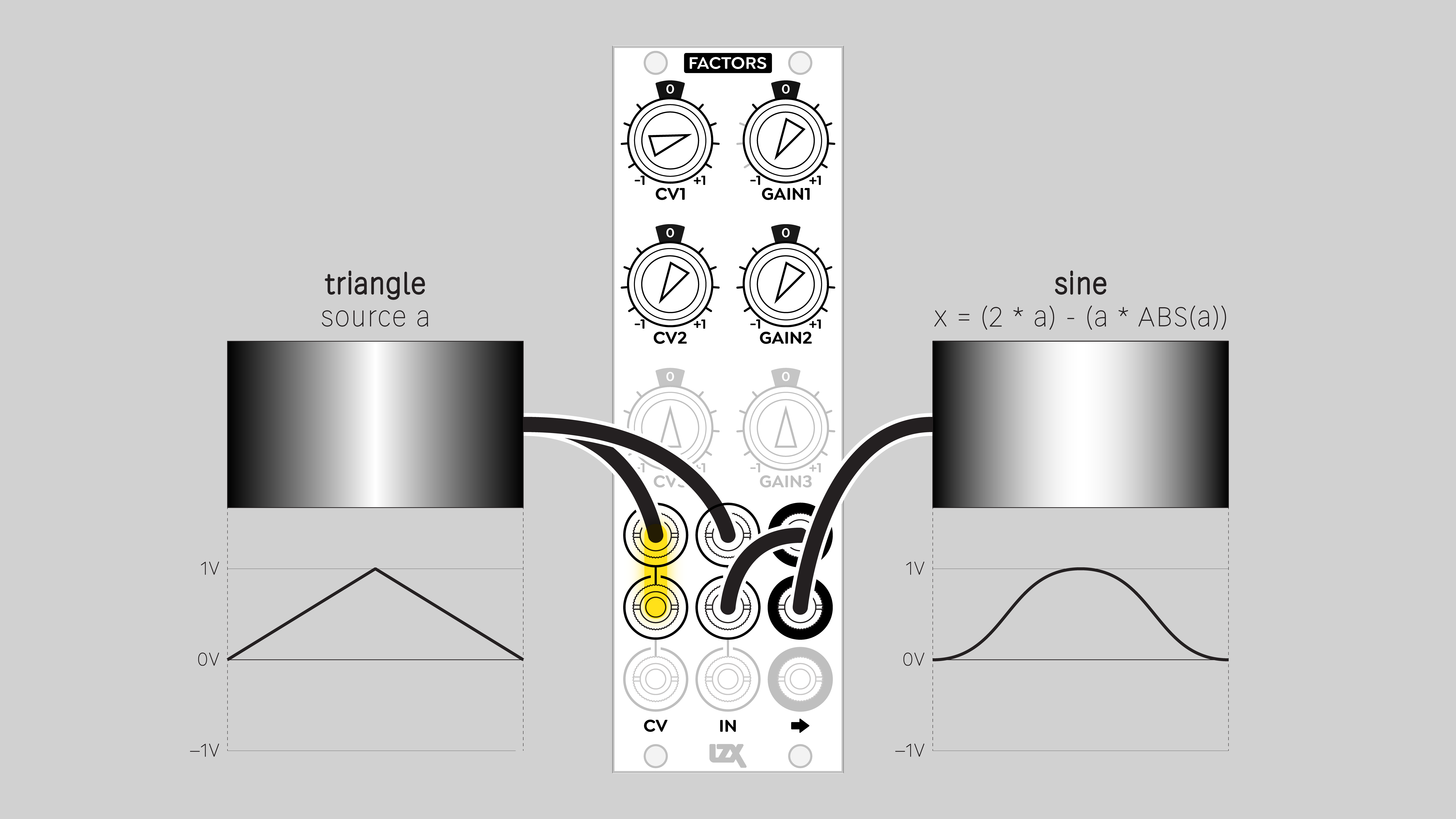

Sine Shaping
Factors sine shaping

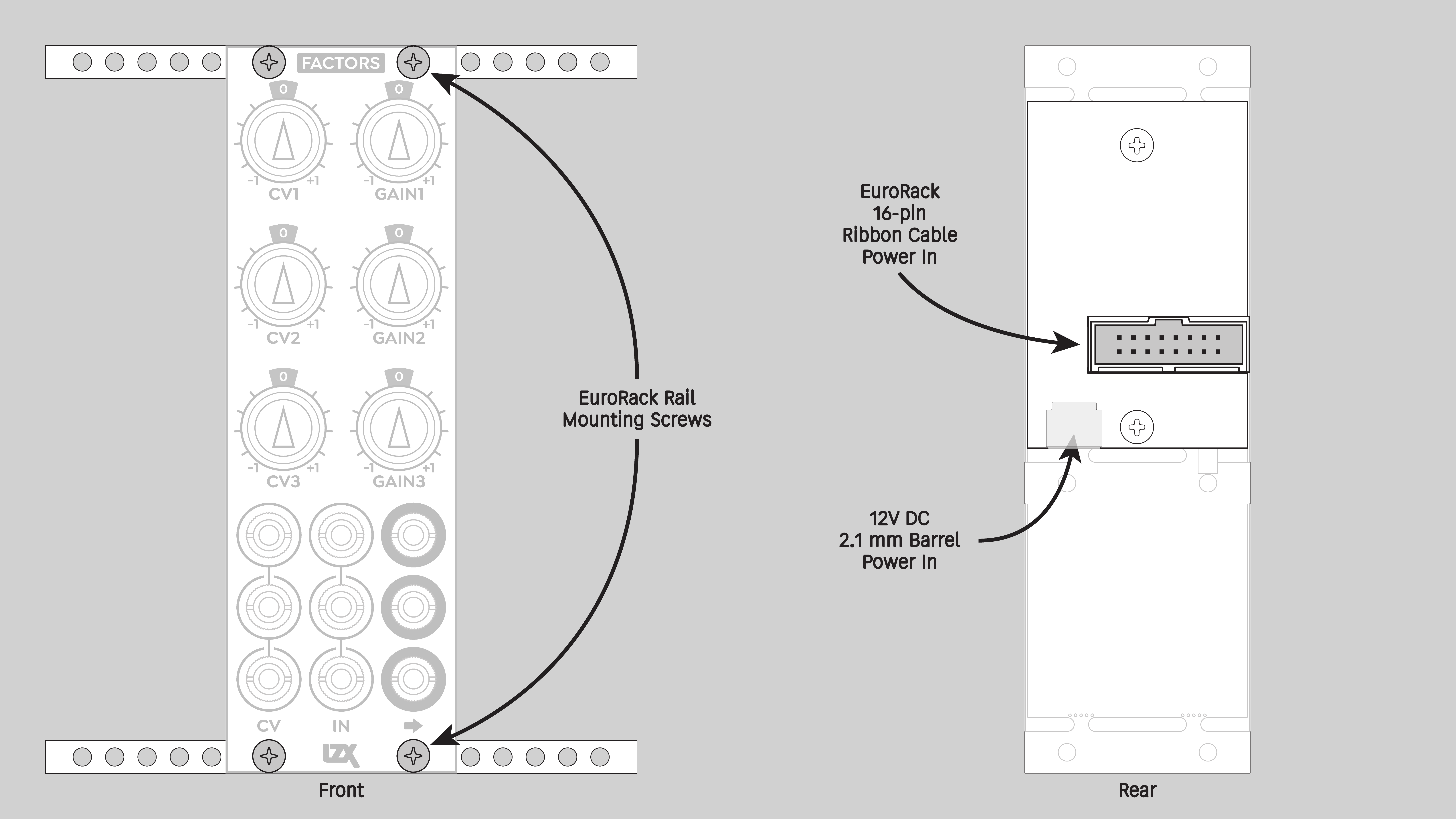

Installation
Factors installation
Requirements
  • EuroRack enclosure
Procedure
