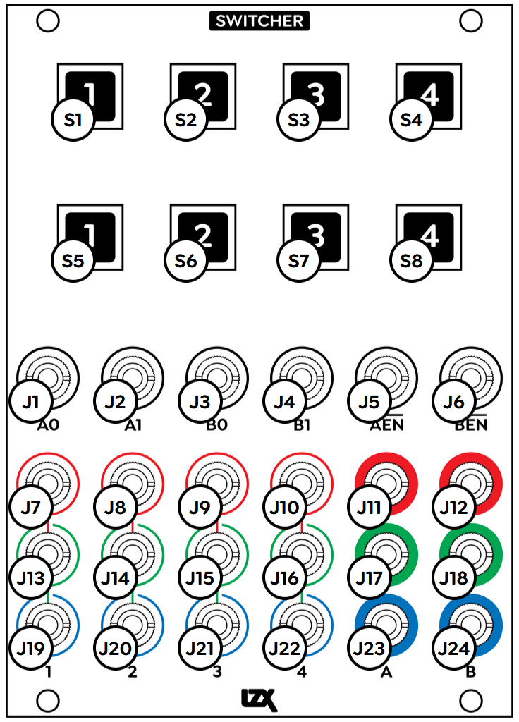

Switcher: labeled front panel controls
Jack Function
J1
Select <br />A0 in
J2
Select <br />A1 in
J3
Select <br />B0 in
J4
Select <br />B1 in
J5
Disable <br />A in
J6
Disable <br />B in
J7
1 Red in
J8
2 Red in
J9
3 Red in
J10
4 Red in
J11
A Red out
J12
B Red out
J13
1 Green in
J14
2 Green in
J15
3 Green in
J16
4 Green in
Jack Function
J17
A Green out
J18
B Green out
J19
1 Blue in
J20
2 Blue in
J21
3 Blue in
J22
4 Blue in
J23
A Blue out
J24
B Blue out
Switch Function
S1
A1
S2
A2
S3
A3
S4
A4
S5
B1
S6
B2
S7
B3
S8
B4
