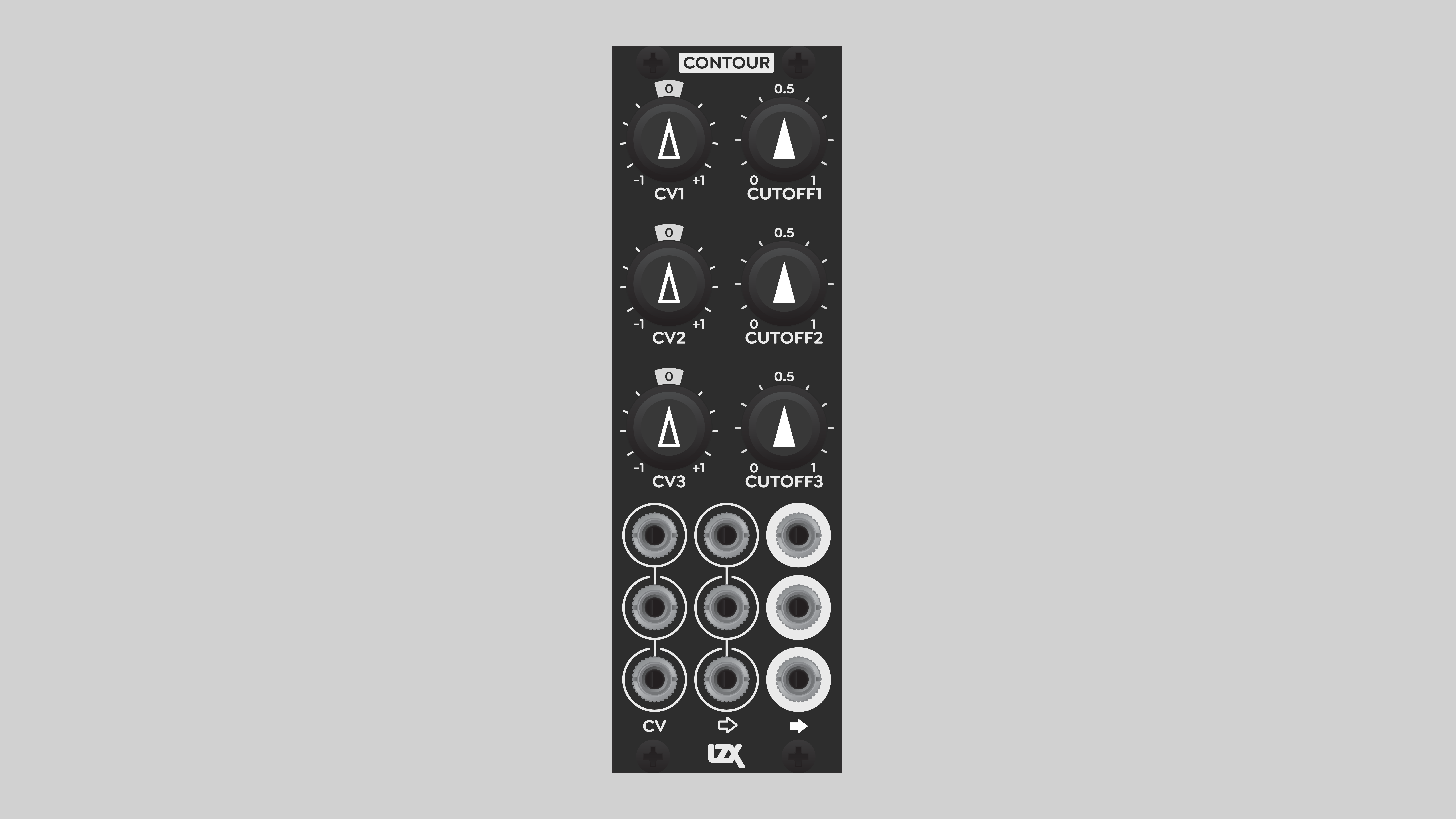

Contour front panel
Contour is a triple voltage-controlled high-pass filter for extracting edge transitions from video images and patterns. Its analog circuitry imparts unique qualities to the picture. From glitchy streaks to spectral afterimages, Contour produces effects that exemplify the art form of video synthesis. These are exactly the sorts of effects that set analog video synthesis apart from the technically perfect but sometimes stilted visual language of digital video. In contrast to the antiseptic, sterile quality that often renders digital video less than compelling, the otherworldly strangeness of Contour can only come from the messy and unpredictable processes of analog video synthesis.

Controls & Connectors
Contour is divided into three identical channels. Each has a Filter Output on the right, a Filter Input in the center, and a Cutoff CV input on the left. The Cutoff CV input allows external modulation of the filter cutoff threshold. As always in Gen3 modules, the inputs are internally self-normalled, so that a signal flows from a patched input to the unpatched inputs below it.
Each channel has two potentiometers. The Cutoff knobs to the right set the frequency threshold for the high-pass filter. Turning the knob to the right increases the Cutoff, filtering out more of the low frequency components of the signal. The visual effect of a high Cutoff is an image that’s mostly black except for the edges. Reducing the Cutoff allows more of the original image to pass through the filter, revealing more of the larger compositional elements, and often smearing them to the right of the screen in a unique way.
The Cutoff CV Depth knobs on the left are attenuverters that multiply the incoming Cutoff CV signal before it’s added to the filter Cutoff frequency. At the center position, the Cutoff CV input is disabled. When the knob is turned clockwise, to the right, a positive Cutoff CV voltage increases the Cutoff frequency. When turned counterclocwise, to the left, a positive Cutoff CV decreases the Cutoff frequency.
Again, as always in Gen3 modules, the CV inputs can accept video rate signals. This means we can use an image or pattern to alter the Cutoff frequency, for an extra dimension of visual weirdness.

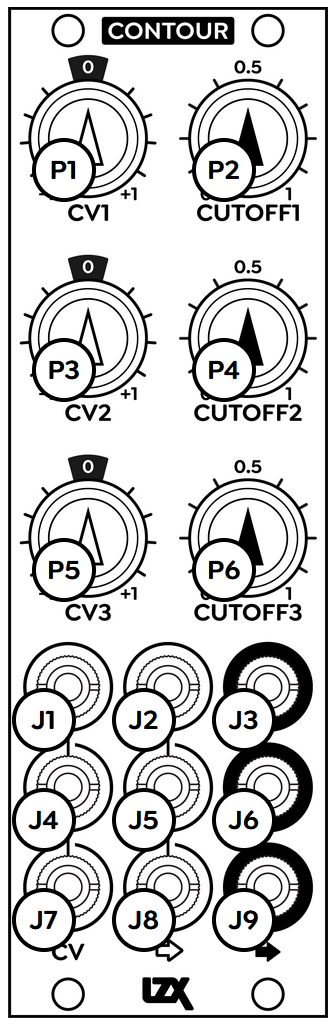

Contour: labeled front panel controls
Jack Function
J1
Filter 1 Cutoff <br />CV in
J2
Filter 1 in
J3
Filter 1 out
J4
Filter 2 Cutoff <br />CV in
J5
Filter 2 in
J6
Filter 2 out
J7
Filter 3 Cutoff <br />CV in
J8
Filter 3 in
J9
Filter 3 out
Potentiometer Function
P1
Filter 1 Cutoff <br />CV Depth
P2
Filter 1 Cutoff
P3
Filter 2 Cutoff <br />CV Depth
P4
Filter 2 Cutoff
P5
Filter 3 Cutoff <br />CV Depth
P6
Filter 3 Cutoff
