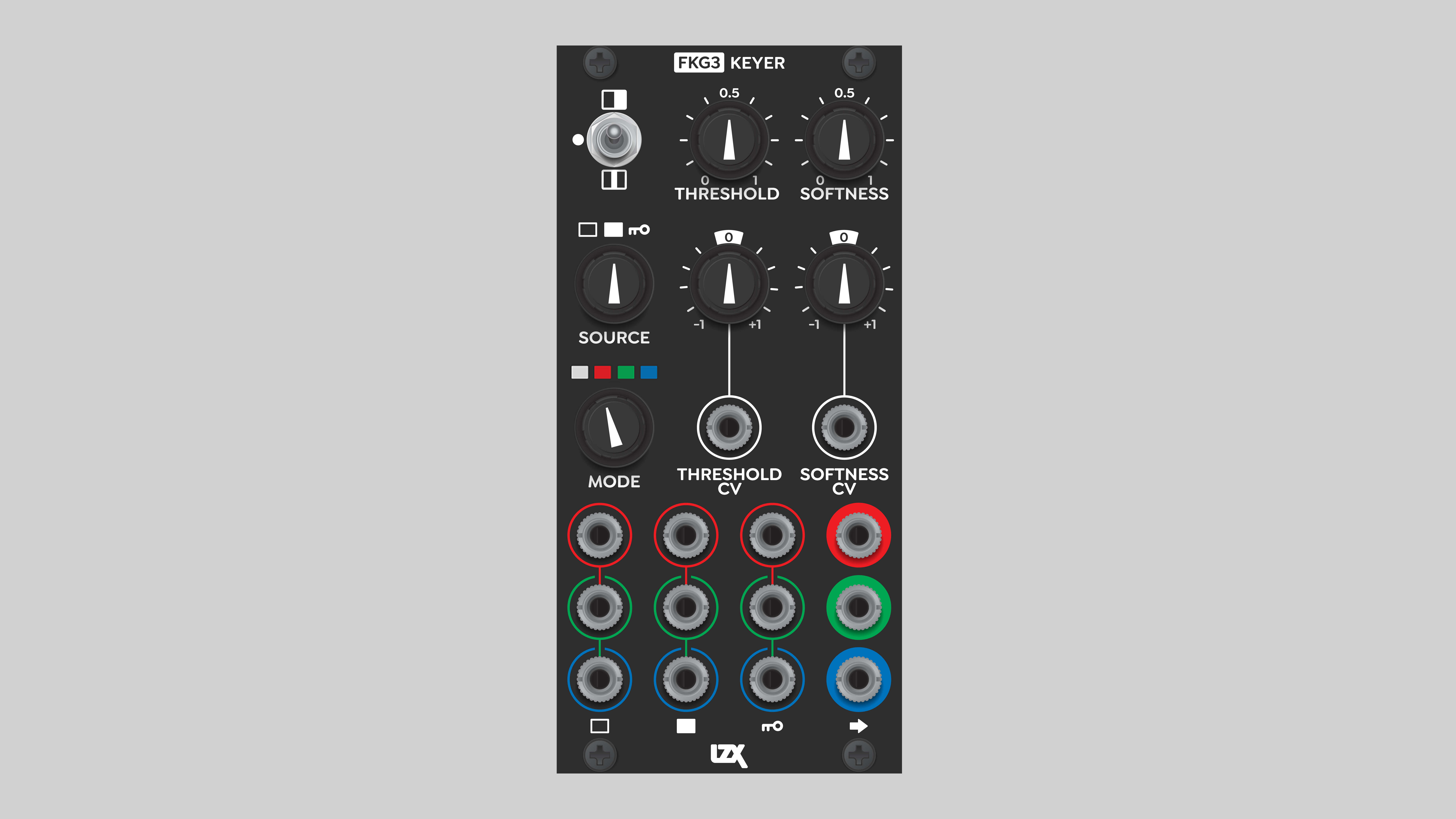

FKG3 front panel
FKG3 serves a wide range of creative image compositing functions. It’s a key generator and RGB fader in one, allowing two RGB triplets to be layered with an internal or external key. Keys can be cut based upon luminance, or any one of the RGB color components. The edge of the key can range from hard to soft. The key softness can be increased so much that FKG3 becomes a crossfader with no key edge at all. Threshold and Softness can be voltage controlled with video rate signals. RGB and monochrome sources can be freely composited thanks to internally self-normalled input jacks.
Keying is based on analog logic. This is what allows FKG3 to perform a variety of fades, hard keys, and soft keys. It’s also the "key" to controlling how chroma keys are cut. The individual RGB inputs open up creative possibilites that aren’t possible with the conventional key bus of an ordinary video mixer.
The analog logic of FKG3 can be applied to any signal, not just a video image. Low frequency control voltages can also be processed.
FKG3 has a bonus feature: Edge outline mode. Edge mode cuts a narrow window key, knocking out values above and below the key threshold. All of these features take FKG3 far beyond what a plain vanilla mixer can do.

Two rotary switches and one toggle switch define the settings for the key polarity, edge mode, key source, and key color mode.
The most important control is the Key Source rotary switch. This chooses which set of inputs is sent to the key generator to cut the stencil. It’s labeled with three icons: a black rectangle for the Background inputs, a white rectangle for the Foreground inputs, and a skeleton key for the external Key inputs.
The other rotary switch chooses the Key Mode, determining which color channel(s) are used to cut the key. The white rectangle chooses Luminance Key mode. In this mode, the RGB channels of the Key Source are summed according to the luminance formula described in the Operation section below. The summed luminance value is sent to the key generator.
The Red, Green, and Blue settings of the Key Mode switch choose the color channel for Chroma Key mode. A key is cut based on the values of the RGB primaries. A detailed explanation follows in the Operation section. The short version is that the chosen color primary is knocked out. The key generator sets the key to a low value wherever that primary is pure. The compositor then makes that area transparent.
The toggle switch at the upper left has three positions. In the center, default position, the key is not inverted. The key is cut based on the brightest values of the Key Source. When the switch is set to its upper position, the polarity is inverted, and the key is cut based on the darker values of the Key Source. By adjusting both the Key Source and the polarity, we can achieve the visual effect of placing the Foreground input "on top" or "in front" of the Background input, or vice versa.
In the lower position, the toggle switch enables Edge mode. This is not an edge detector like the Contour module. It’s a type of window key, where the key has two thresholds instead of one. Values slightly above and slightly below the Threshold are knocked out. The "top" or "front" input becomes an "edge" with variable Softness, superimposed over the "bottom" or "back" input.

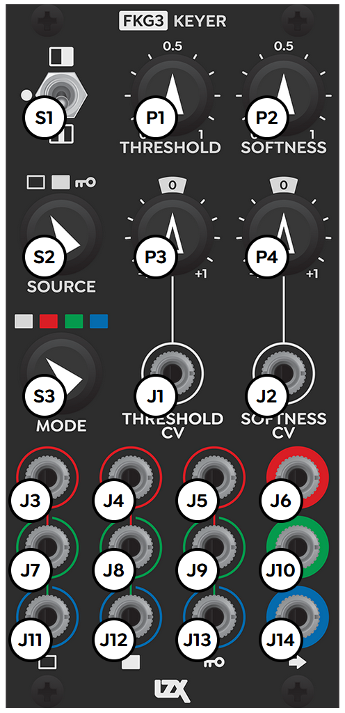

FKG3: labeled front panel controls
Jack Function
J1
Threshold CV in
J2
Softness CV in
J3
Red Background in
J4
Red Foreground in
J5
Red Key in
J6
Red out
J7
Green Background in
J8
Green Foreground in
J9
Green Key in
J10
Green out
J11
Blue Background in
J12
Blue Foreground in
J13
Blue Key in
J14
Blue out
Switch Function
S1
Edge / Invert
S2
Key Source
S3
Key color mode
Pot Function
P1
Threshold
P2
Softness
P3
Threshold CV Depth
P4
Softness CV Depth
