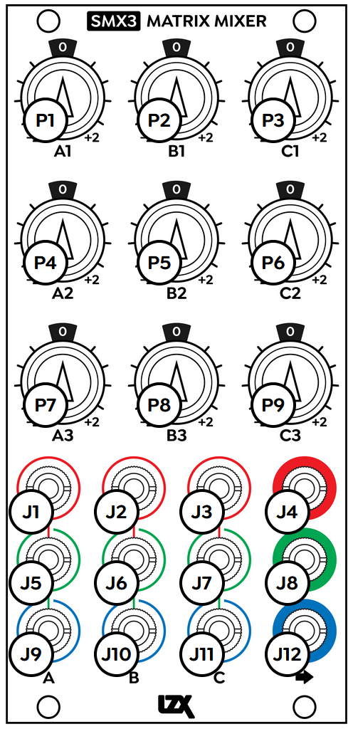

The nine inputs of SMX3 are arranged in three rows, numbered 1, 2, and 3. The rows are color-coded as red, green, and blue, but any signal may be patched into the inputs. The sum of each row appears at the corresponding output on the right of the module. The internal normalling of the inputs allows signals to flow downward to the inputs below.
The three columns of inputs are labeled A, B, and C. Three inputs in each column allow the mixing of three signal triplets, such as RGB components.
Each of the nine inputs passes through a polarizer circuit controlled by the corresponding potentiometer, labeled A1 through C3. Unlike the attenuverters seen on many other LZX modules, the SMX3 pots are capable of +/- 2x amplification. At the center position, the multiplication factor of the incoming signal is zero, and the source is not added to the mix. Fully clockwise rotation amplifies the source by a factor of two. Fully counter-clockwise rotation multiplies the source by a factor of negative two. Some SMX3 front panels are labeled +1 and -1 to indicate approximate knob positions of positive and negative unity gain.

SMX3: labeled front panel controls
Jack Function
J1
A1 in
J2
B1 in
J3
C1 in
J4
Mixer 1 out
J5
A2 in
J6
B2 in
J7
C2 in
J8
Mixer 2 out
J9
A3 in
J10
B3 in
J11
C3 in
J12
Mixer 3 out
Potentiometer Function
P1
A1 gain
P2
B1 gain
P3
C1 gain
P4
A2 gain
P5
B2 gain
P6
C2 gain
P7
A3 gain
P8
B3 gain
P9
C3 gain
