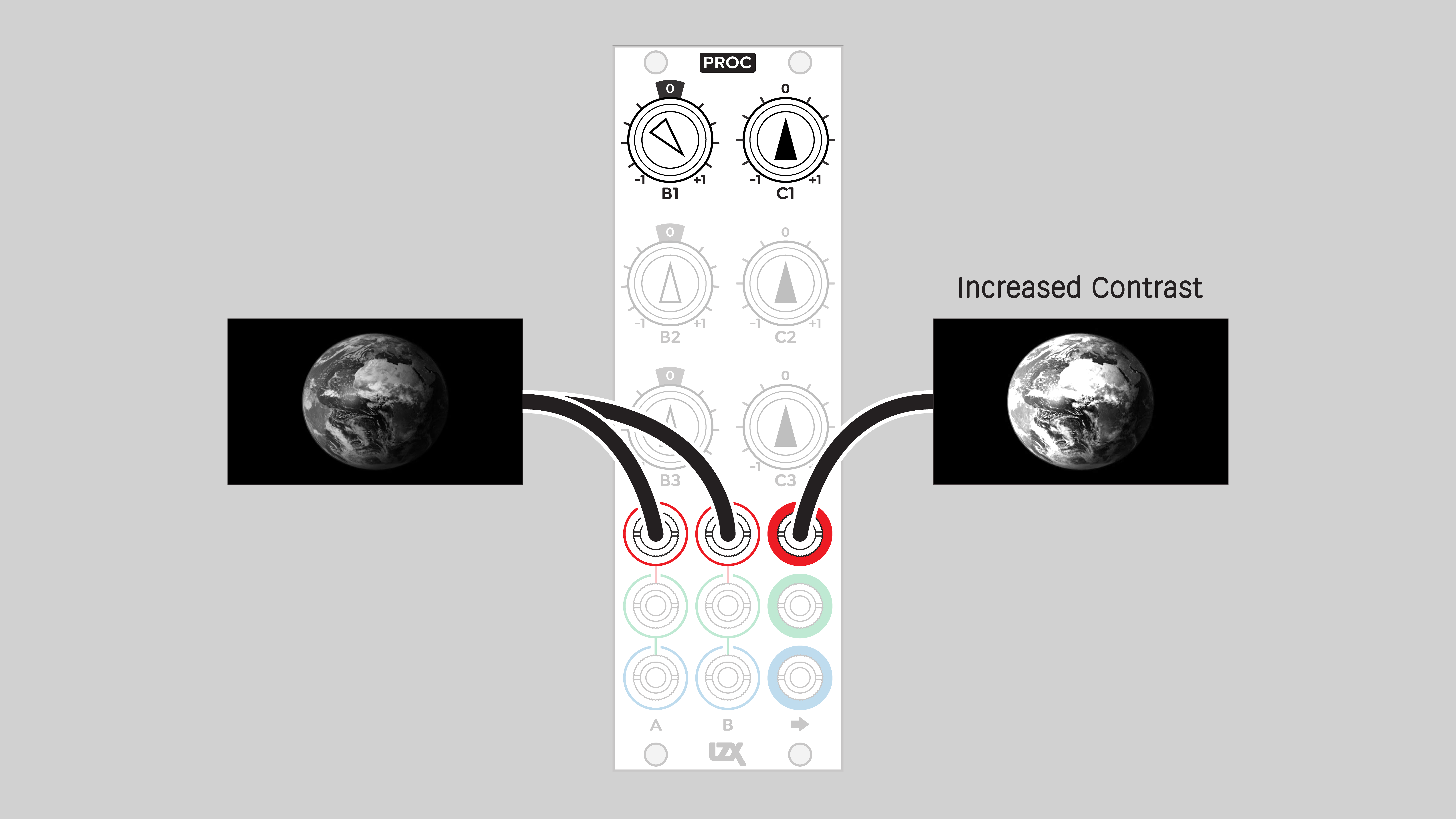

  • Attenuate or amplify values
  • amplitude, gain, contrast, white point
  • Raise or lower values
  • bias, offset, brightness, black level, pedestal

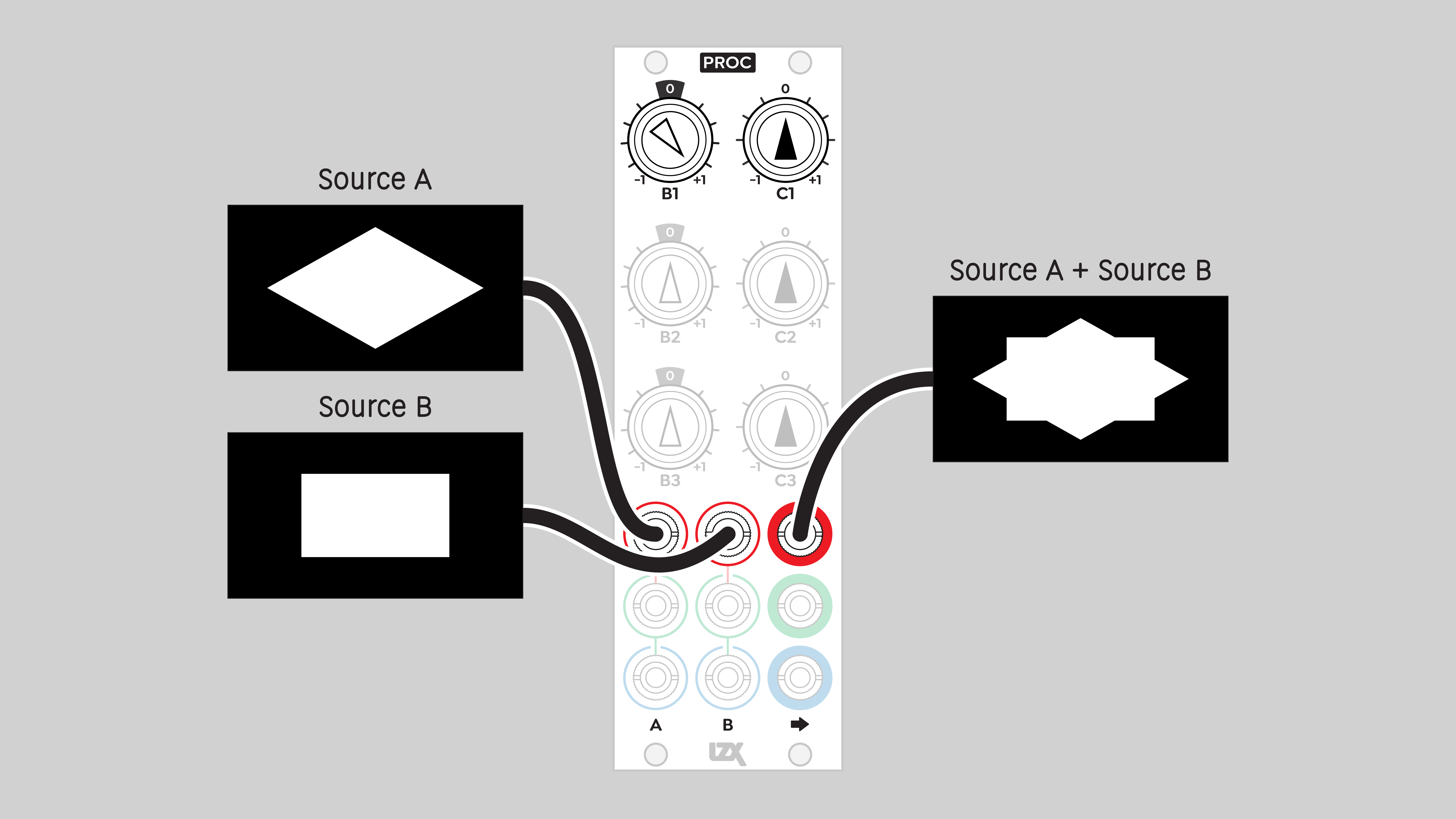

  • Add

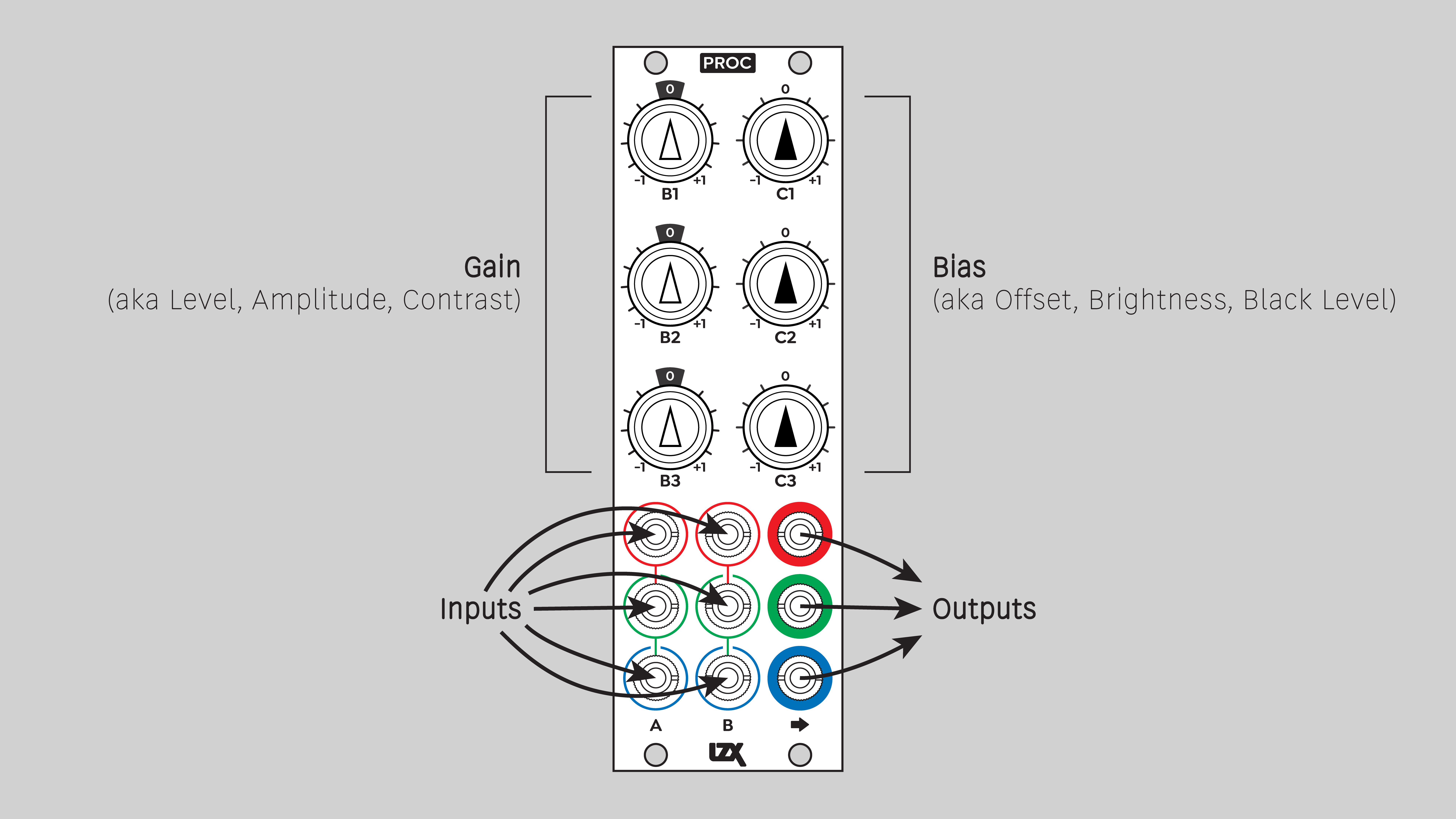

Proc consists of three identical channels. The inputs to each channel are arranged in rows 1, 2, and 3. Rows are color-coded red, green, and blue, respectively, but this is only for convenience. Any video or control signal can be patched into any input.
Each channel has two input jacks, in columns A and B.
Each channel has two potentiometer knobs, Gain and Bias.
Proc controls and connectors

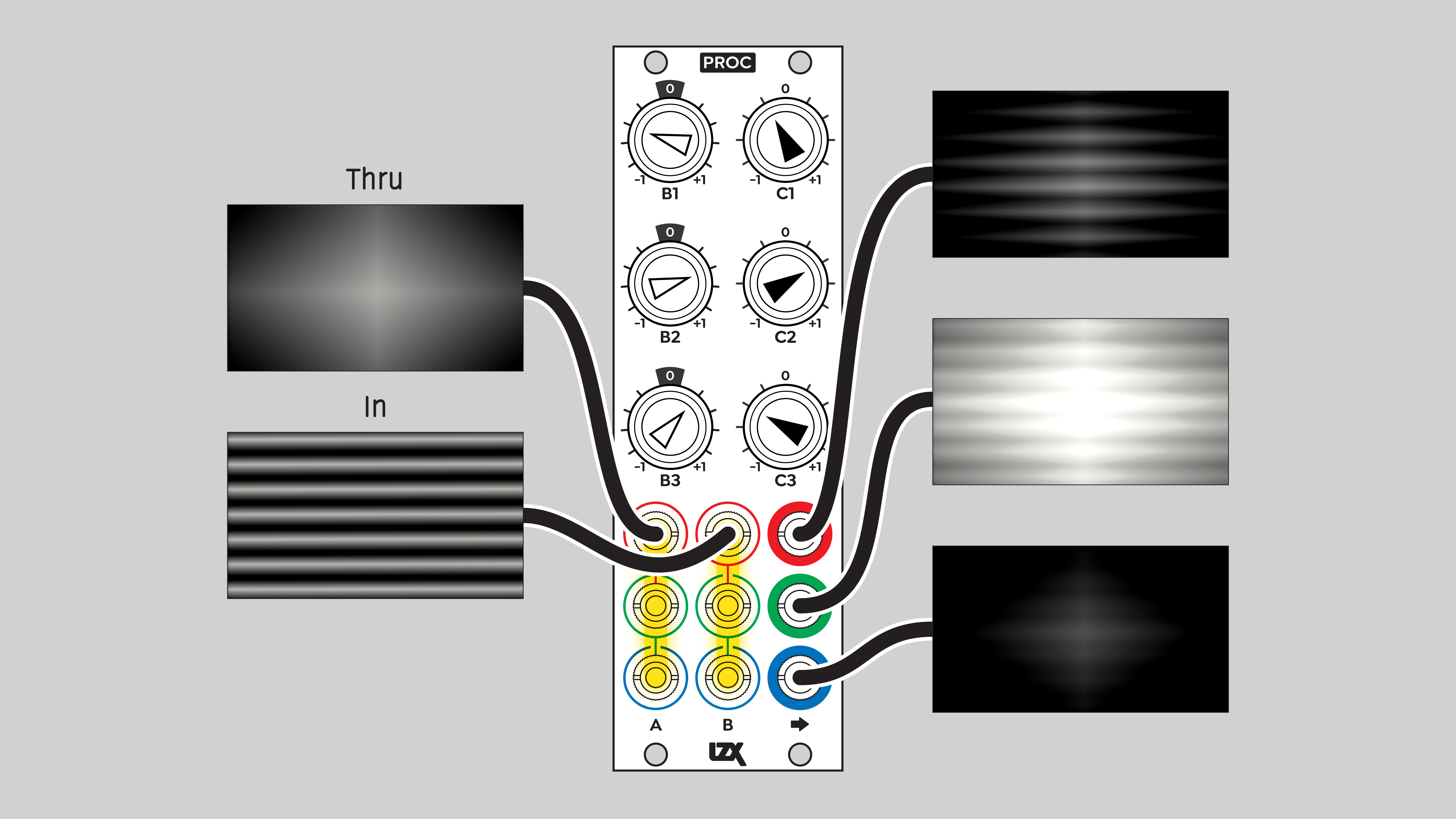

The inputs are internally self-normalled to cascade from top to bottom. A signal patched into a top row input flows to the other inputs in that column.
Proc internal normalling
Operation

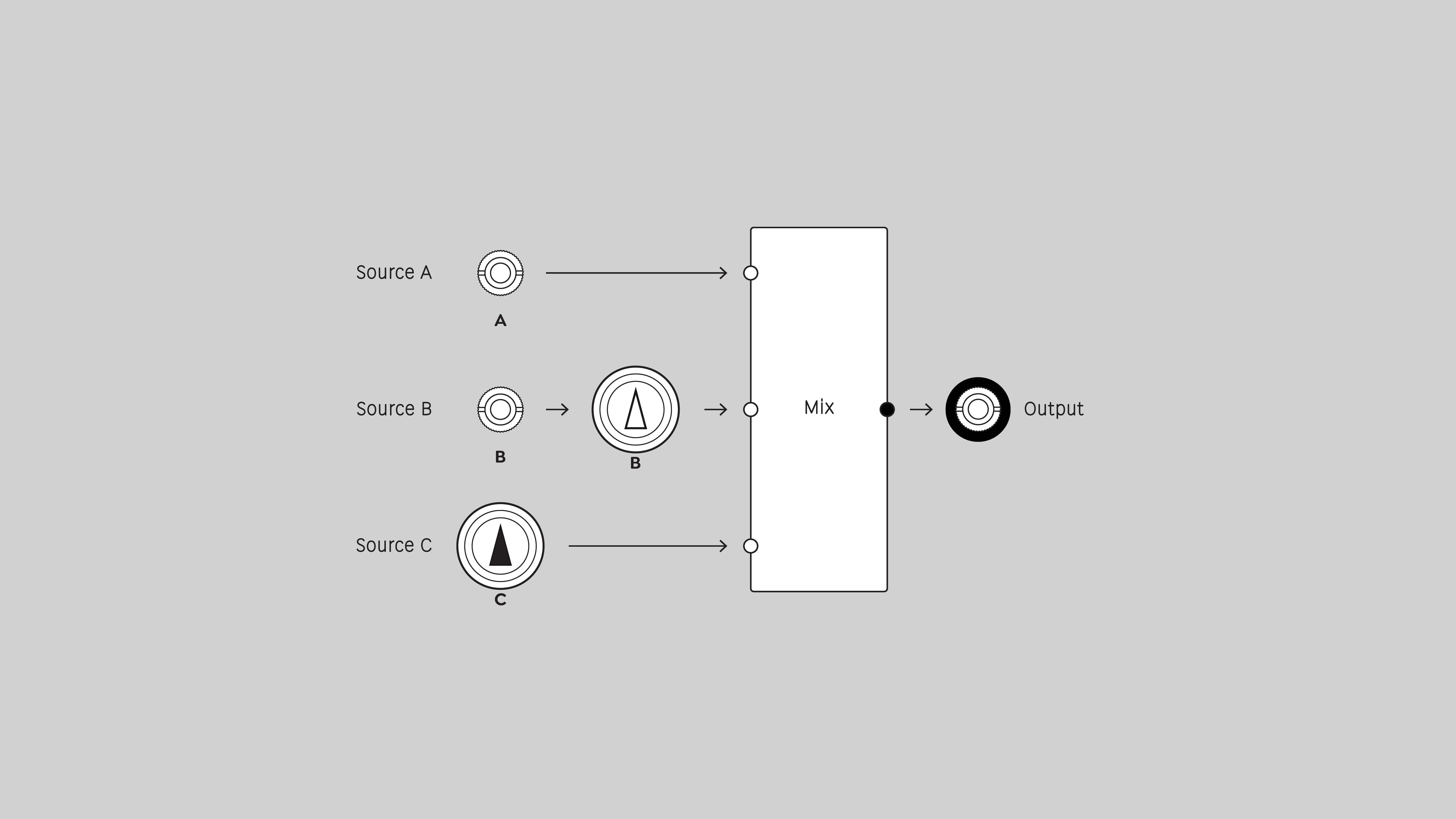

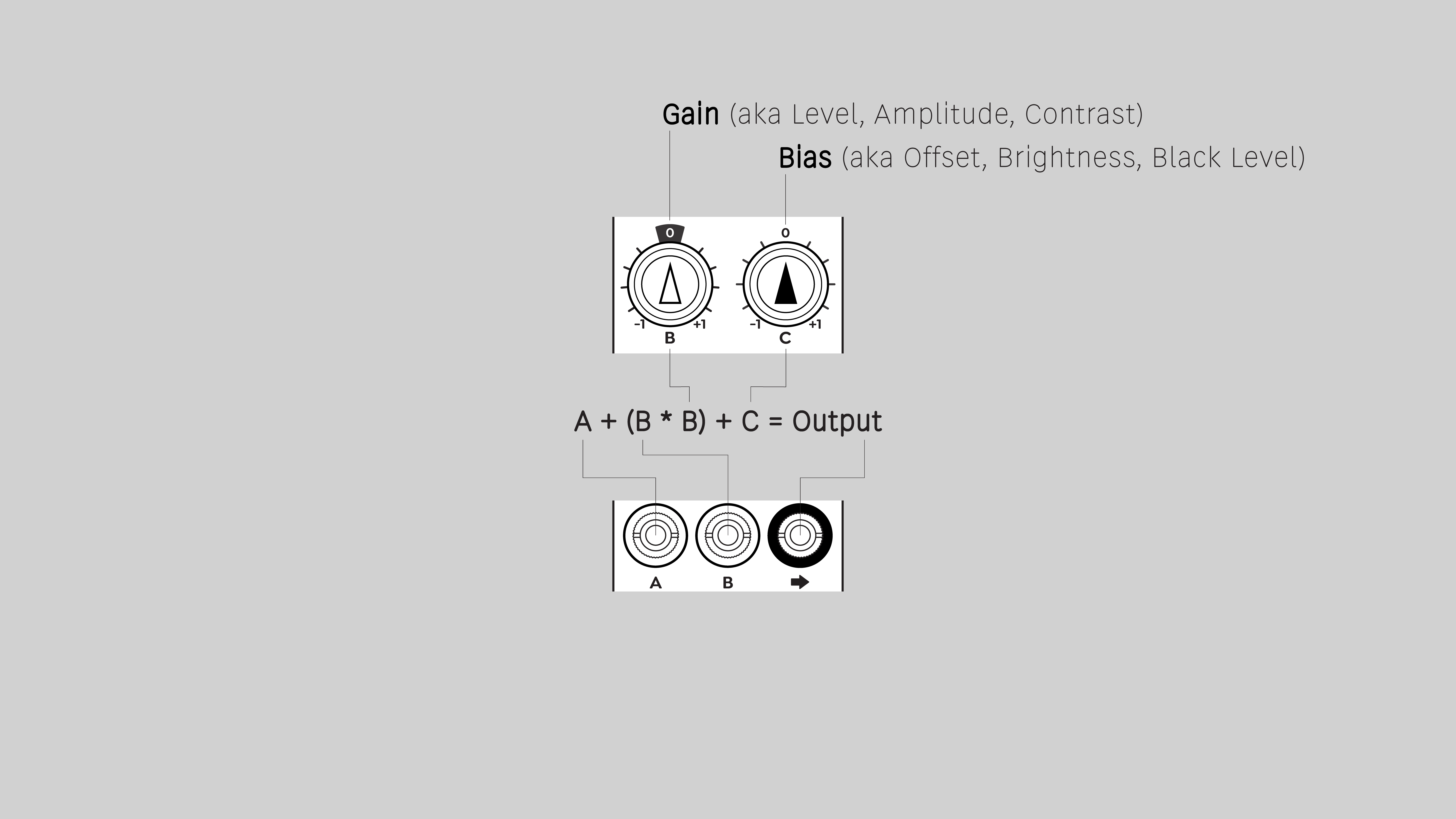

Each channel sums the A and B inputs, plus an internally generated static voltage C. Input A is added without alteration, so it’s also known as the Thru input. Input B is multiplied by its corresponding Gain knob before being added. It’s also known as the In input.
Proc block diagram
Function block per channel
The output can be expressed the sum of jack A, plus the product of jack B and potentiometer B, plus potentiometer C.
\$jA + (jB \cdot pB) + pC\$
Proc formula

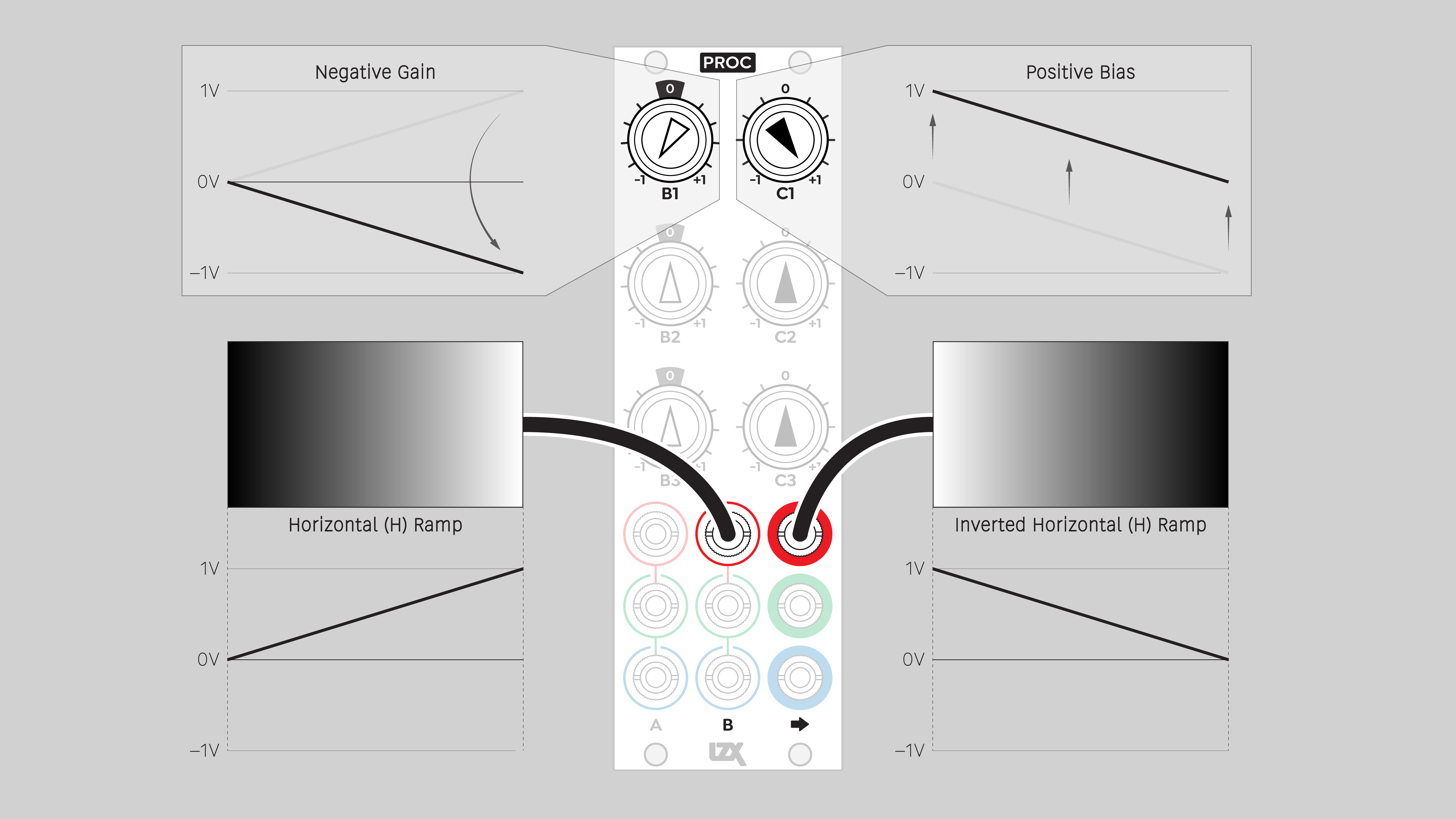

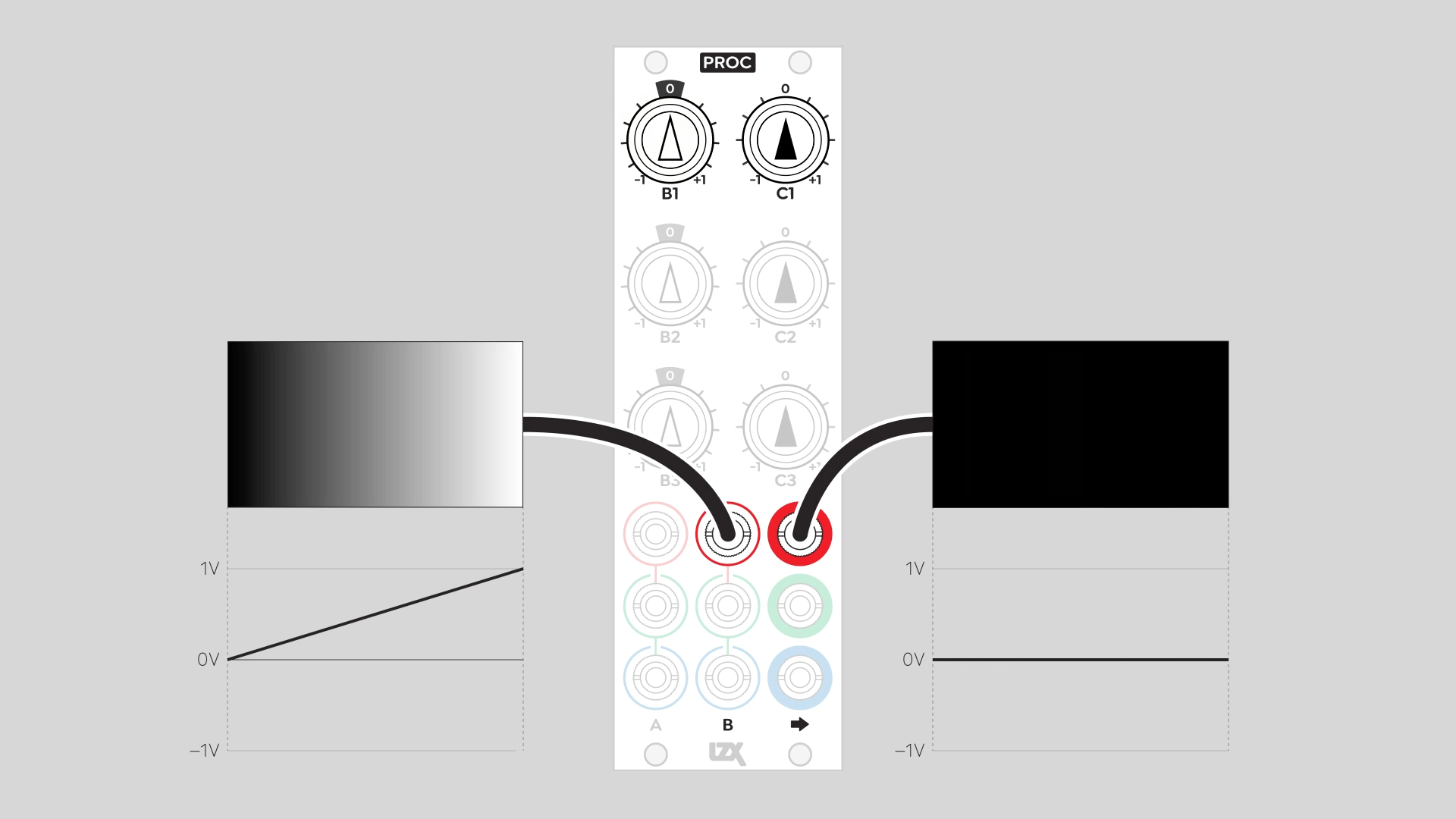

Gain
Each Gain potentiometer, labeled B, can attenuate or invert the value of the signal at the channel’s B input. At the 12 o’clock position, the signal is multiplied by zero, so none of the B input signal is added to the output. Turning the knob clockwise to the right of 12 o’clock increases the amplitude up to the full value of the input signal. Turning the knob counterclockwise to the left of 12 o’clock inverts the signal, sending it into the negative voltage range.

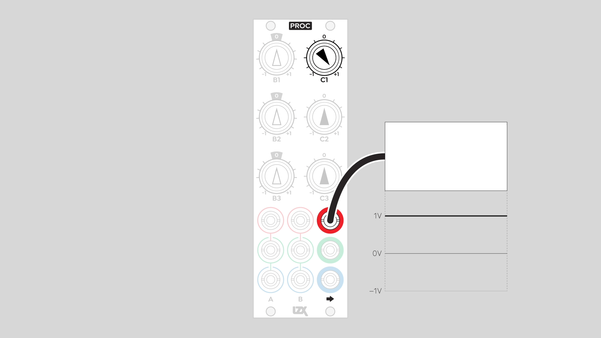

Bias
Each Bias potentiometer, labeled C, adds a static voltage to the output. At the 12 o’clock position, the voltage is zero, so no offset is added to the output. Clockwise rotation to the right of 12 o’clock adds a voltage, biasing the output up. Counterclockwise rotation to the left of 12 o’clock subtracts a voltage, biasing the output down.
Proc gain and bias

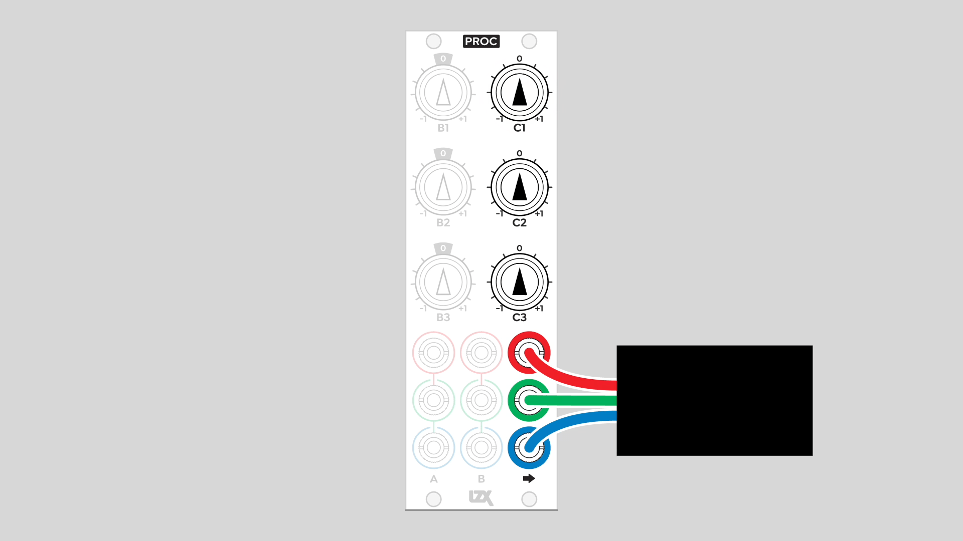

Static voltage
Proc static voltage generator

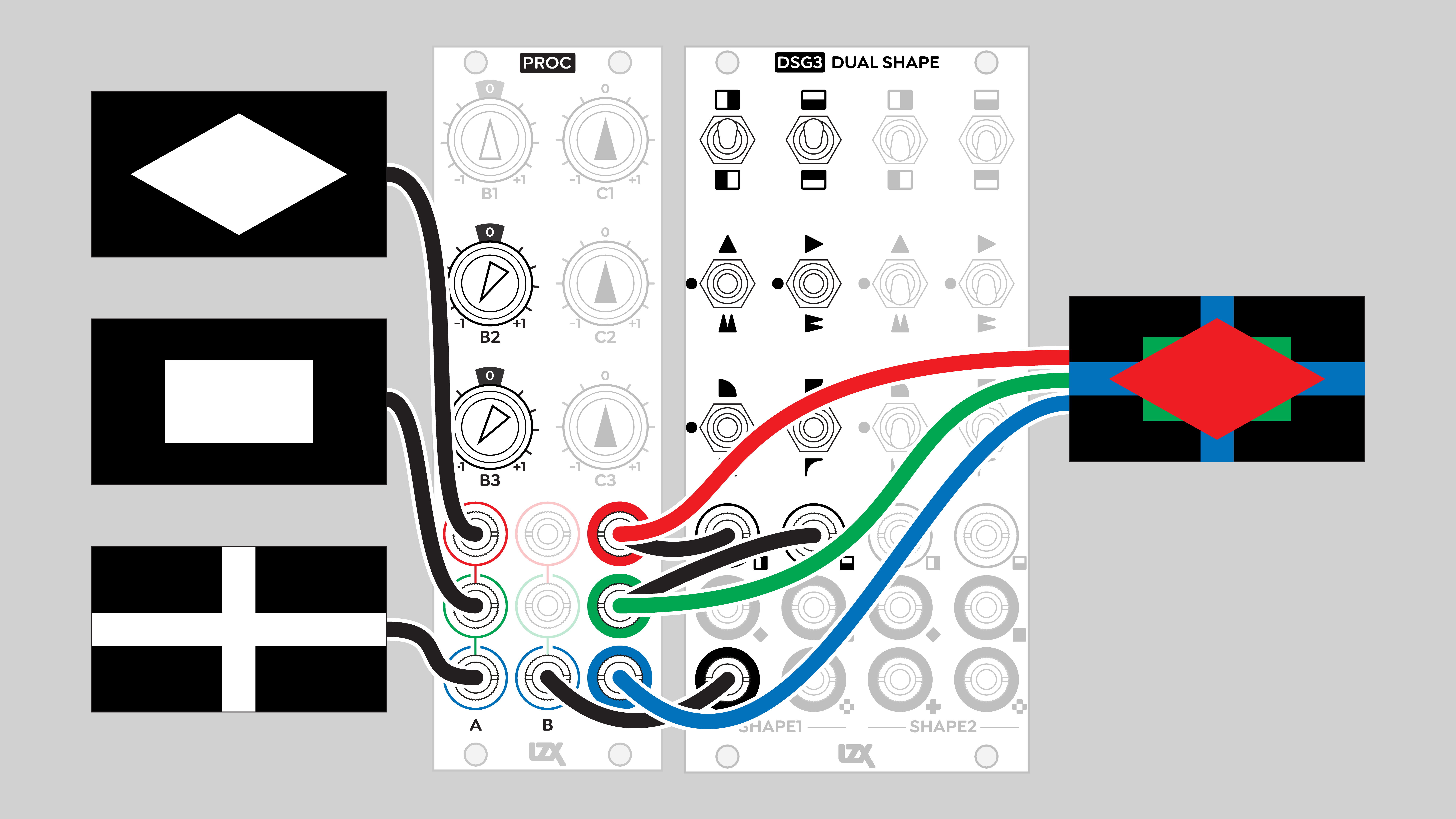

RGB color picker
Proc RGB color picker

Add
Proc addition
Amplify / increase contrast
Proc contrast

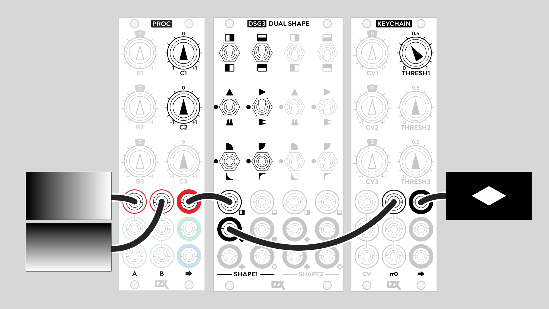

Priority layering
Proc + DSG3 priority layering

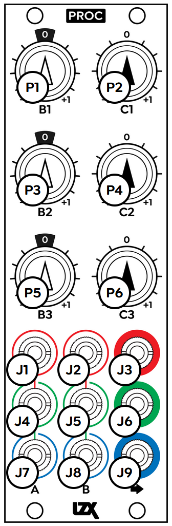

Procedure
Proc: labeled front panel controls
Jack Function
J1
A1 in (thru)
J2
B1 in
J3
Channel 1 out
J4
A2 in (thru)
J5
B2 in
J6
Channel 2 out
J7
A3 in (thru)
J8
B3 in
J9
Channel 3 out
Potentiometer Function
P1
Channel 1 B gain
P2
Channel 1 C bias
P3
Channel 2 B gain
P4
Channel 2 C bias
P5
Channel 3 B gain
P6
Channel 3 C bias
