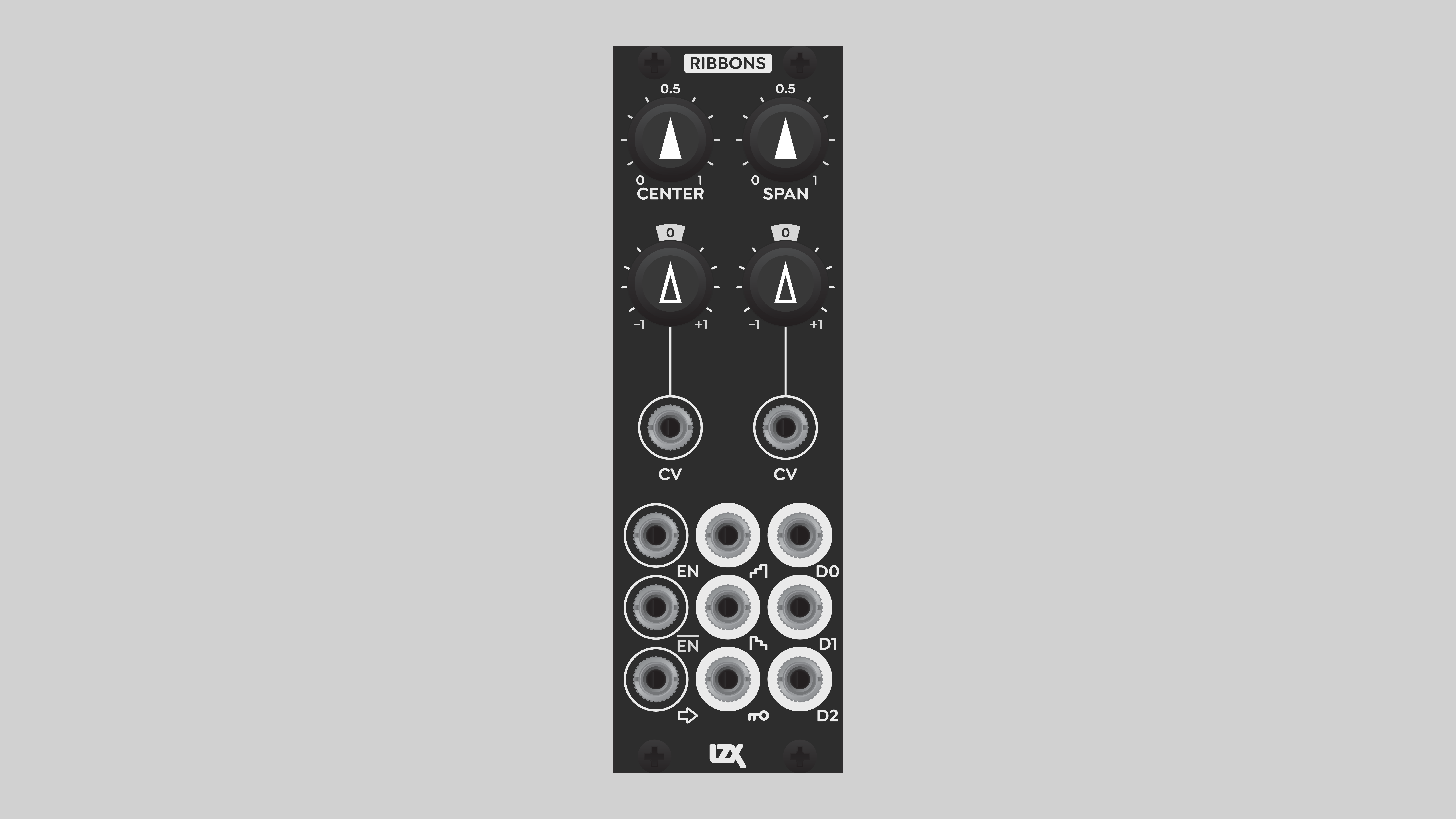

Ribbons front panel

Controls & Connectors
The primary Input to the digitizer is at the extreme lower left. Above that are Enable and Disable inputs. The Enable input is labeled $\mathrm{EN}$. The Disable input is labeled $\mathrm{\overline{EN}}$. The bar over the letters is called a macron, and in this context it indicates logical negation. The input label means "not enable", or disable.
The Enable and Disable inputs are binary. They mask all of the Ribbons outputs. A voltage above 0.5 sent to the Enable input reveals the outputs, a voltage below 0.5 masks off the outputs. The Disable input inverts this behavior: a high signal masks off the outputs, a low signal reveals them. Enable and Disable inputs can be used simultaneously.
Sending a static voltage below 0.5 volts to the Enable input entirely blanks all outputs of Ribbons. Likewise, a static voltage above 0.5 volts at the Disable input also blanks the outputs.
Center and Span potentiometers are at the top of the panel. These define the value ranges of the digitizer. Values within this range are sampled and quantized to one of eight discrete values. Instead of setting the upper and lower bounds directly, we define them with Center and Span. This makes it easy and intuitive to set desired value ranges, even when the source values are constantly changing. Center is the midpoint of values to be digitized, Span is the width of the value range above and below the Center.
In the middle of the module are control voltage inputs to automate or modulate digitizer sampling thresholds. Center CV is on the left, Span CV is on the right. Modulation amount is multiplied by the Center CV Depth and Span CV Depth attenuverter pots, which range from -1 to +1.
At the lower right of the module are the three Digital Outputs. At the top is D0, which is the most significant bit. That’s the highest, left-most digit of the three-bit binary number, or the "fours place". D1 is the middle bit, or the "twos place". At the lower right of the module, D2 is the least significant bit. That’s the lowest, right-most digit of the three-bit binary number, or the "ones place".
The digitized video within Ribbons is also converted back to analog, available from the DAC output. The eight values are combined to a single signal that can stand alone as an interesting visual effect, be further processed to add color, or quantize a low frequency modulation source to a stair-step pattern. A convenient Inverted DAC output expands patching potential.
A bonus Window Key output sends out a binary signal of all eight bands combined. The value range between the upper and lower comparator thresholds, as set by Center and Span, is output as a binary value of 1, or white. Values above the upper threshold and below the lower threshold are output as a binary value of 0, or black.

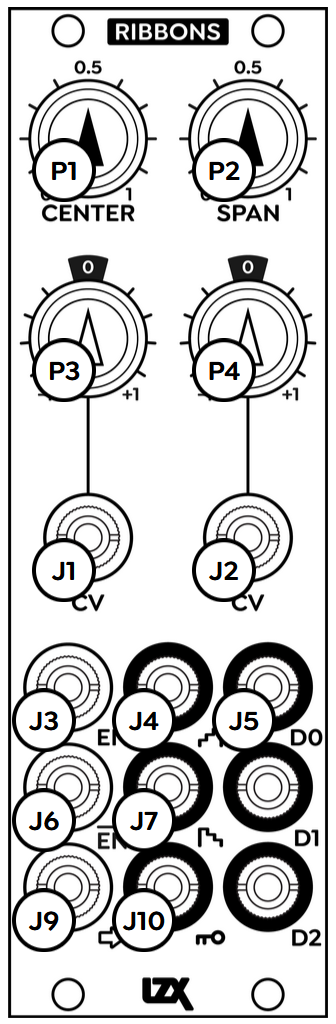

Ribbons: labeled front panel controls
Jack Function
J1
Center CV in
J2
Span CV in
J3
Enable in
J4
DAC out
J5
D0 out
J6
Disable in
J7
Inverted DAC out
J8
D1 out
J9
ADC in
J10
Window Key out
J11
D2 out
Potentiometer Function
P1
Center
P2
Span
P3
Center CV Depth
P4
Span CV Depth
