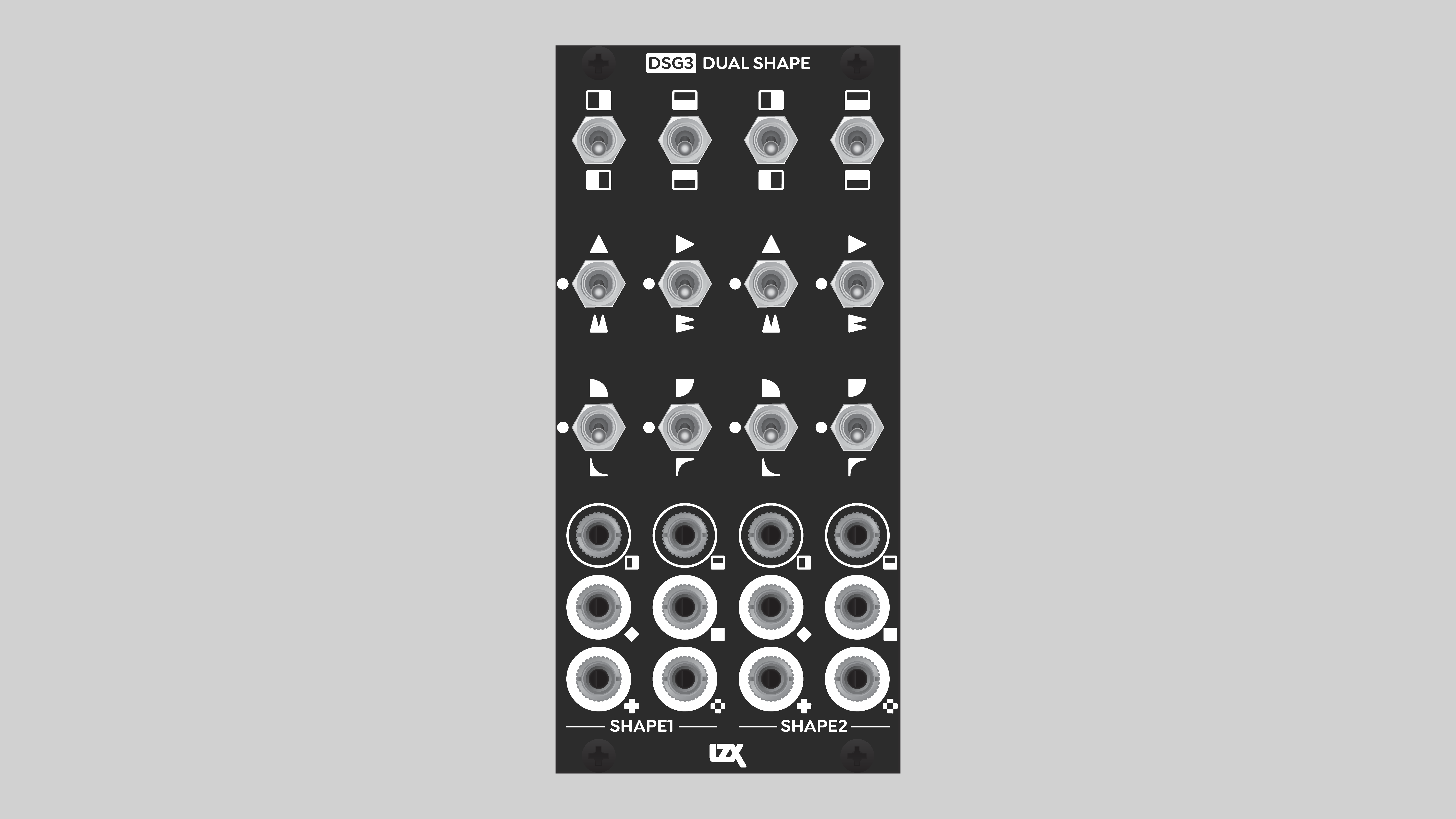

DSG3 front panel
DSG3 is a versatile multi-function generator optimized for creating 2D shapes. Its powerful waveshaping, blending, and logic functions can be applied to external signals or to video ramps generated within DSG3. It can create complex effects, adding great visual interest to patterns and images.

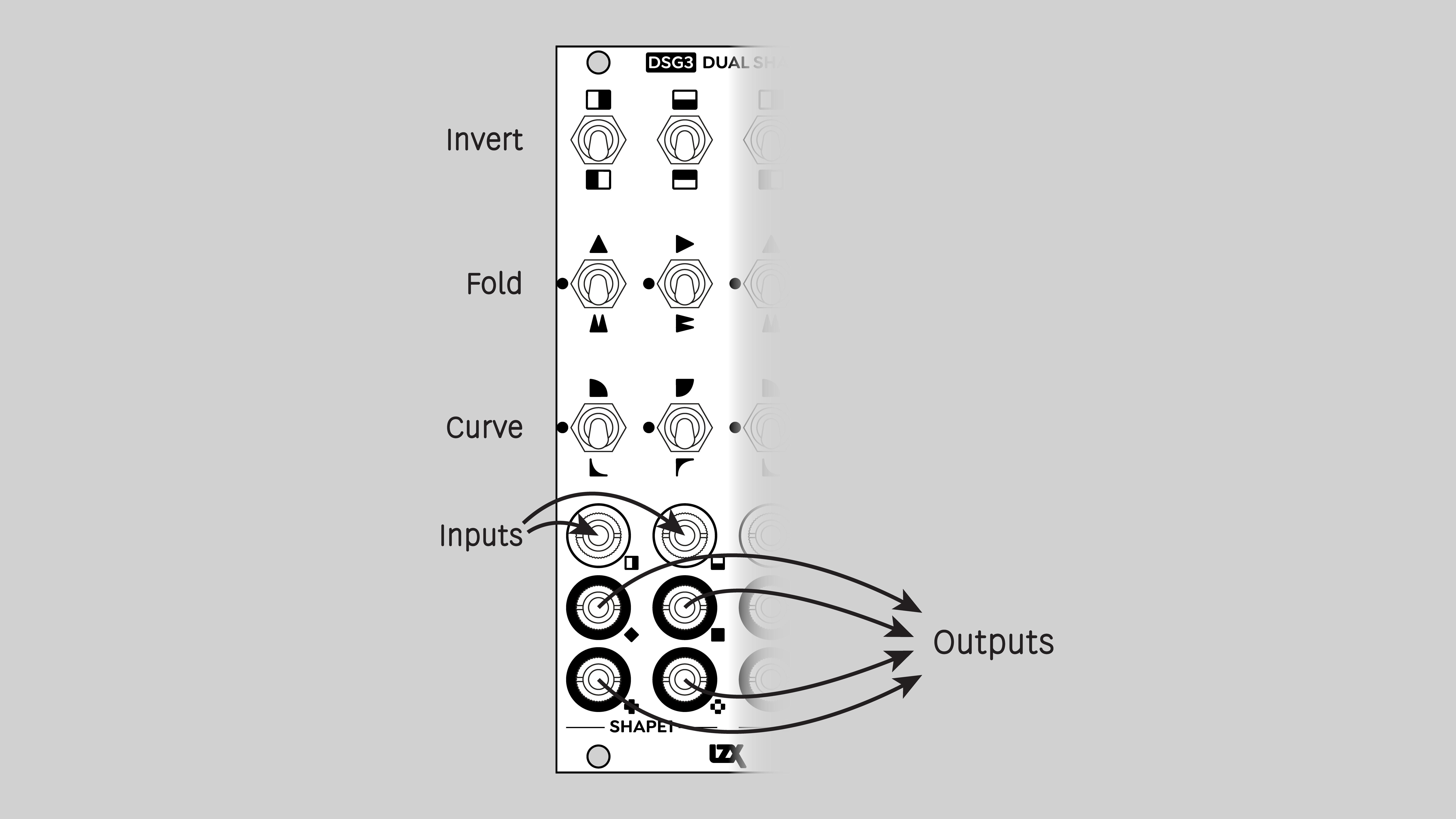

DSG3 consists of two identical submodules, Shape 1 and Shape 2. Each Shape has two inputs, H and V, and four outputs: Average, Minimum, Maximum, and Absolute. Toggle switches enable the various functions: Invert, Fold, and Curve.

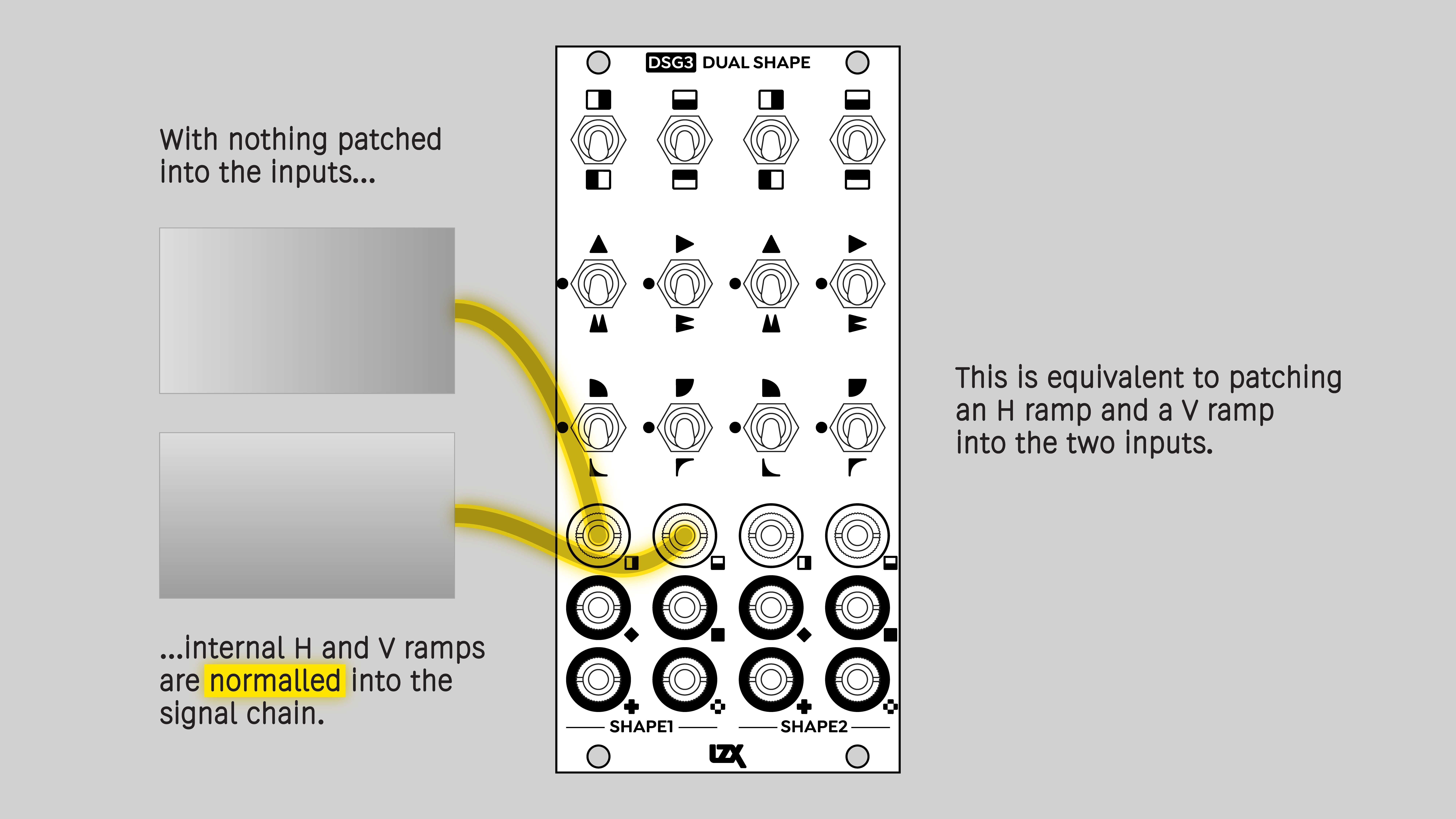

Each input provides a signal to an identical chain of function blocks. The inputs are referred to as H and V, because horizontal and vertical ramps are internally normalled to the inputs. If nothing is patched to an input jack, then an internal H or V ramp provides the signal to the function block chain.
DSG3 internal normalling
Normalled H and V ramps

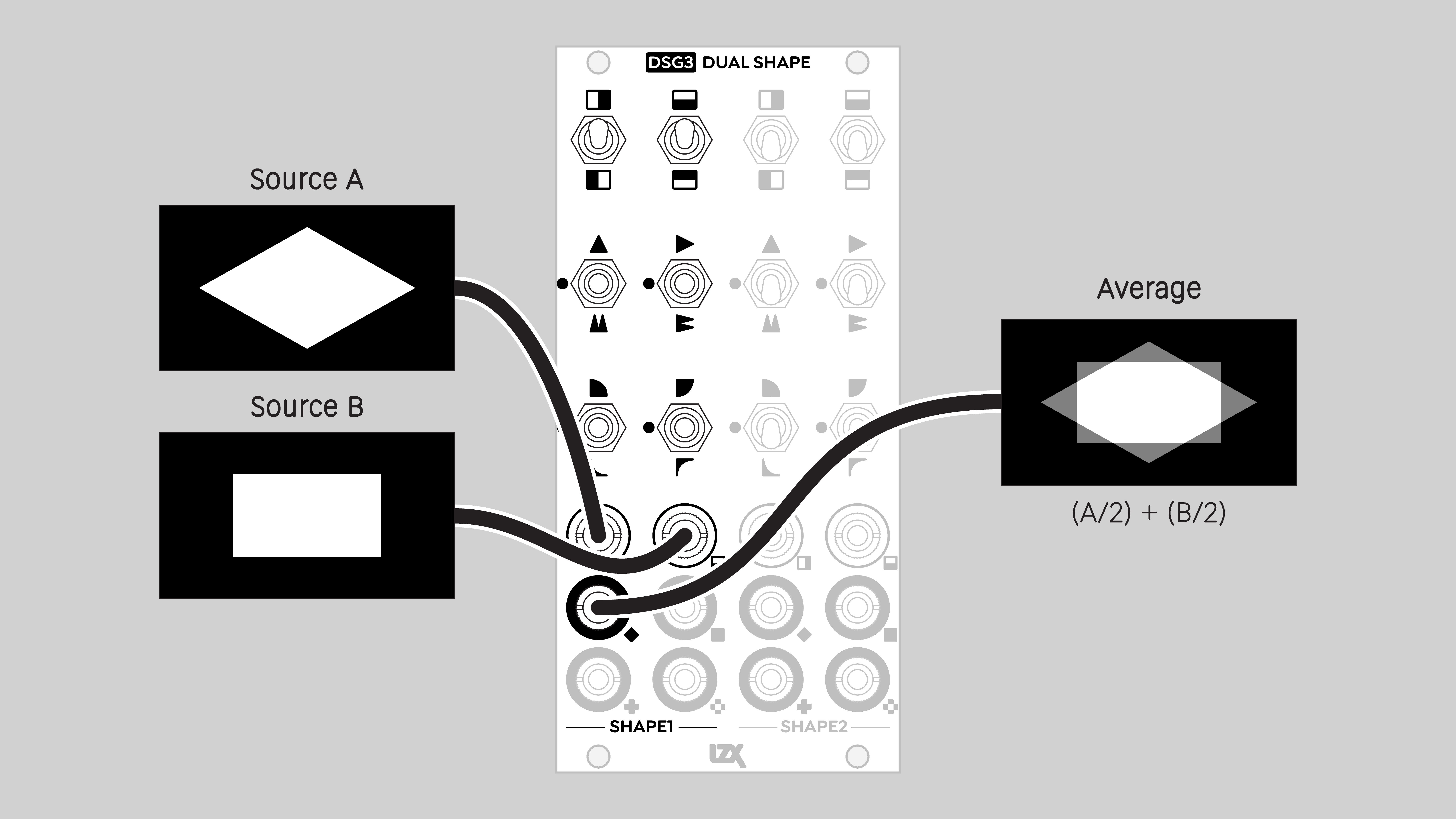

Average
The weighted sum of two input values.
H and V inputs are each divided by two, and the results are summed.
\$\frac{H}{2} + \frac{V}{2}\$
Blend mode: Add
DSG3 Average output

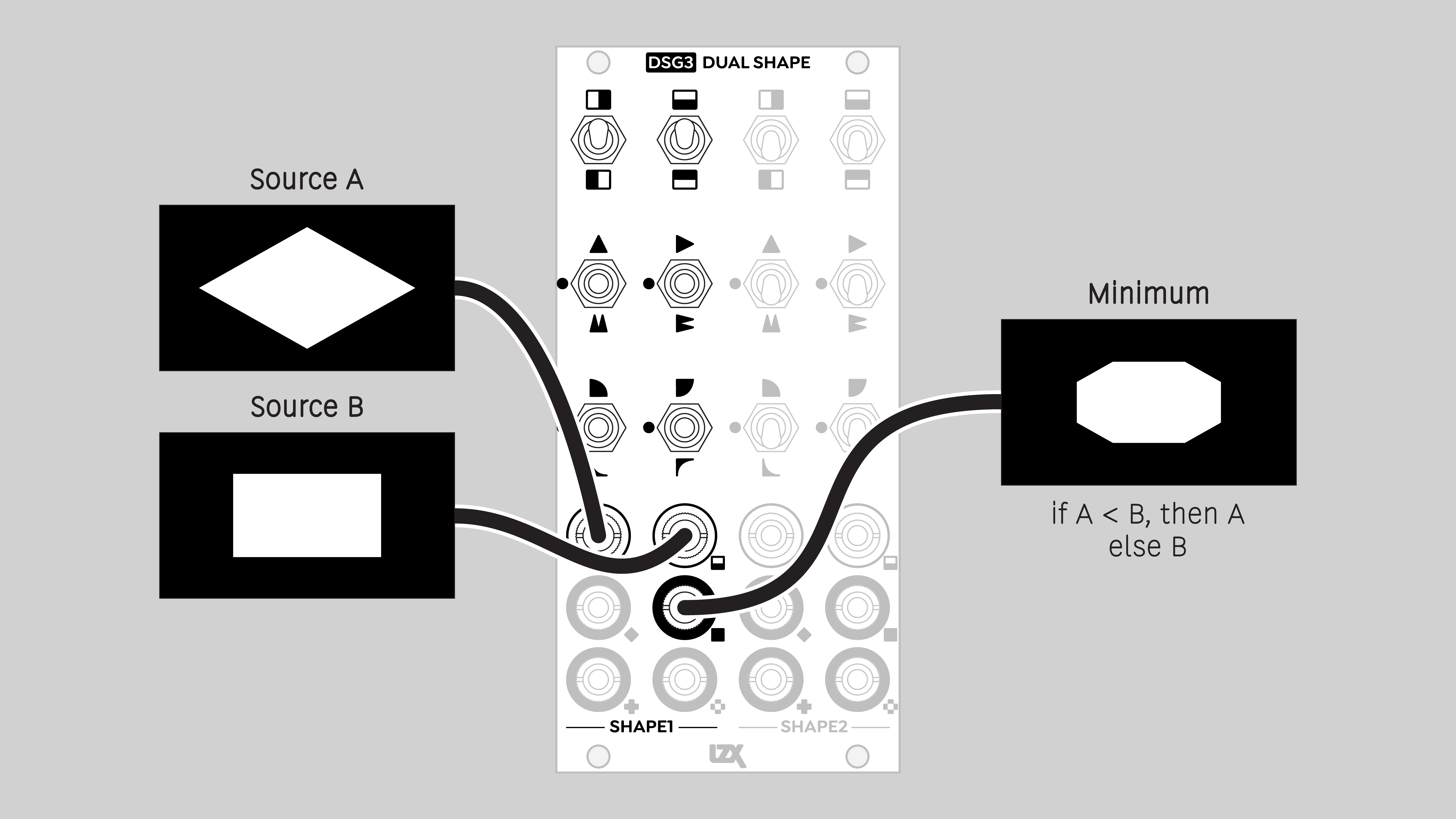

Minimum
The lower of two input values. Corresponds to a logical AND operation.
An output value can only be high if H and V inputs are high.
\$\min\{H, V\}\$
\$\text{If } H < V, \text{ then } H, \text{ else } V\$
\$(\;H + V - \lvert H - V \rvert\;)\;/\;2\$
Blend mode: Minimum
DSG3 Minimum output

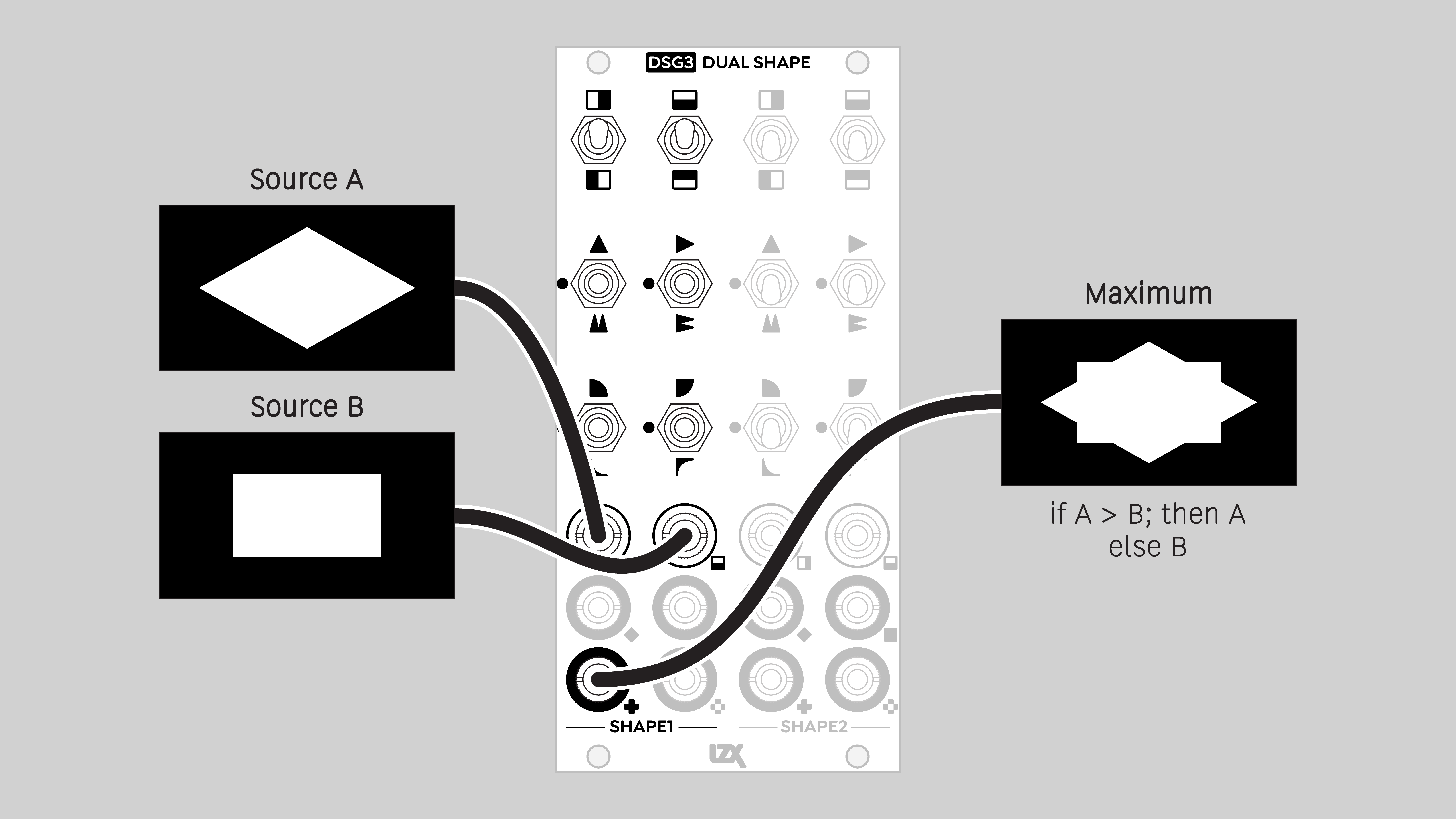

Maximum
The higher of two input values. Corresponds to a logical OR operation.
An output value will be high if either H or V inputs is high.
\$\max\{H, V\}\$
\$\text{If } H > V, \text{ then } H, \text{ else } V\$
\$(\;H + V + \lvert H - V \rvert\;)\;/\;2\$
Blend mode: Maximum

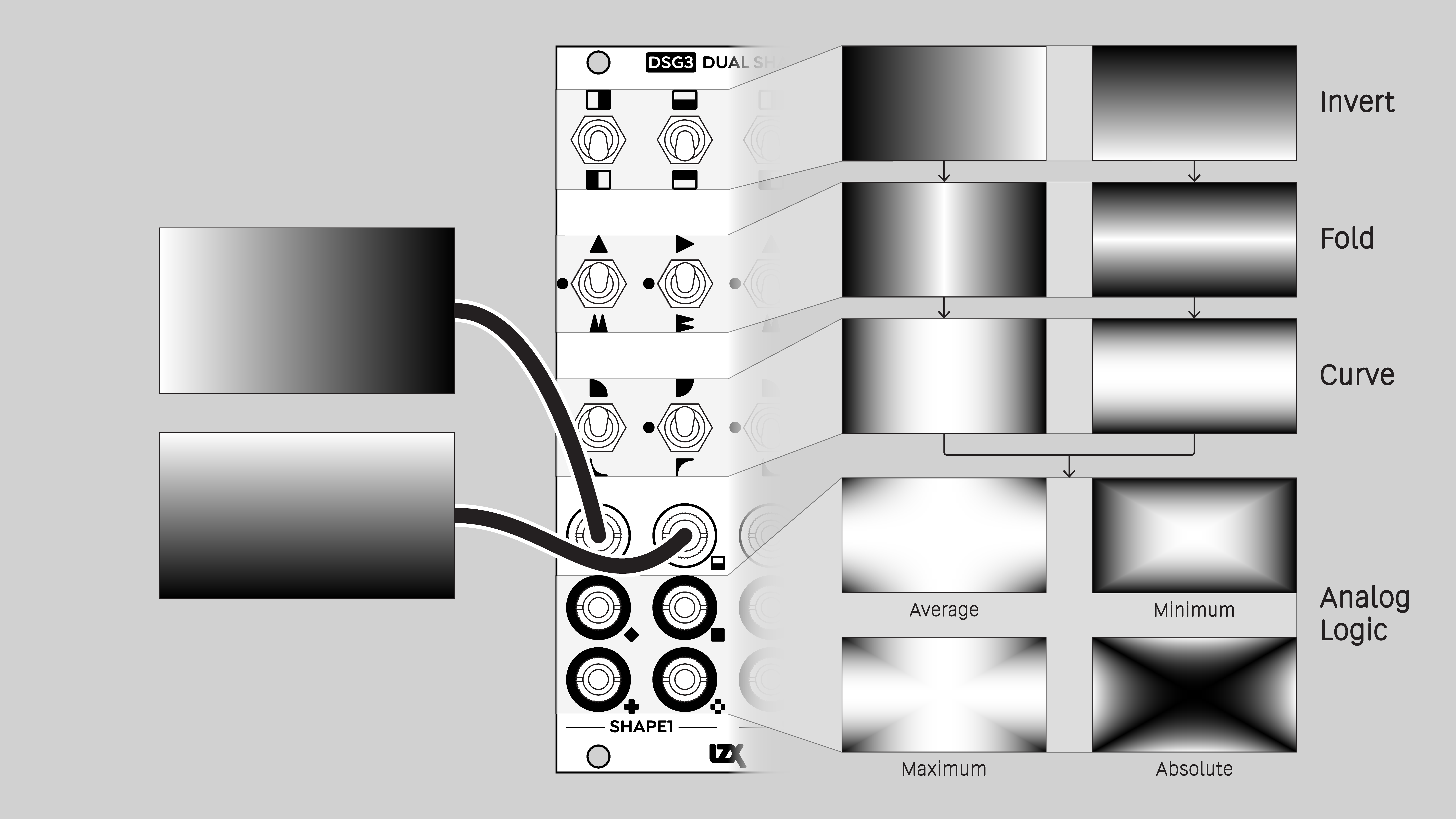

Functions
DSG3 example signal path

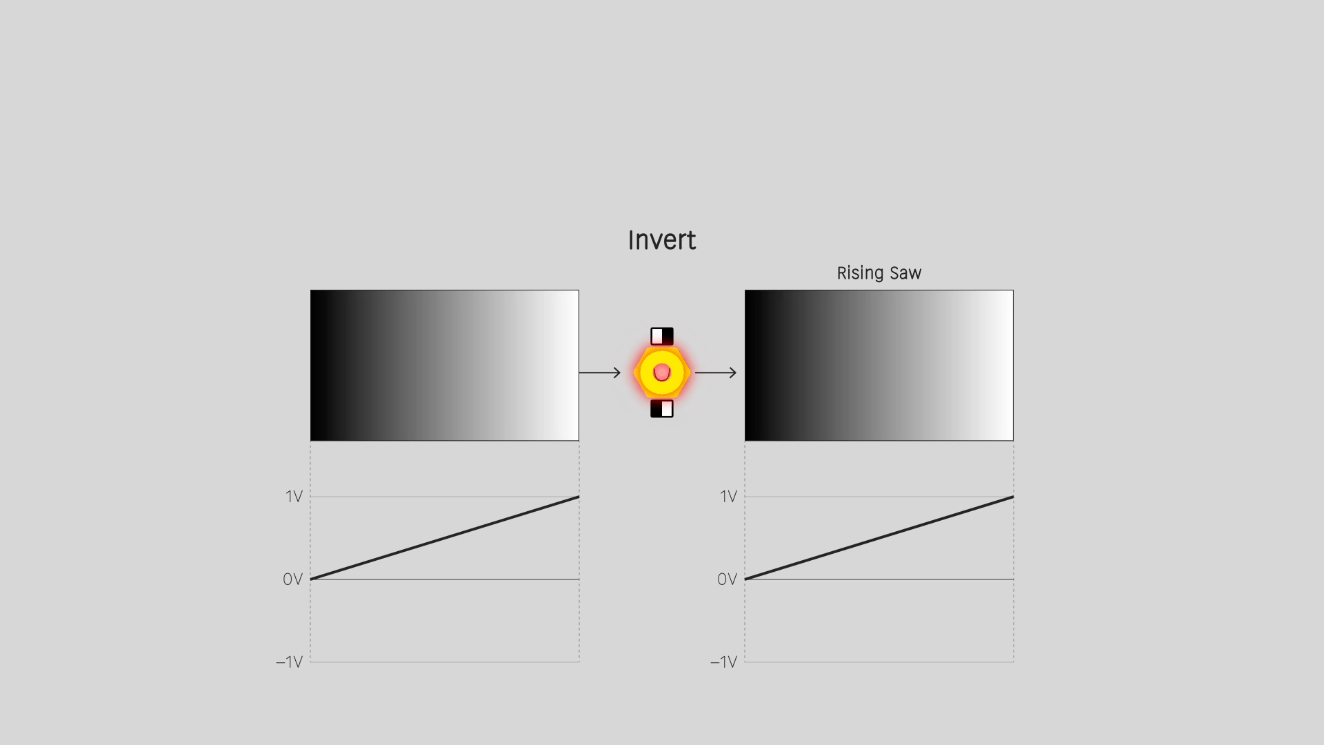

Invert
Reverse the input values. An input range from 0 to 1 gives an output range from 1 to 0. For a video image, this is a photo negative effect.
DSG3 Invert

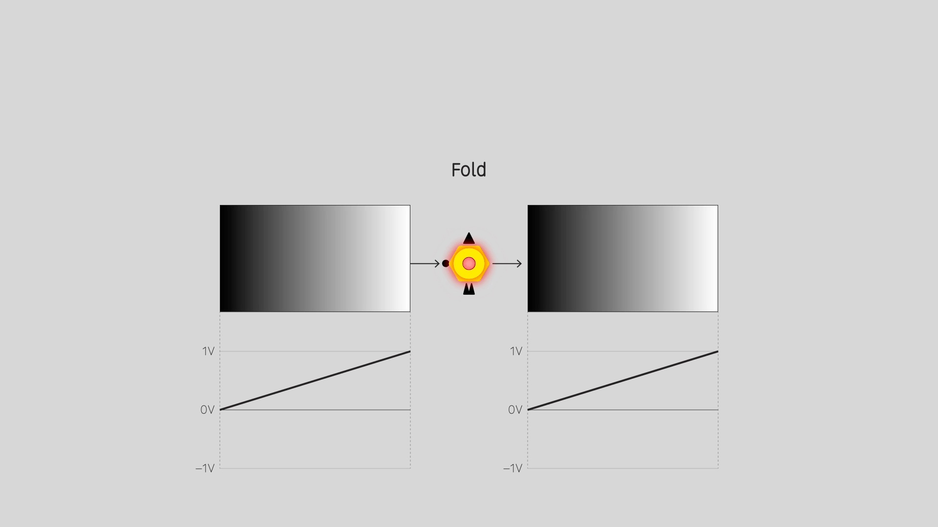

Fold
Precision full-wave rectification. Convert ramps/sawtooths to triangle waves. Double or quadruple the frequency of oscillators. Apply solarization and color cycling effects to images.
Fold 1 doubles the frequency of the signal, Fold 2 multiplies it by four.
DSG3 Fold

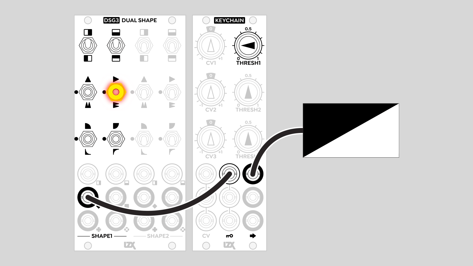

Hard-edged figures with a key generator / comparator
DSG3 example patch: Keychain

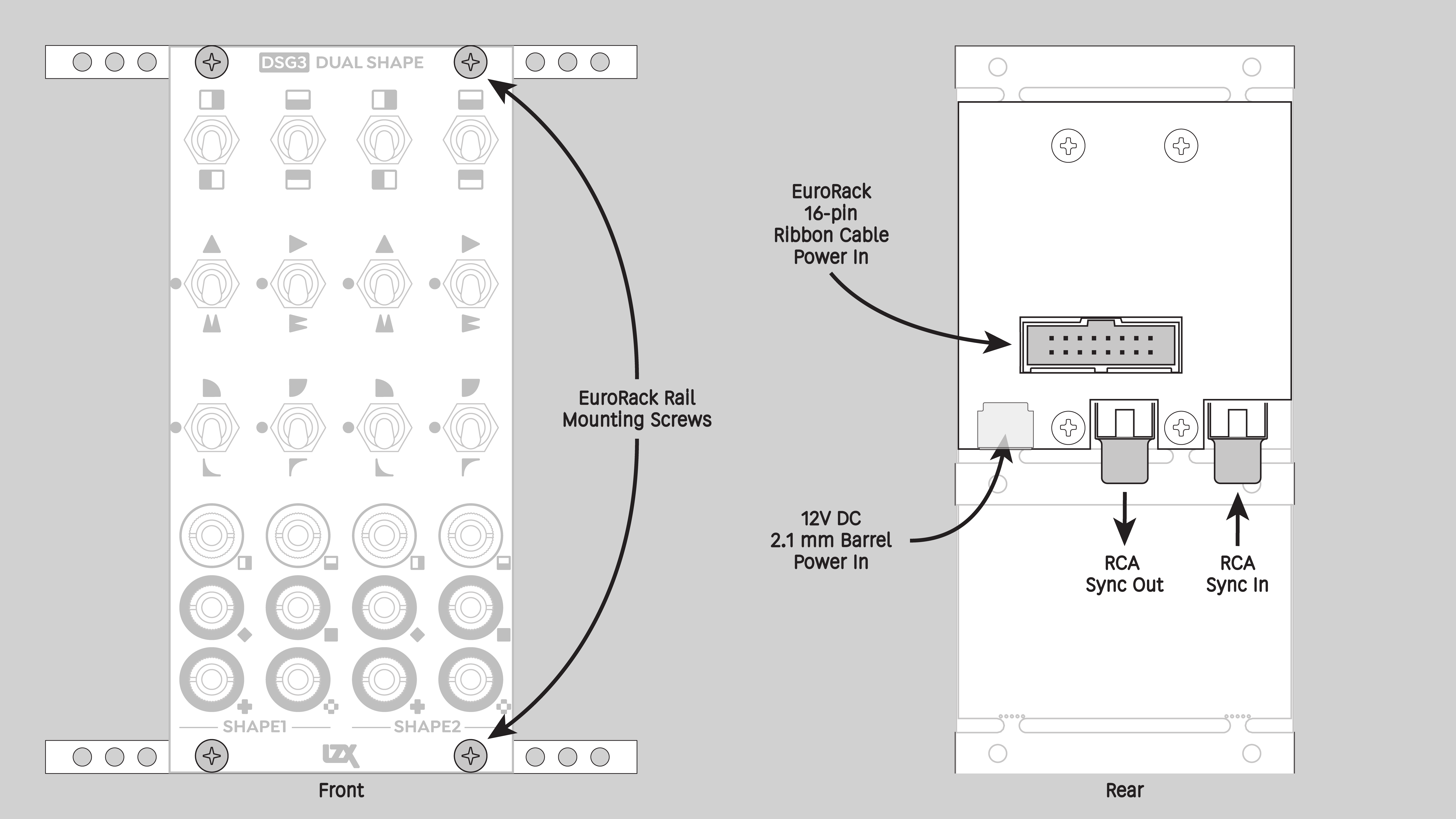

Installation
DSG3 installation
Requirements
  • EuroRack enclosure
Procedure

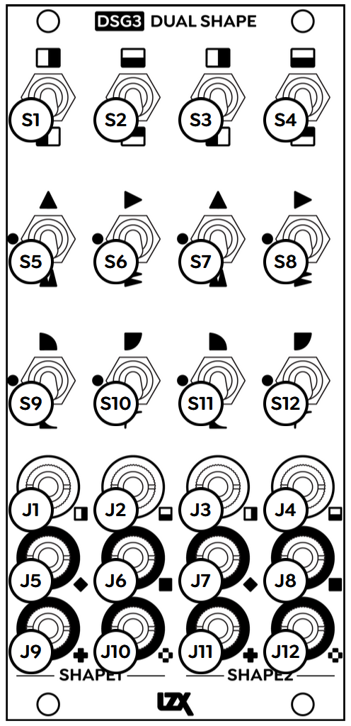

DSG3: labeled front panel controls
Jack Function
J1
Shape 1 H in
J2
Shape 1 V in
J3
Shape 2 H in
J4
Shape 2 V in
J5
Shape 1 Average
J6
Shape 1 Minimum
J7
Shape 2 Average
J8
Shape 2 Minimum
J9
Shape 1 Maximum
J10
Shape 1 Absolute
J11
Shape 2 Maximum
J12
Shape 2 Absolute
Switch Function
S1
Shape 1 H Invert
S2
Shape 1 V Invert
S3
Shape 2 H Invert
S4
Shape 2 V Invert
S5
Shape 1 H Fold
S6
Shape 1 V Fold
S7
Shape 2 H Fold
S8
Shape 2 V Fold
S9
Shape 1 H Curve
S10
Shape 1 V Curve
S11
Shape 2 H Curve
S12
Shape 2 V Curve
