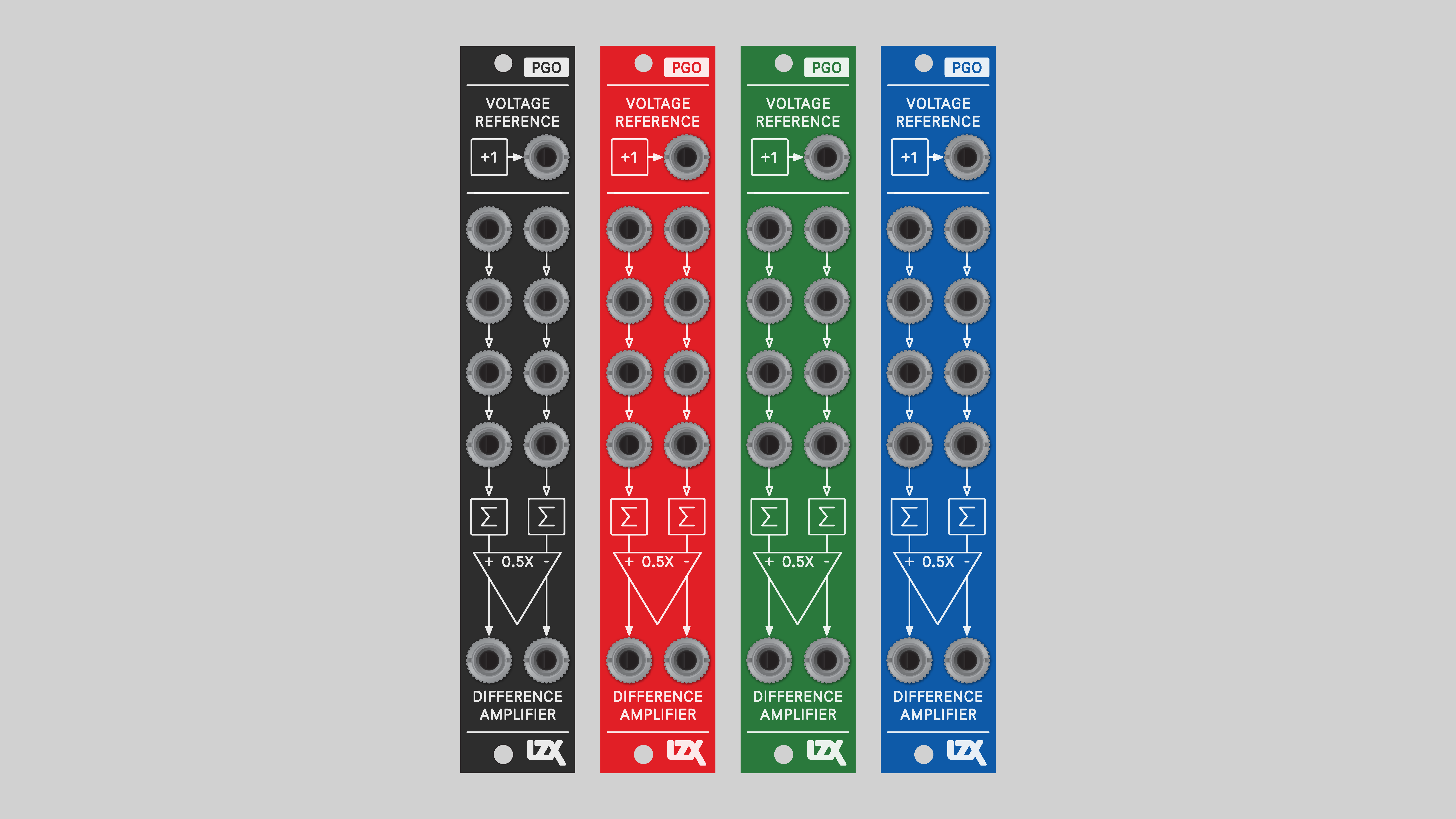

Front Panel Options
PGO ships with a black front panel installed. Red, green and blue panels are also included.
All PGO front panels
All front panels are printed on both sides, allowing a choice of top-to-bottom or bottom-to-top signal flow. This gives great flexibility in designing modular systems.

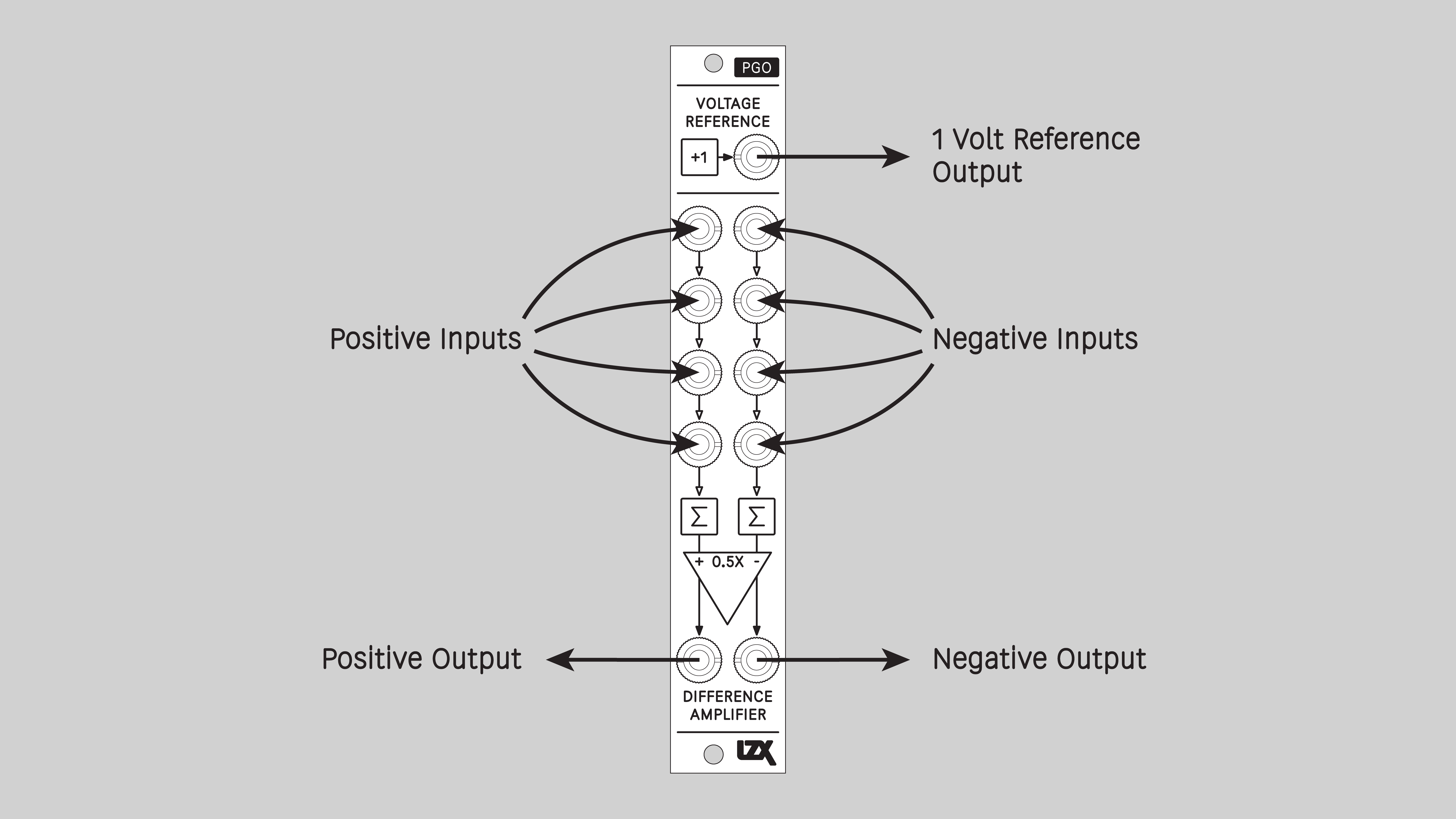

Controls Connectors And Indicators

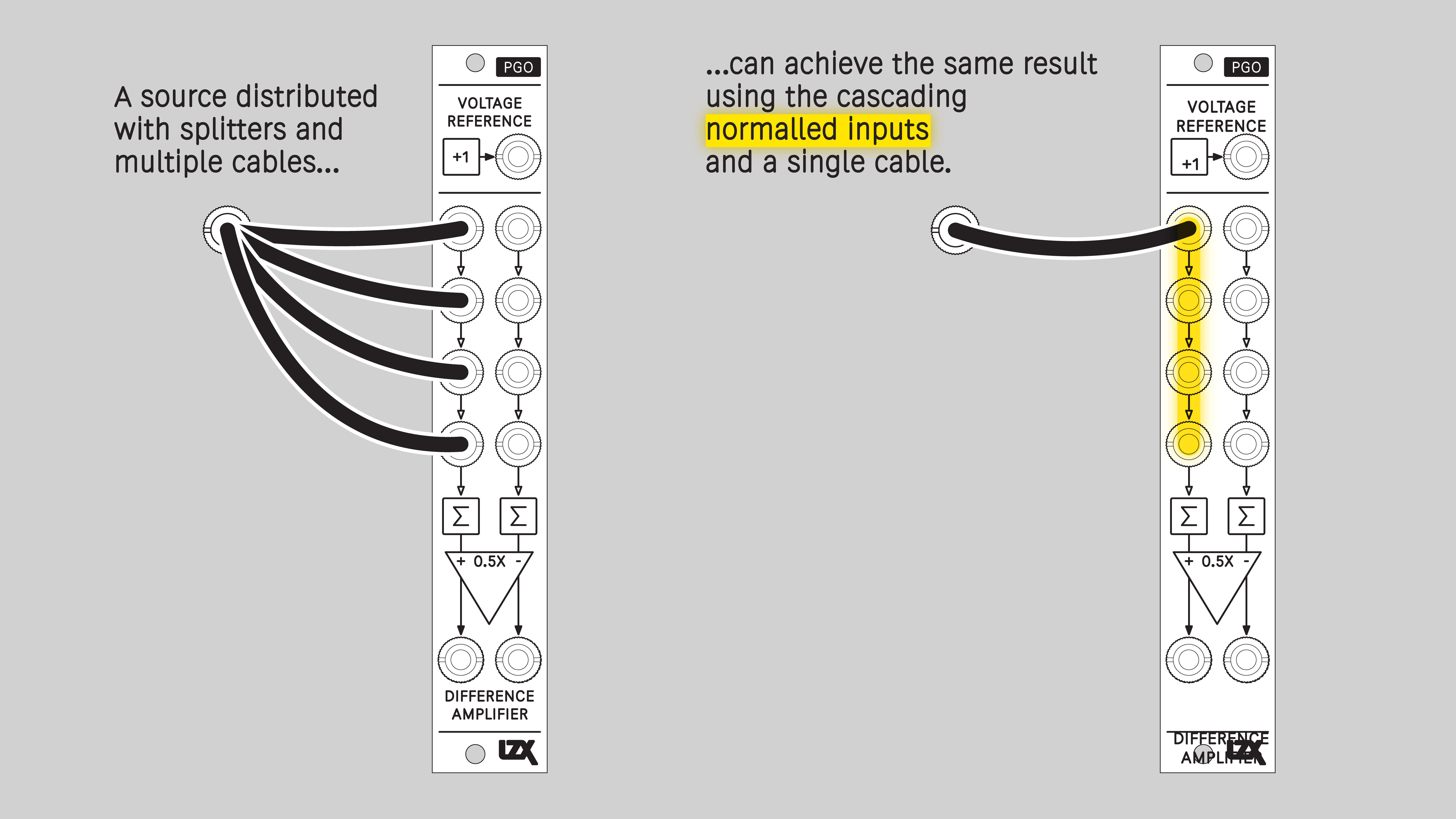

Understanding Cascading Input Jacks
PGO uses switched, or normalled, connections between some of its input jacks. With no cable inserted, a signal flows from one input jack to another. This connection is overridden when a cable is inserted. Normalled inputs are indicated on the front panel with arrows.
Normalled Connections

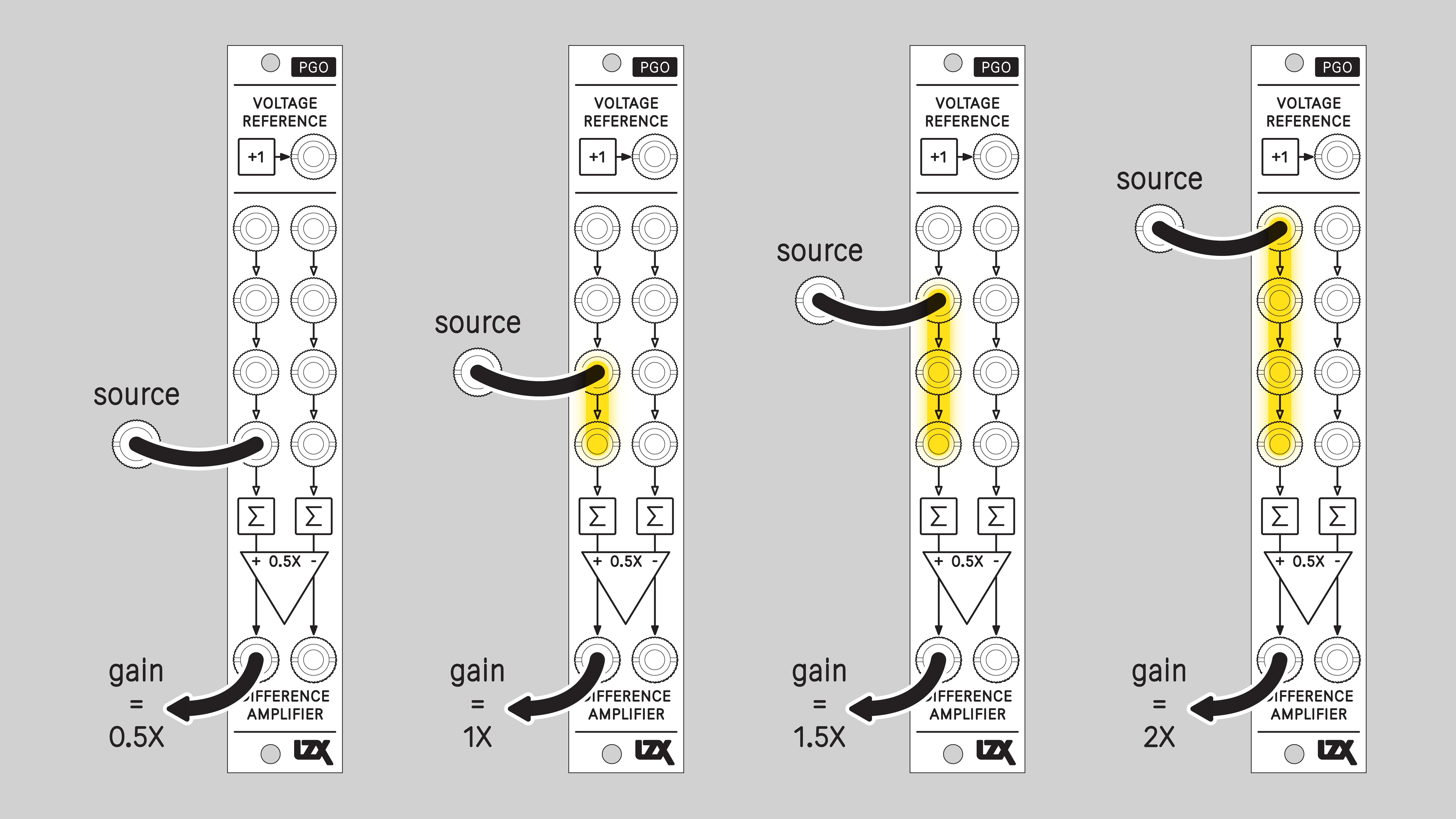

Programming Gain

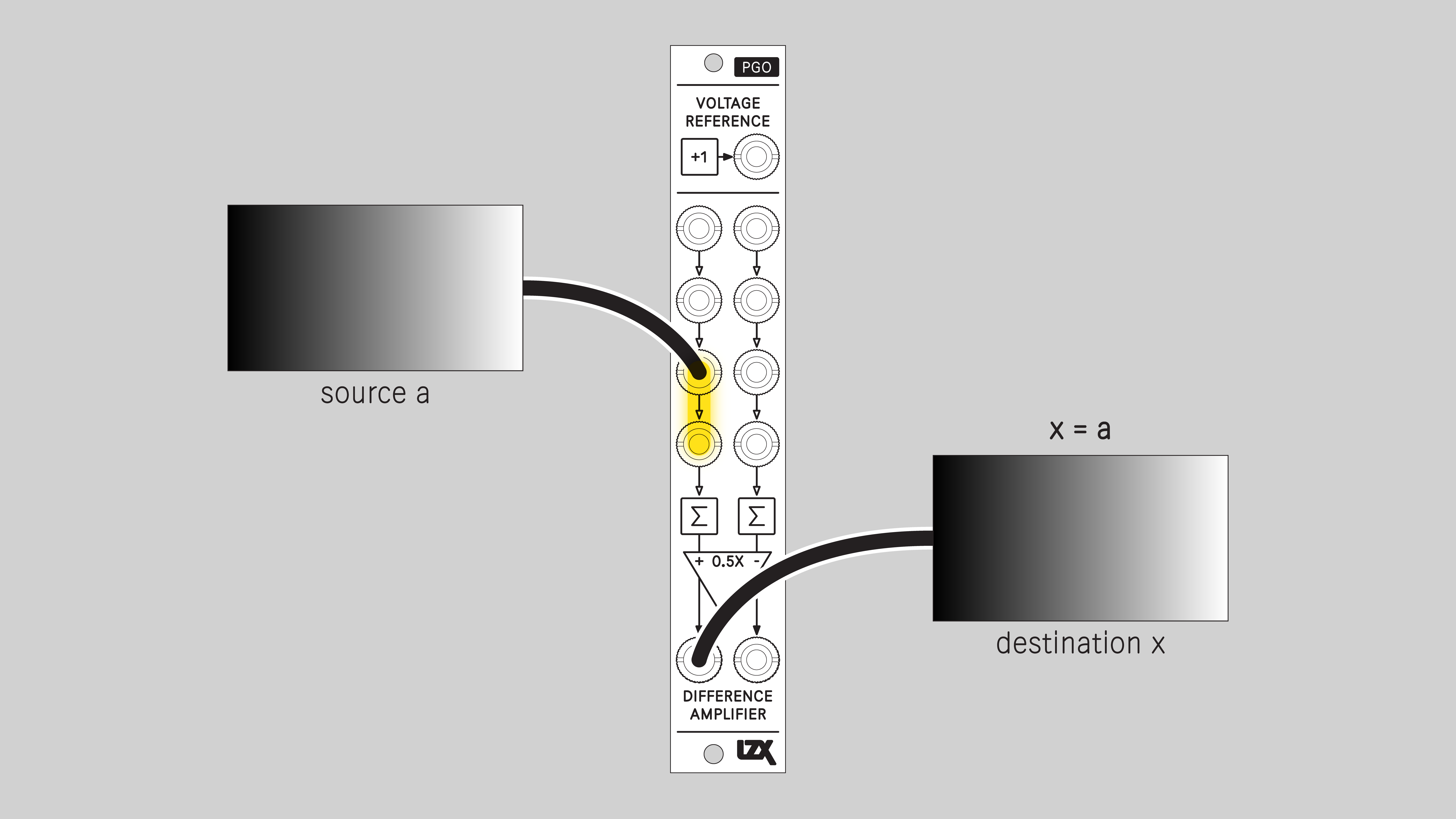

Buffer
Buffer the input signal with a unity gain of 1.0. Due to the module’s propagation delay, it can be used to add slight delays in the video processing path, resulting in the picture shifting slightly to the right.
Buffer

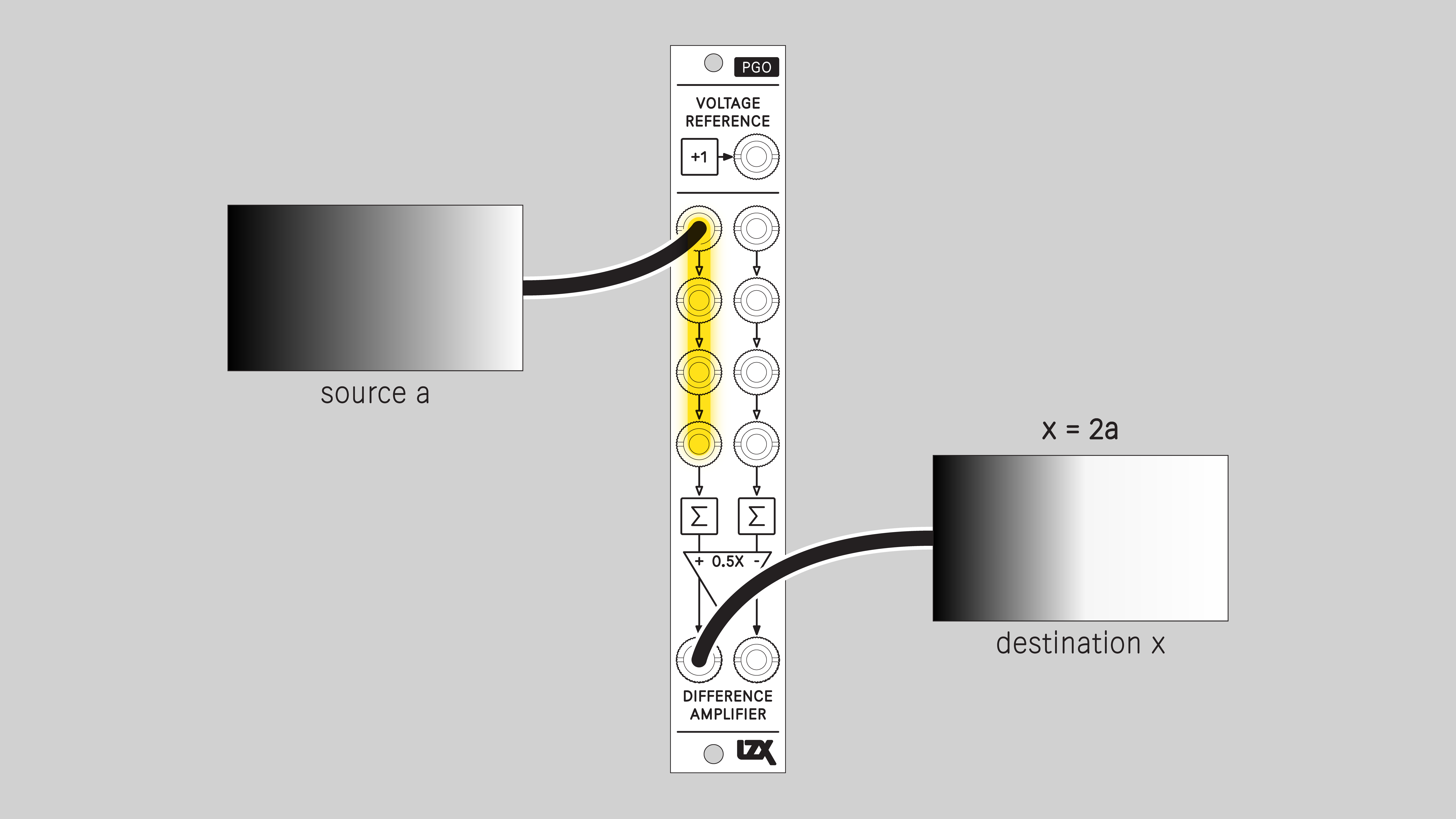

Amplifiy
Amplify the input signal with a gain of 2.
Amplifier

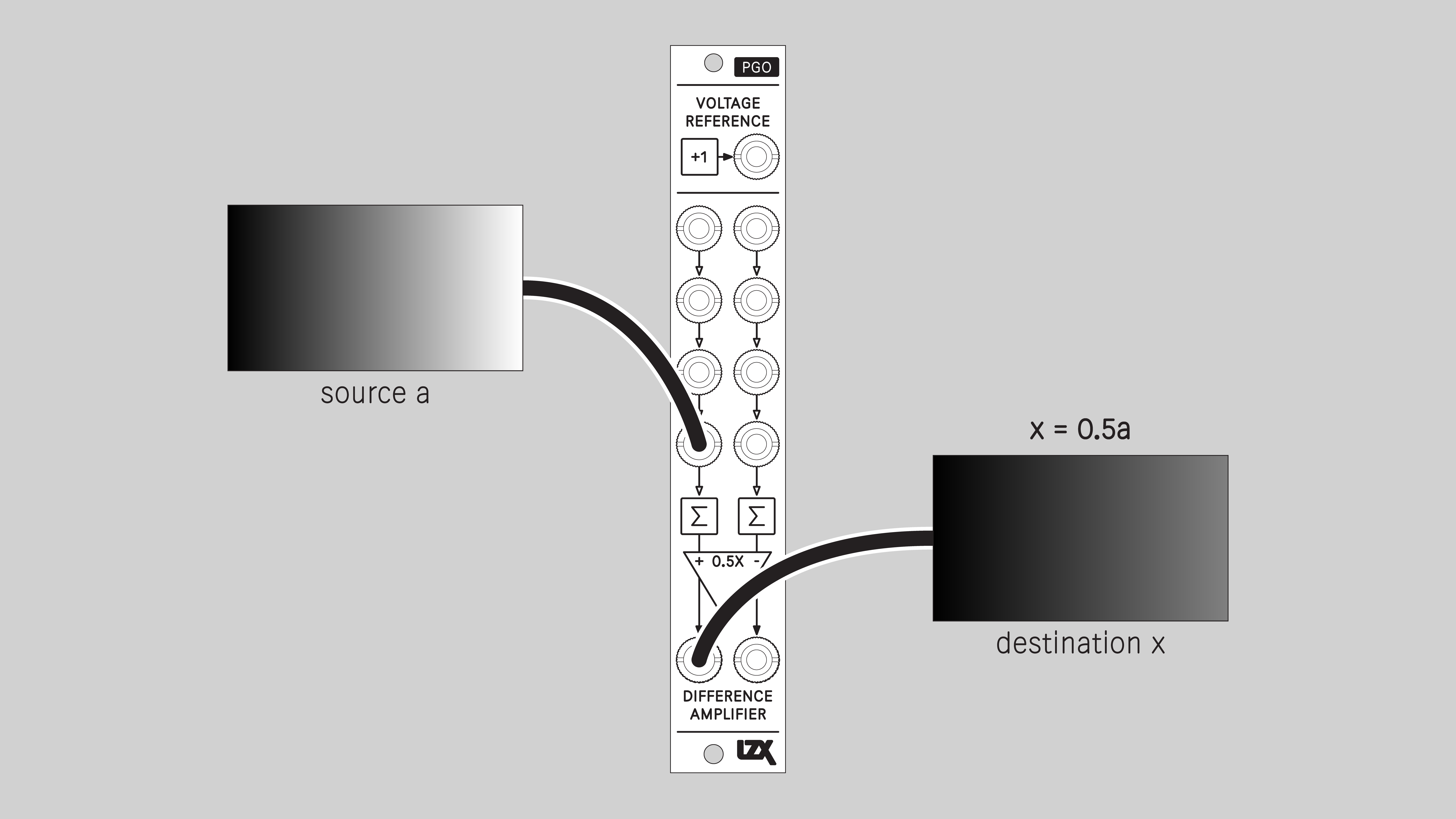

Attenuate
Attenuate the input signal with a gain of 0.5.
Attenuator

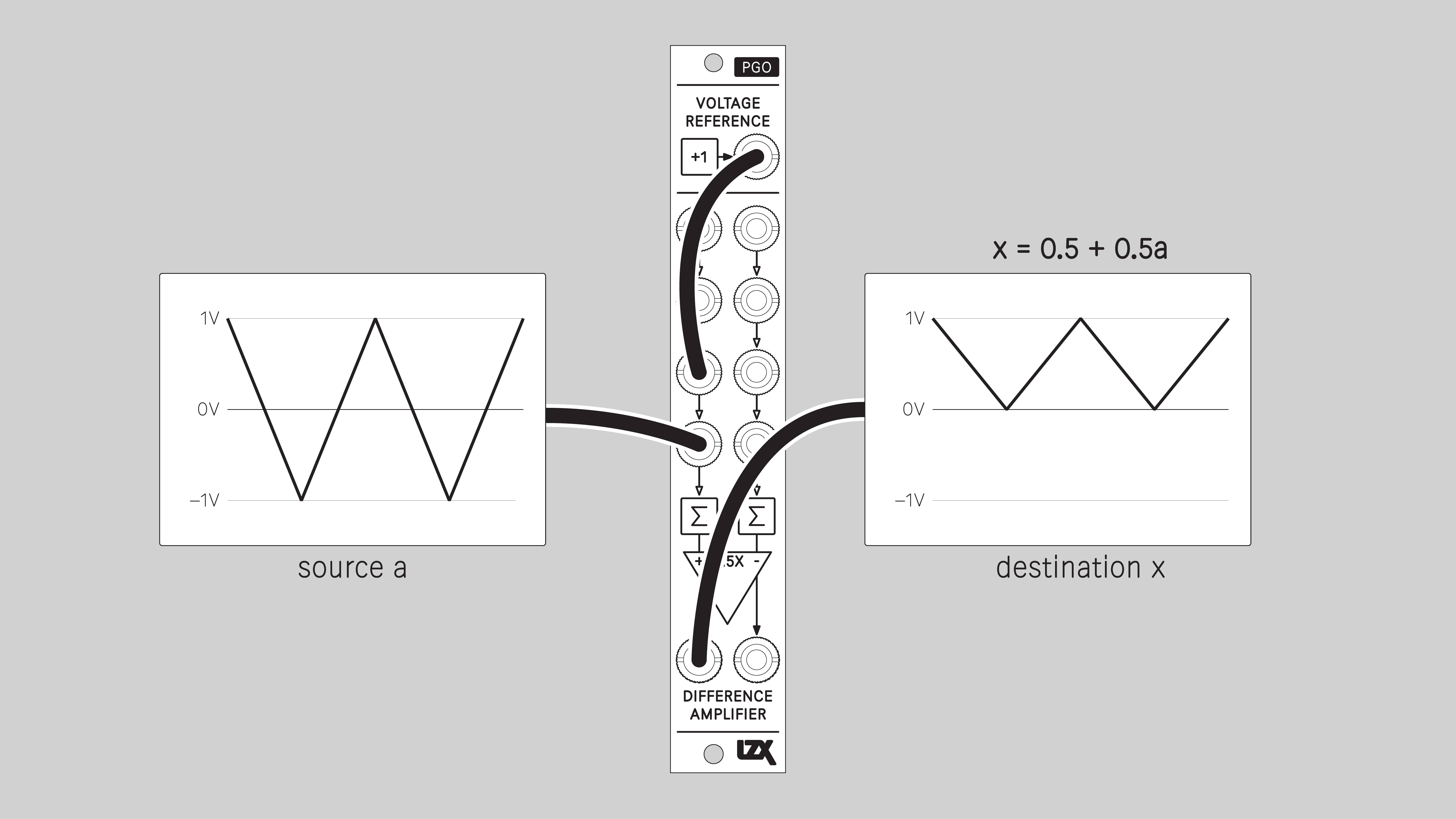

Invert
Invert the arithmetic sign of the input signal. Positive voltages are converted to negative voltages, or vice versa.
Inverter

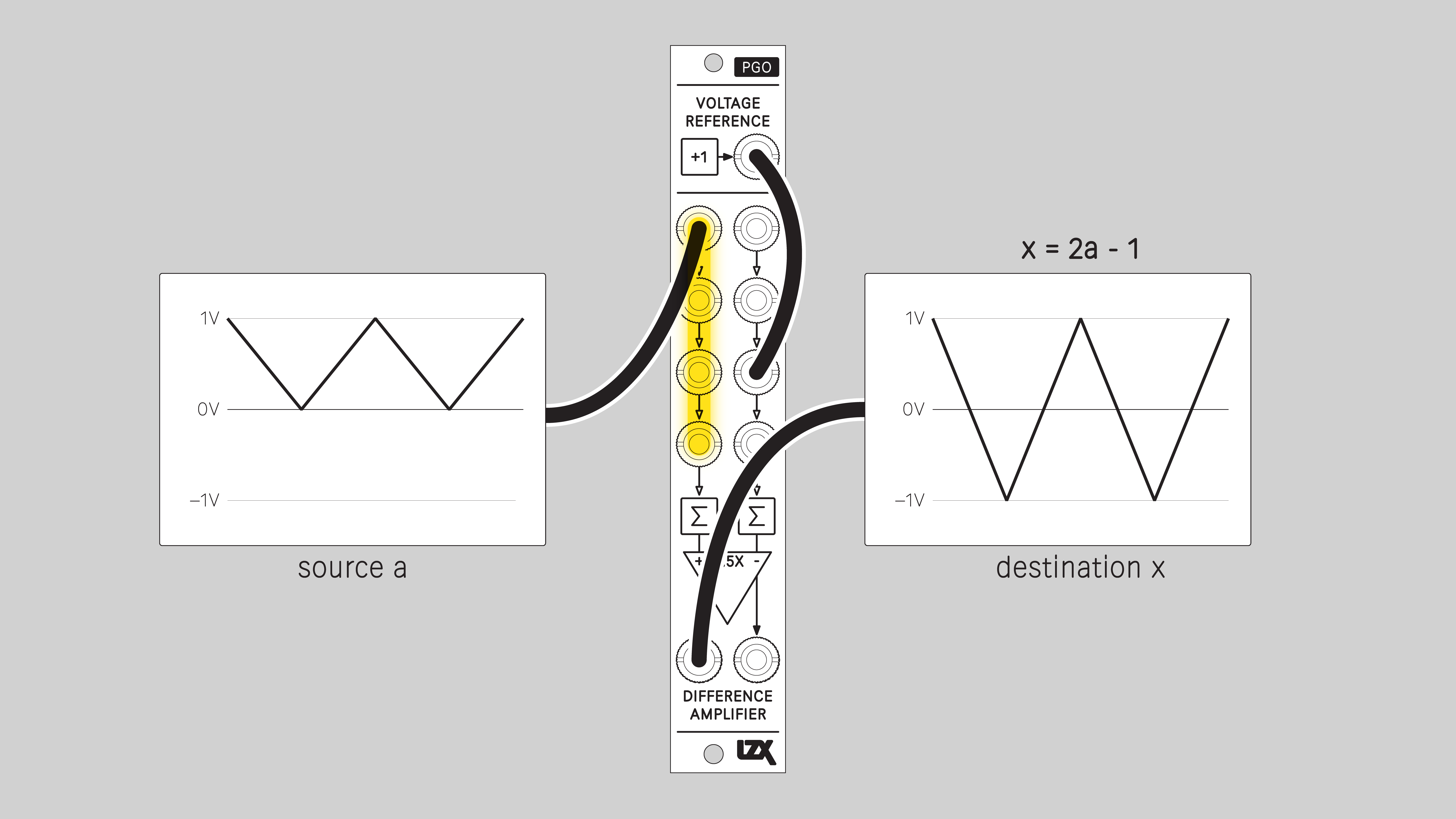

Negative
Convert a unipolar signal to negative by subtracting it from 1V. Useful for inverting keys, logic and RGB channels. An input signal ranging from zero to one results in an inverted output ranging from one to zero.
Negative

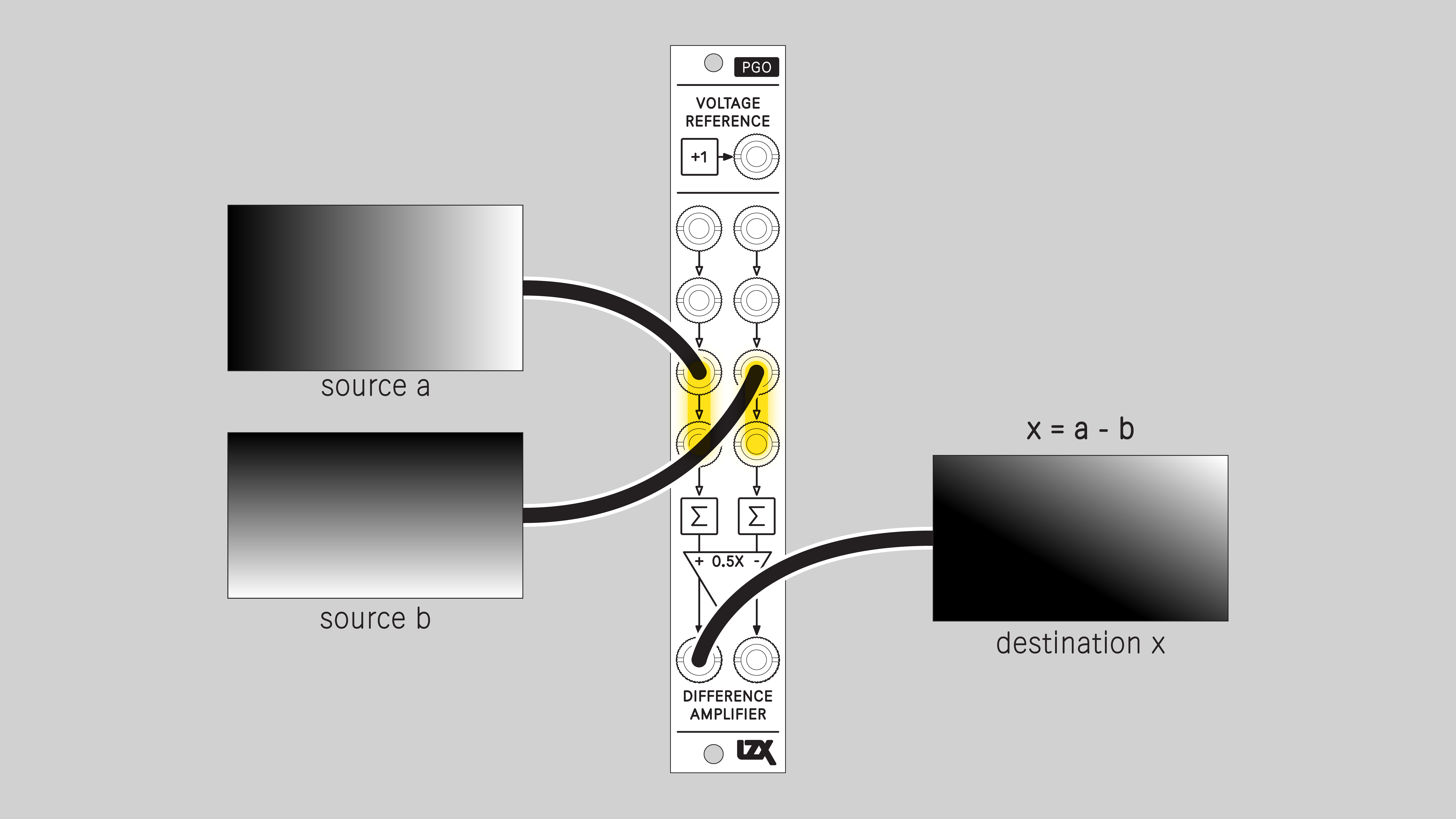

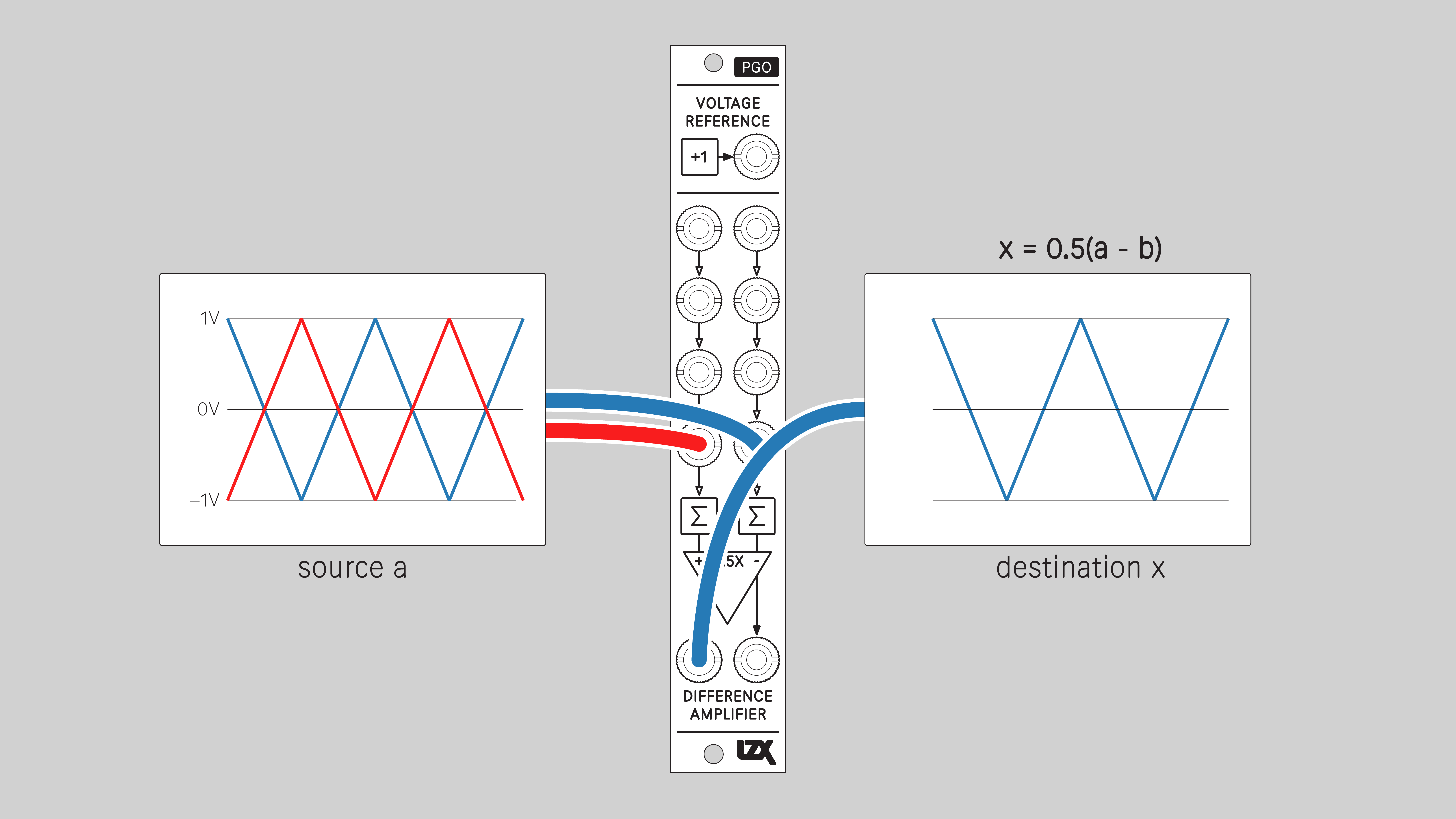

Subtract
Subtract one input from another.
Subtractor

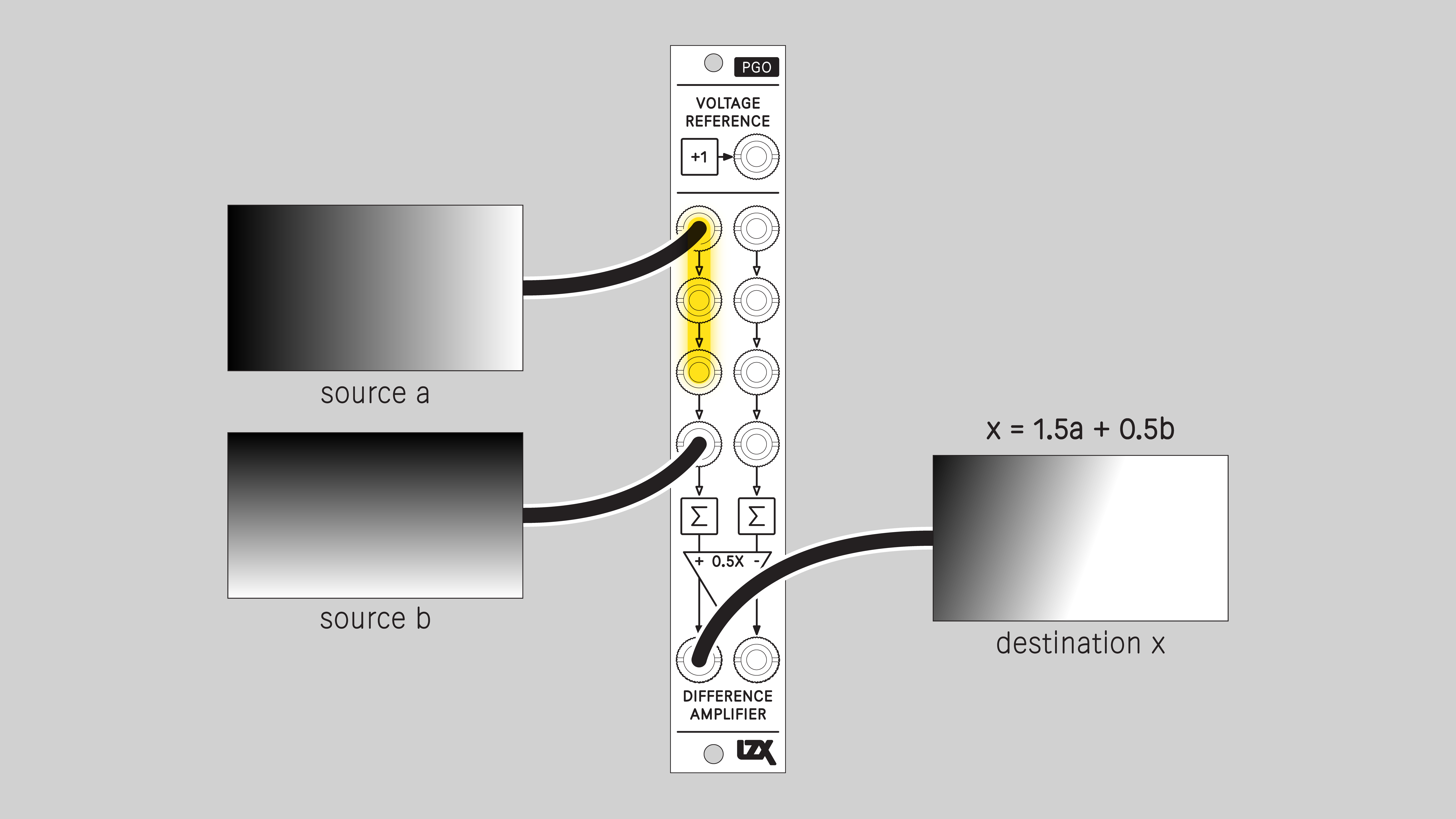

Unipolar Modulation
Subtract a modulator from a primary signal, where both are unipolar, from zero to +1V. The primary signal source a passes unmodified when the modulating signal source b is at its midpoint of 0.5V. As a ramp shifter, source a is the input ramp, and source b is the positioning control voltage. As a brightness processor, source a is a unipolar color channel such as luma, red, green, or blue, and source b is the brightness adjustment.
Unipolar Modulator
Weighted Mixer
Calculate a 3:1 weighted sum of two inputs, with 3 parts of source a for every 1 part of source b.
Weighted Mixer
Compressed Mixer
Calculate the sum of four input signals and attenuate the mix to a value of one half. This is a common scenario to prevent clipping when mixing more than two input signals.
Compressed Mixer

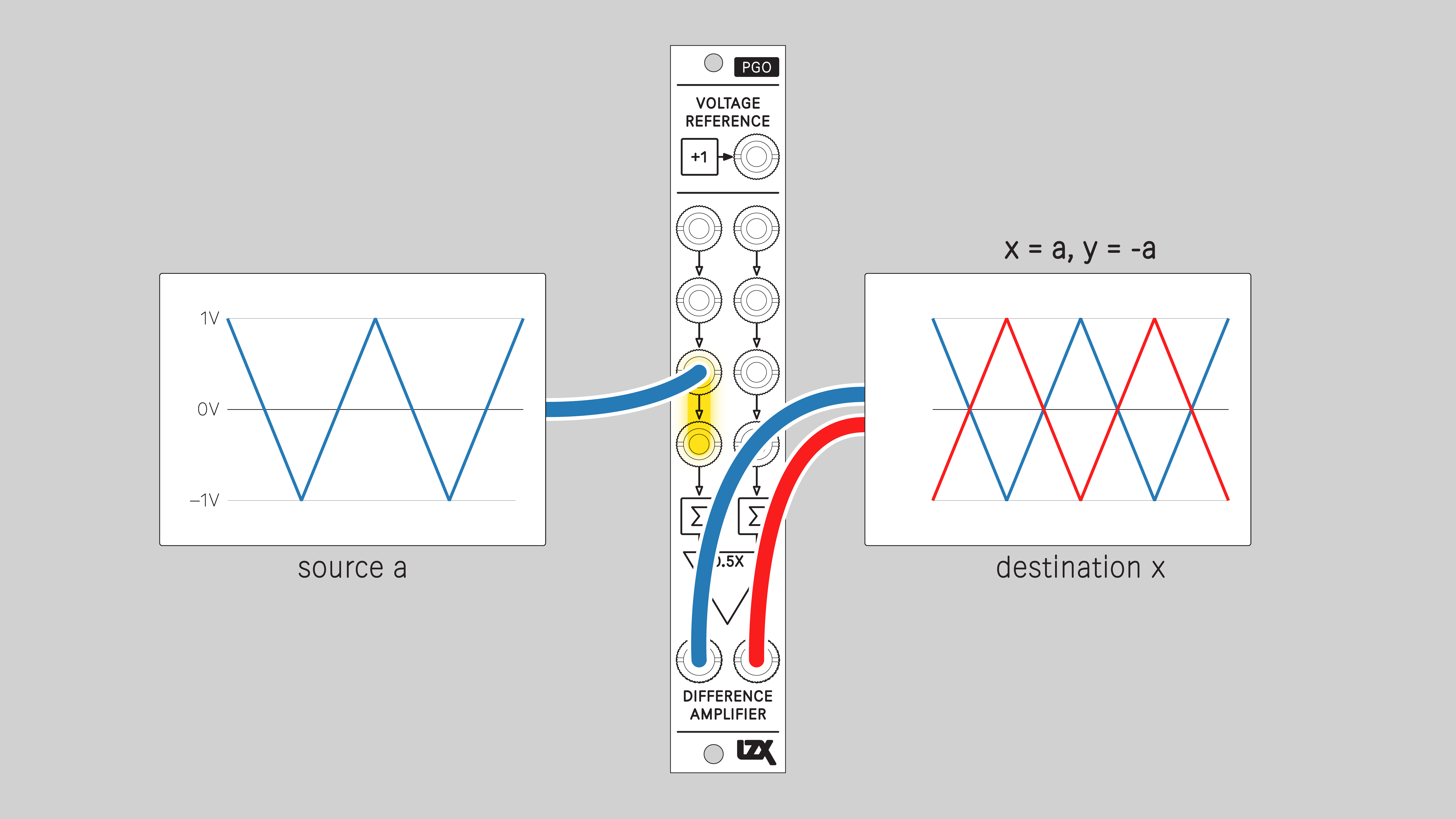

AFR note: suggest revising these illustrations.
Differential to Single-ended should have two separate input frames, one for each signal. Right now the two inputs are superimposed in the same frame. This is confusing.
Likewise with Single-ended to differential, it should have two separate output frames, one for each signal.
Convert a differential input signal to a single-ended output signal. In a differential signal, information is encoded as the difference between a matched pair of separate signals. For example, balanced audio rejects noise on cable runs by sending both a positive and a phase-inverted negative signal on two conductors. Video chroma can be encoded as the difference between two color primaries, such as Pb and Pr, or I and Q.
Differential To Single Ended
Single-ended to Differential
Convert a single-ended input signal to a differential output signal. One possible application of differential outputs on PGO would be positive and negative versions of the same signal, such as luminance keys. Both signals will have the same amount of propagation delay, allowing precise horizontal alignment of positive and negative masks.
Single Ended To Differential
